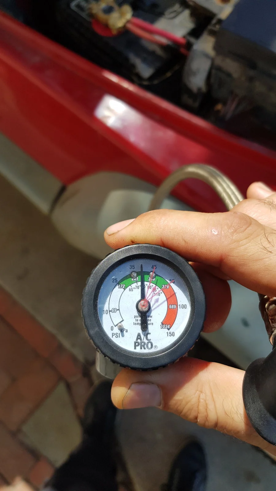

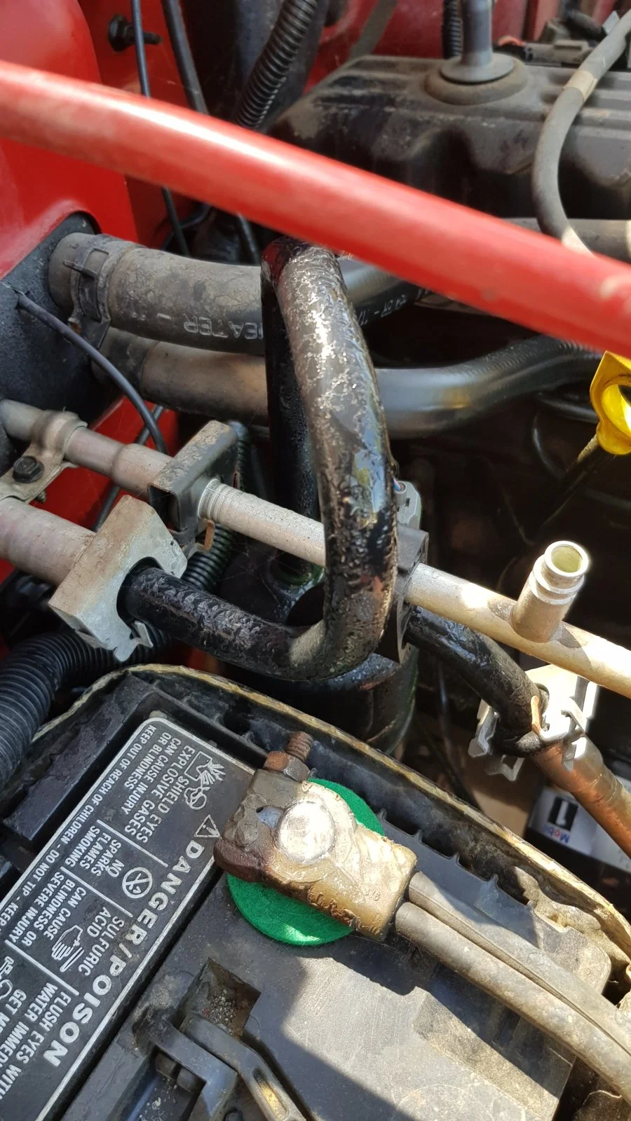

In the meantime here is what the A/C Pro gauge is showing now on the low side after running the AC for a few minutes.
Is this just condensation or coolant leaked as a result of overfilling?
Unfortunately it sounds like the compressor is locking up. This will cause a clutch to slip also. It’s possoble it’s just overcharged but it’s also possible that when you brought it up to proper charge the extra work the compressor was doing took over to the dark side.

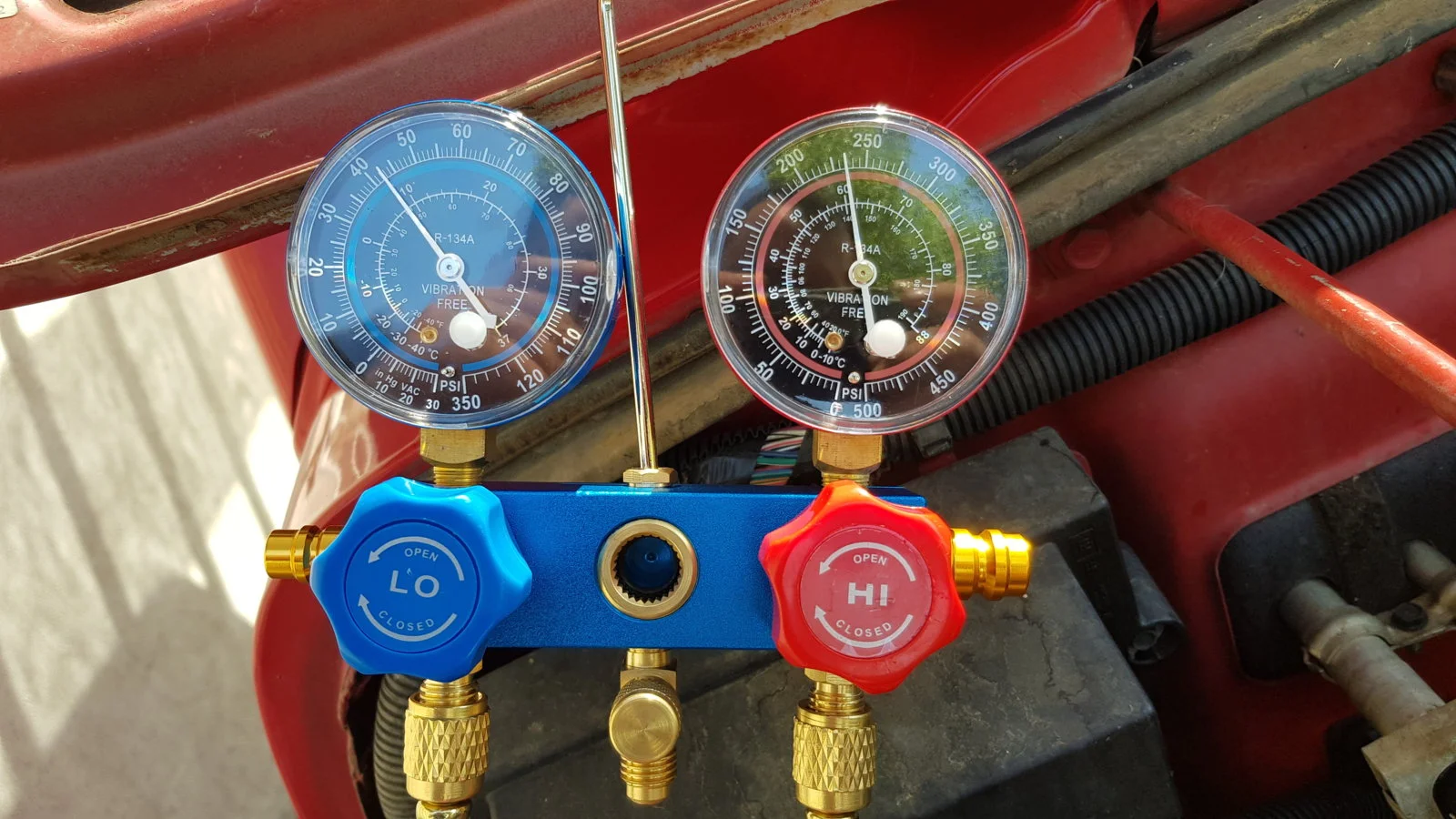

Ambient temperature is 84F. These are the results after running the AC for 5 minutes:
Low pressure: 42 PSI
High pressure: 235 PSI

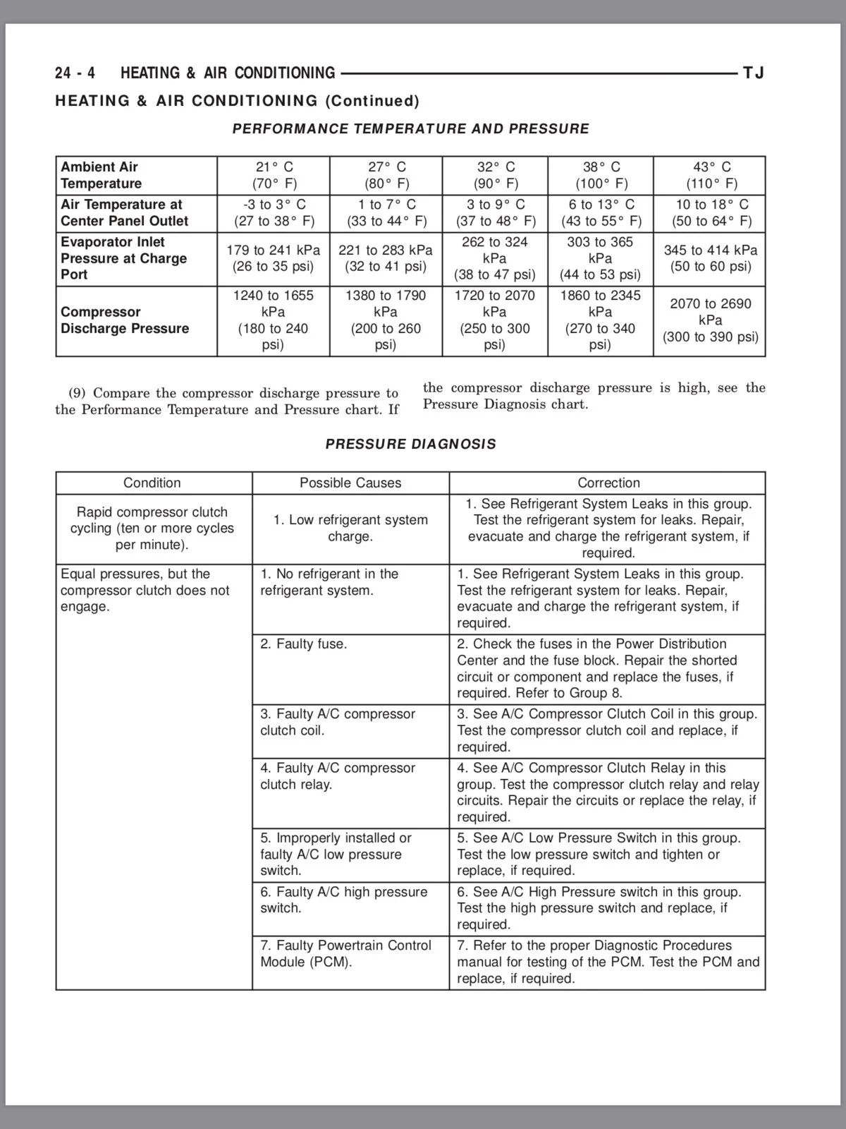

According to your posted numbers the high pressure is good, the low pressure in 1 PSI higher than maximum, should I let a little out?

No, don’t let any out. What is the air discharge temperature at your vent closest to the evaporator. Also, is the noise you were hearing earlier still there?
The pressure looks pretty good. You might be slightly overcharged since the ambient is pretty cool but not enough to cause your problems. Rev the engine to about 2000 and watch the pressure. The low side should drop to about 22 and the high will probably be about 260. Watch the needles. They should hold pretty steady. A jumpy needle means bad compressor. You might have to watch it for a while until you see the problem if it’s a clutch.
The low side at engine start and a minute into it was about 45, stayed at 45 though higher RPM. The high side was 240, but went up to 300.
