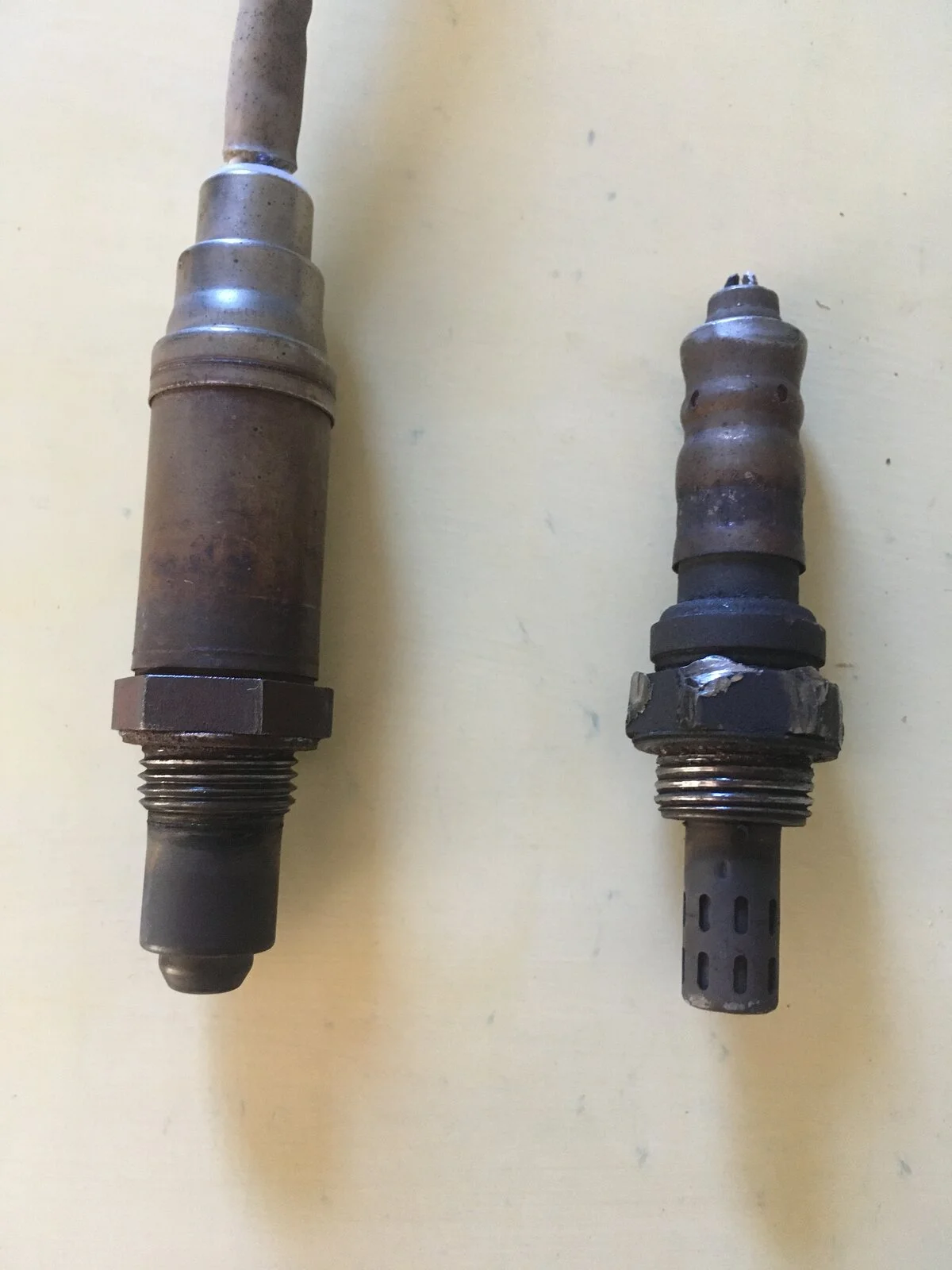

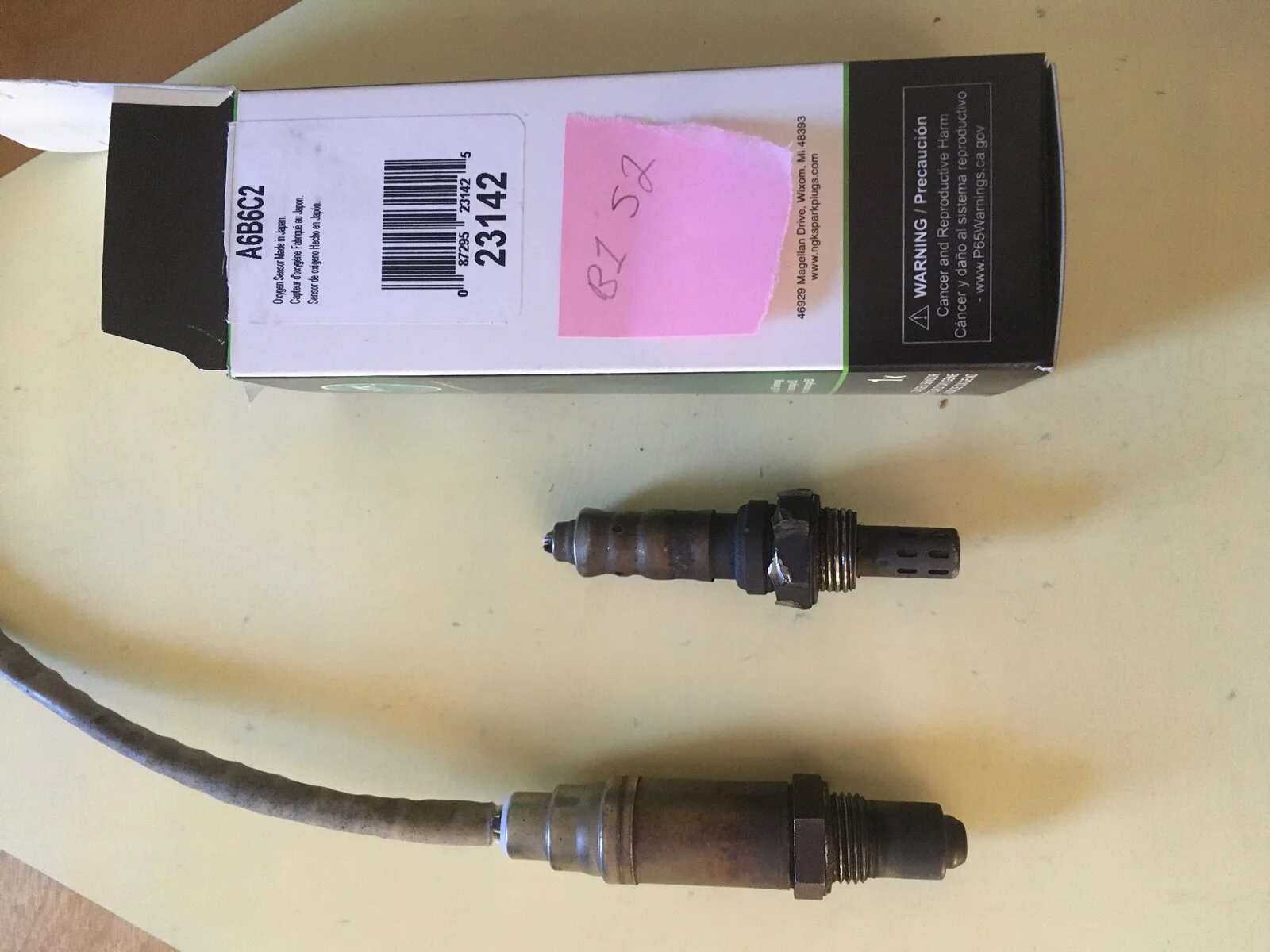

I changed out the O2 sensors down stream and I bought NTK sensors as replacements. But the one sensor I had in there originally is different from the one I got in the mail. The sensor that was in there is a Bosch, for the Bank1 Sensor2 and looks bigger and different. The one from NTK 23142 is smaller. My question is, the NTK 23142 is it the right one or do I need to go buy the Bosch O2 sensor. It’s for my 2003 Jeep Wrangler Sahara 4.0 it takes 4 sensors. The 2 up stream are good. Thank you kindly

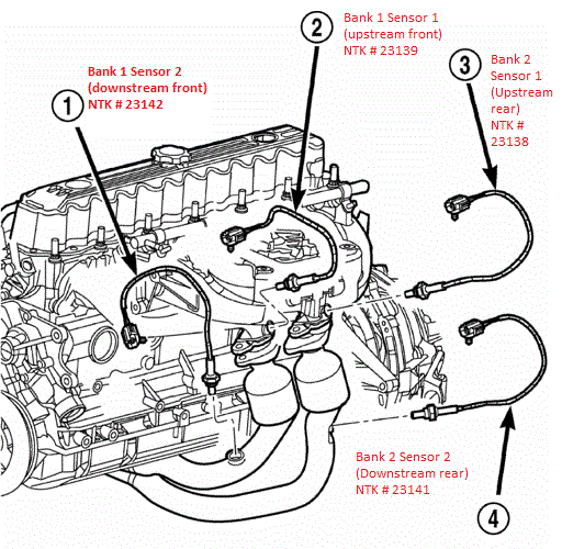

NTK's 23142 is the correct downstream O2 sensor for cylinders 1-3. NTK 23141 is the correct downstream sensor for cylinders 4-6.
Bosch is not the correct sensor even though some guides say it is. It's set up for a different bias voltage than what the TJ provides.
