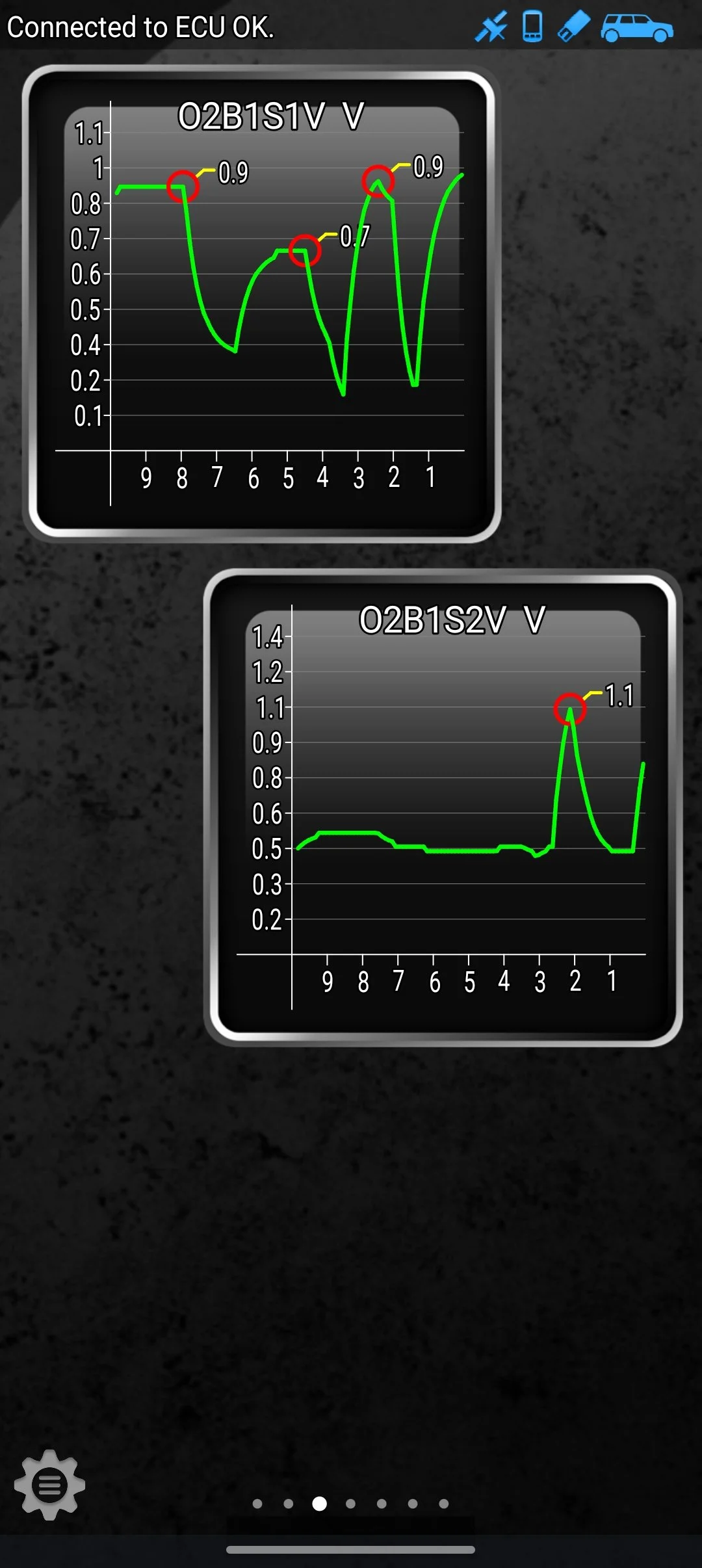

Do you have the ability to read live ODB data? A $30 Bluetooth ODB dongle and the free Torque Lite app will do it. You want to monitor the voltages of the O2 sensors and they should be trending below.9v.
-Mac

I'd definitely be checking live ODB data and monitoring voltage. Should range below .9v.
Might want to check wiring and expose some of your loom.
-Mac
