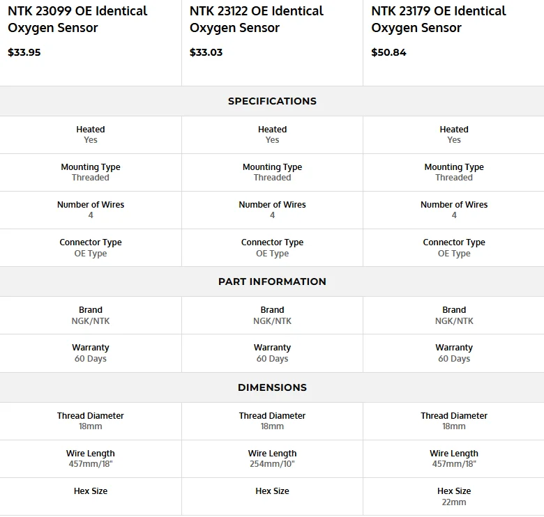

The OEM Mopar numbers listed on RockAuto cross referenced to NTK and then to Walker all come back as the same actual sensor with differing wire lengths. So in most (if not all) circumstances the sensor with the longer wire will work for both up stream and down stream positions.

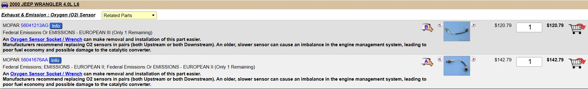

Here are the OEM numbers

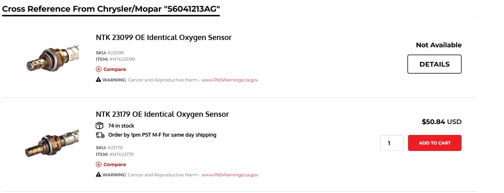

56041213AG cross references to 2 NTK numbers

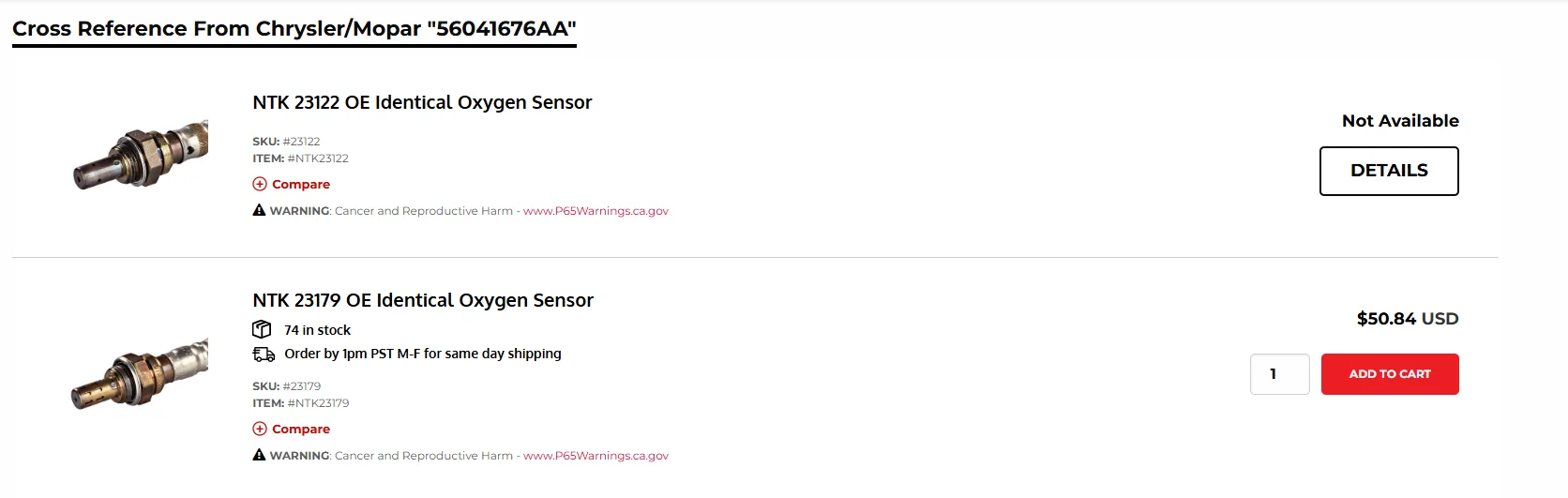

and 56041676AA crosses to
Notice that BOTH OEM Mopar numbers eventually cross to the same number NTK 23179 which crosses to a Walker 250-24942.
You can use the 250-24942 in both upstream and downstream positions.
Here's how the 3 compare.

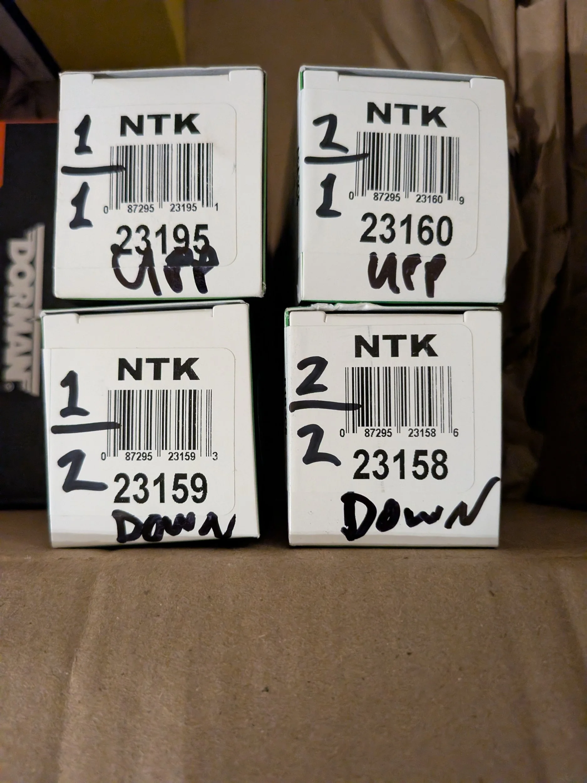

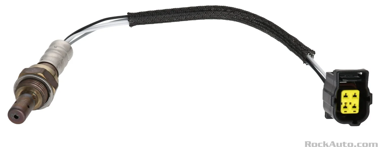

- NTK 23160 (upstream, cyl. 4-6, bank 2 / sensor 1)
- NTK 23195 (upstream, cyl. 1-3, bank 1 / sensor 1) - this is the "newer" version of NTK 23018, the only one offered from RockAuto.
I can't find a good reason for why it would be a problem but it makes my brain itch that they've superseded the 23018 with the "improved" 23195 which differs significantly in appearance where the exhaust gases surround the sensing element, but left bank 2 with the old design 23160.

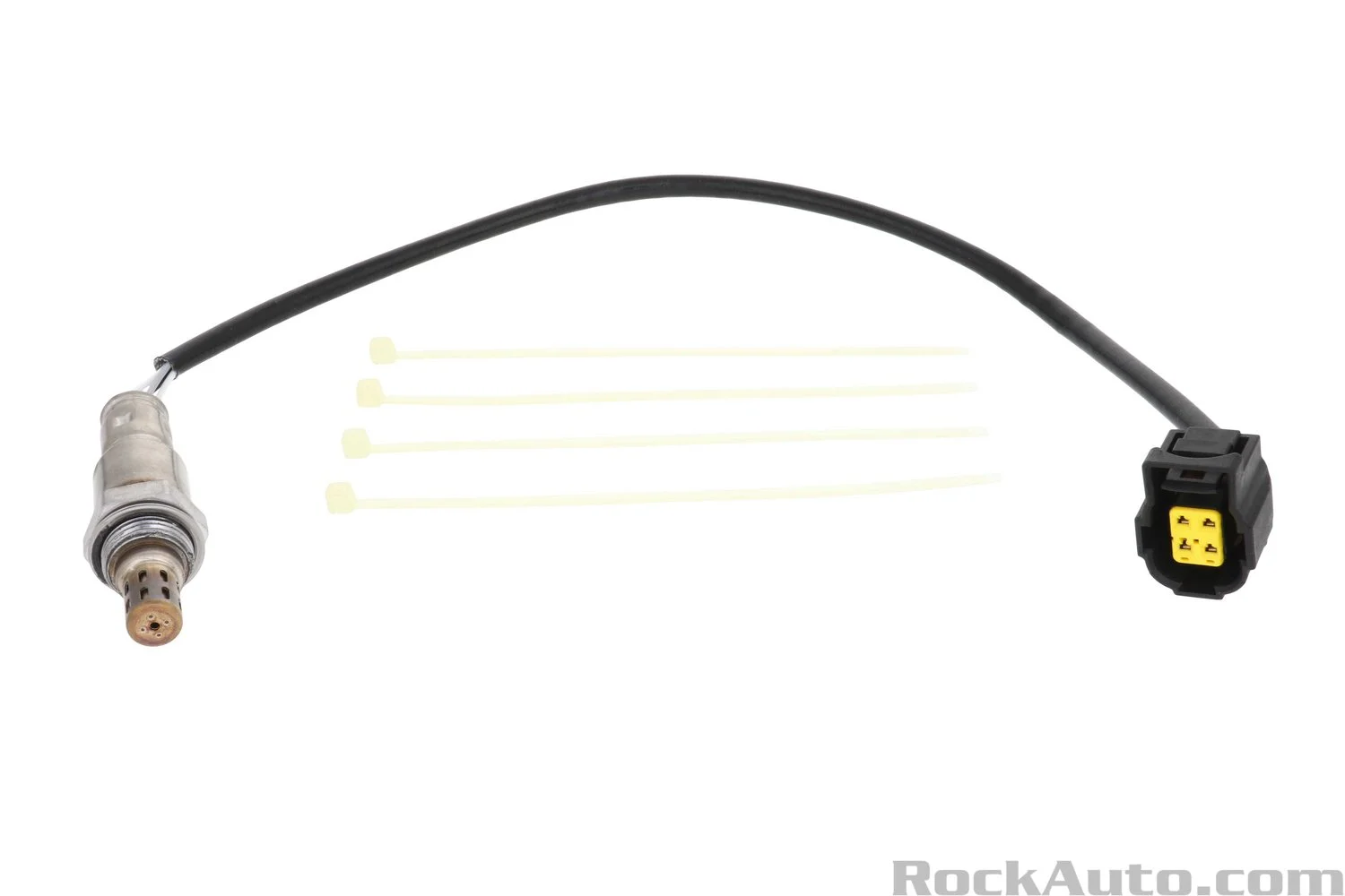

"new and improved"
vs what the "old" design 23018 looks like (photo is of the 23160 bank 2 sensor so the cable/connector is wrong but the bulb tip matches)
It's so tempting to go find a 23018 on a parts store shelf somewhere just so they match but I already have an opened 23195 and don't want to deal with the hassle of a RockAuto return. I wouldn't think anything of it in the past but it's 2026 and everything is being enshittificated and it seems more often than not that "new" versions of stuff are just ways the manufacturer found to increase margin.
No action items here, just griping.
