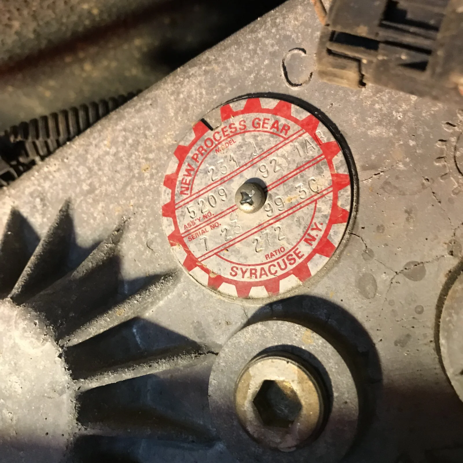

While under the TJ, I noticed a manufacturer badge on the diff case. Likely just a run of the mill badge with identifying nomenclature. Anything interesting about the system in this TJ, I assume it is just a standard system/badge?

It's nice having a properly adjusted E brake isn't it. The tag on the TC is just the standard badge for the NP231 case.
