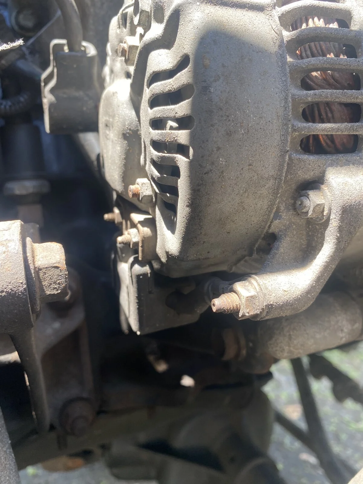

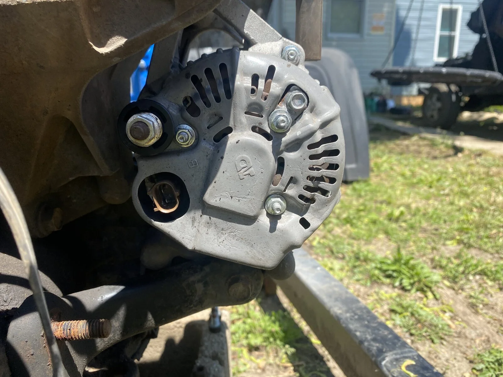

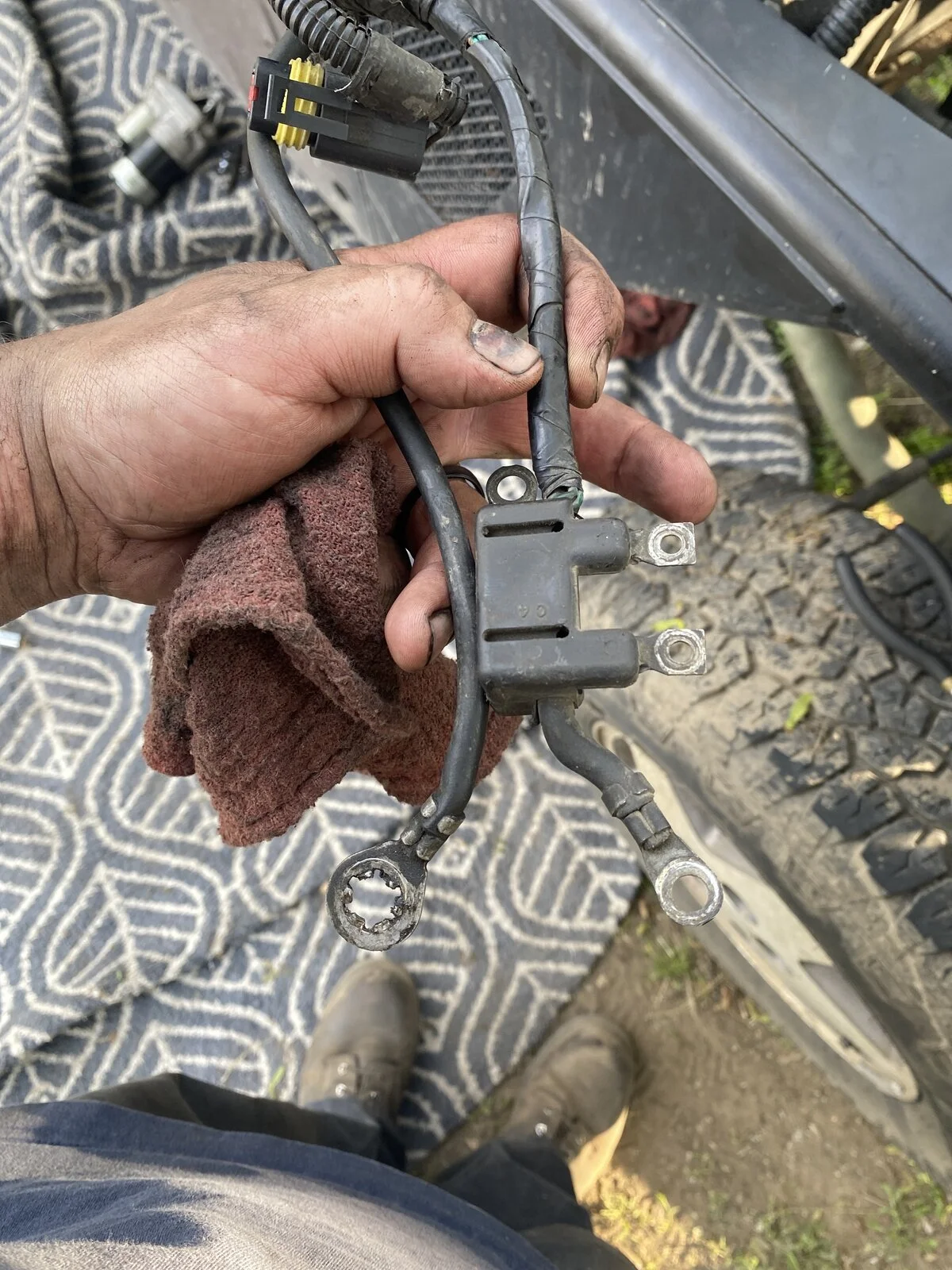

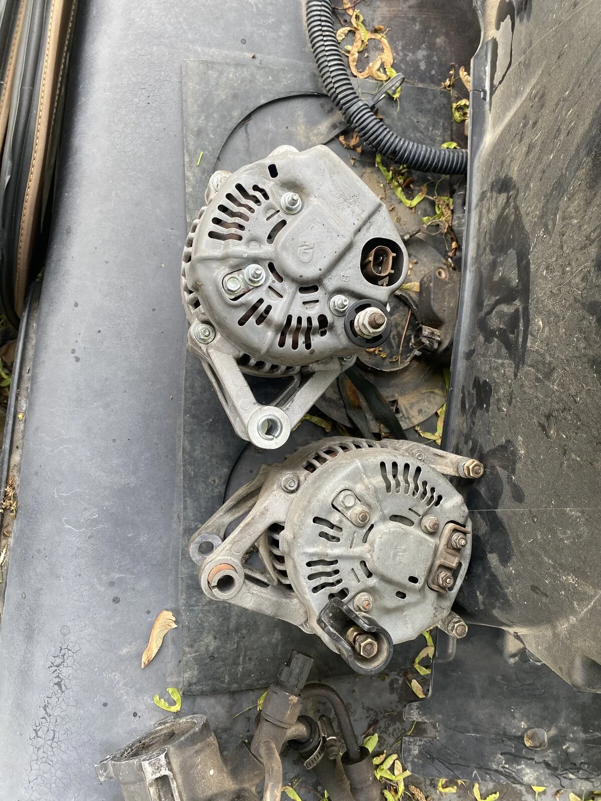

I’m about to swap my engine out for the one I’ve been rebuilding for a few months now. My question is that I have two different alternators. One from a 97 ( my original) and one from a 00 model. The newer one has different wiring so I’m not sure it will work without splicing wires or maybe more. I’ve read that the newer style has something different with the voltage regulator setup but I don’t have a clue. Anyone have any feedback?
I would suggest stick to the alternator type you have, since the two are quite different in their hookup. Why do you have a random one from a 2000?
