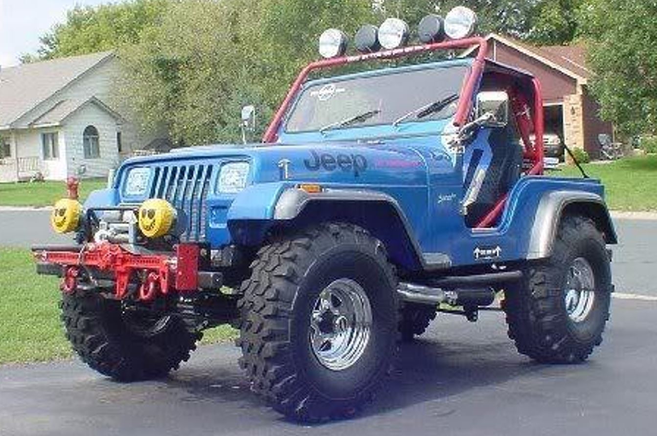

I ran different gear ratios front and rear. It depends on your combo of things being used. I had dana 60 rear, 44 front. 38" tires front and 42's on the back. IT CAN BE DONE. 205 transfer case, turbo 400 and hi horsepower smallblock.
