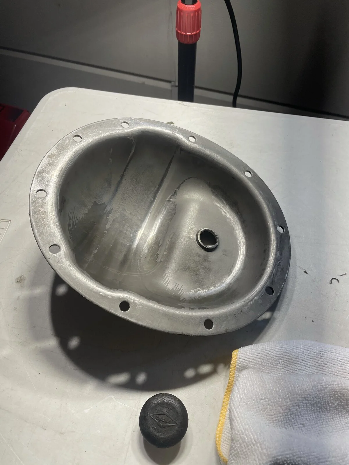

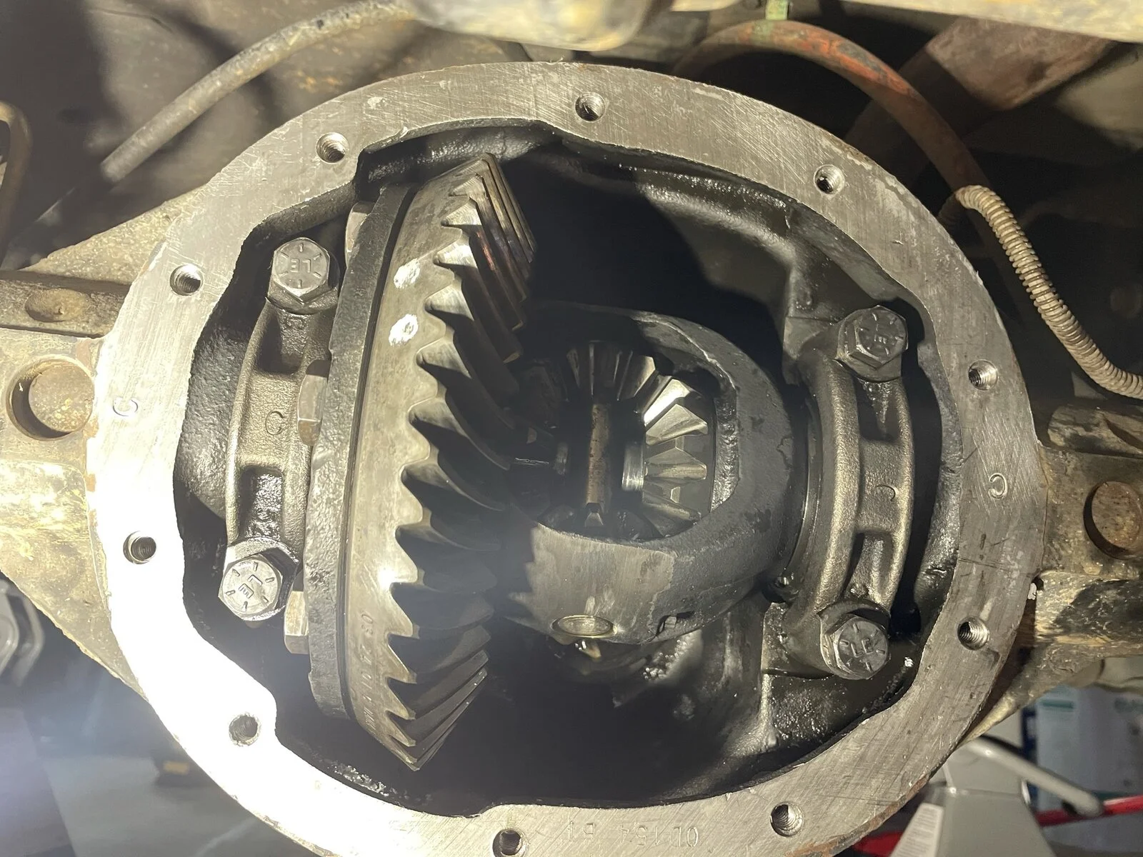

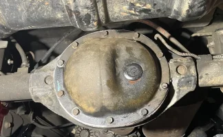

Just to put closure on this thread, I had success with this project.
I removed the cover, cleaned everything up and installed the new Lube Locker gasket today. Thanks to @Jerry Bransford and others who gave advice in this thread.
I cannot test the seal because of wet and salty roads but everything went by the book with the installation so I think I am good to go! Thanks again
