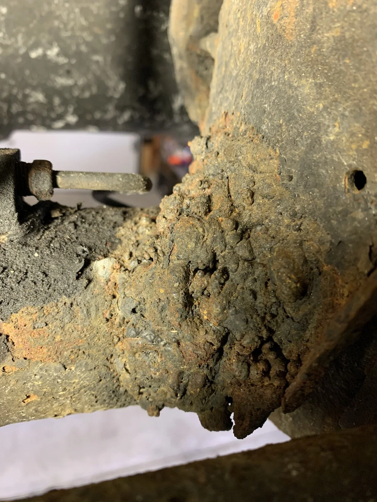

I have a 98 Tj mostly stock. It came with Dana 35 rear end with 4.10 gears ( I tested this on a lift and from what I read all 4cly 98s came with 410 gears.) The rear axle has been repaired a few time and the control arm brackets and shock mounts look like someone welded with bubblegum. Also the factory spring supports are rusted out and the springs are basically sitting on the axle tubes. I bought an 03 Dana 44 off a rublicon. A buddy was going to put it in his jeep had it sent out and rebuilt. My question is the 03 comes with disc brake set up. My 98 has drums. Do I just need new rotors and calipers or do I need new lines and modification to the brake master cylinder to use the 03 axle? Also I was going to measure but someone may know do I need a new rear drive shaft or will the old one fit? I have no lift and as far as I can tell the drive train is factory.
