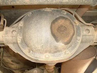

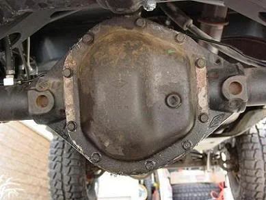

Do you know what rear end you have. Dana 35 Left, Dana 44 Right
Its the 1 with rubber plug.
So you have a Dana 35 axle which could mean you have the Grand Cherokee disc brake system which is a common conversion. I took a label maker and labeled my owners manual with the rear brake info but I doubt many take the time for that simple notation.
Thats a really good idea, i really appreciate the help. Just bought everything. Headed home to put it back together. Thanks again
