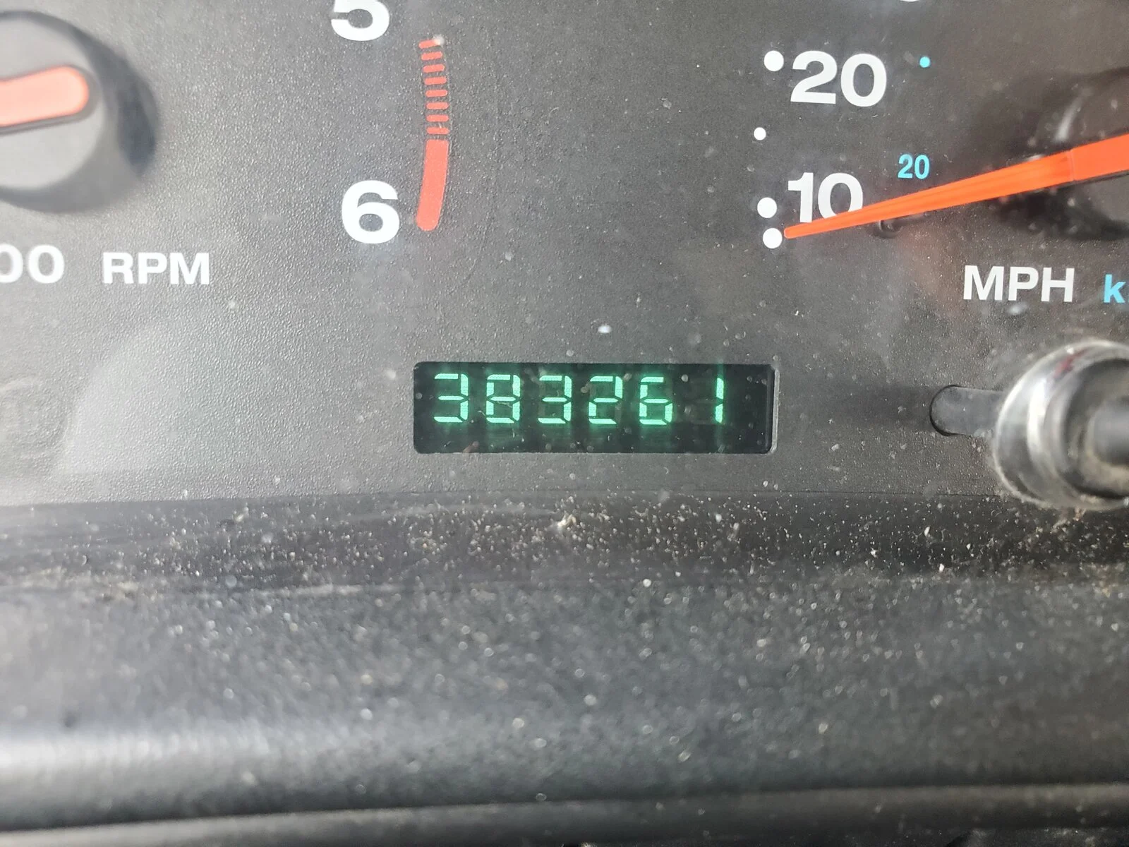

Ok so my question is ...do rpm of the engine have anything to do with transmission shift points ...
Needed info
2004 Rubicon auto 42rle
5.13 gearing
265/75/16
Speedohealer
Problem is it's shifting into overdrive before 35mph unless I'm hard on the gas .. at least halfway to the floor or is this a sign the trans is going bye bye .. I've heard from several sources including here that the trans won't last as long as this milage so what's the average milage life of the 42rle
