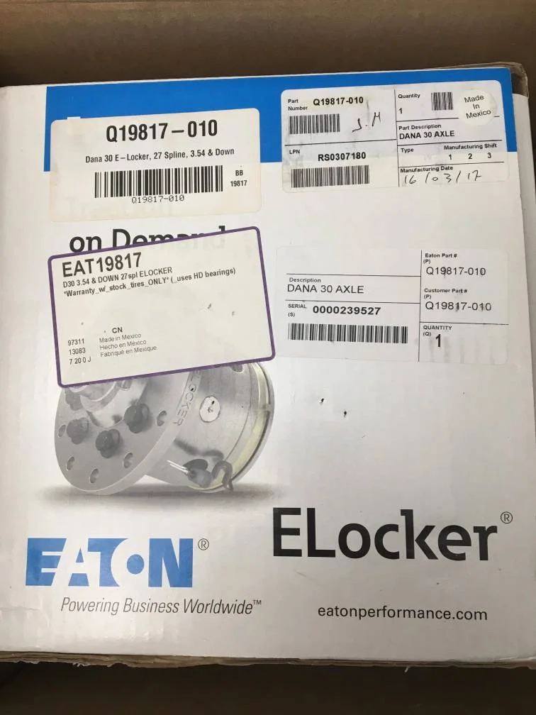

I'd like to know If there is any thick cut gear for the front dana 30. I'm stuck with a brand new useless electric e-locker and I cannot fit my 4.10 gears. A can't find nowhere on earth thick cut gear for my locker and even a spacer is unavailable. Is there anybody who managed to to something to make it work please.

I'd like to know If there is any thick cut gear for the front dana 30. I'm stuck with a brand new useless electric e-locker and I cannot fit my 4.10 gears. A can't find nowhere on earth thick cut gear for my locker and even a spacer is unavailable. Is there anybody who managed to to something to make it work please. View attachment 86377

Worth a call to clarify if the thick only applies to the 44.
Have you tried seeing if the vendor will swap your carrier for the right one? They might not do a return but they might accept a swap for the cost of shipping
I bought from someone who shipped it to me and who apparently had change his mind on his project.. I think I know why now.
