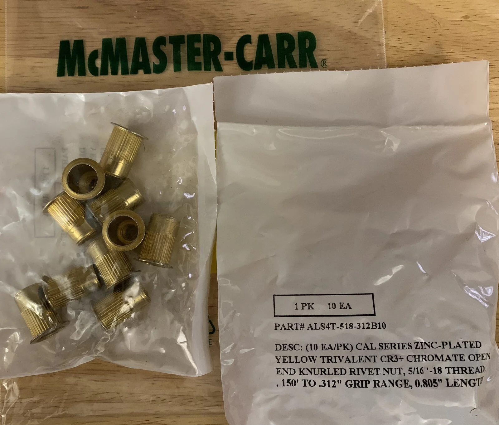

Alright, I'm pretty much done with this. How many nutserts and bolts do you need? I also have the limited use setting tools. Count them up, send me a private message with the quantity and a shipping address and I'll get them on the way.
That is extremely generous of you but I also don’t want to be a bother!! I apologize for this whole thing. Truly thought it’d be a simple swap and something off my laundry list of things to do to my Jeep that I could manage myself.
I literally have 1000's of various size nutserts and more than a few setting tools. It isn't a bother.

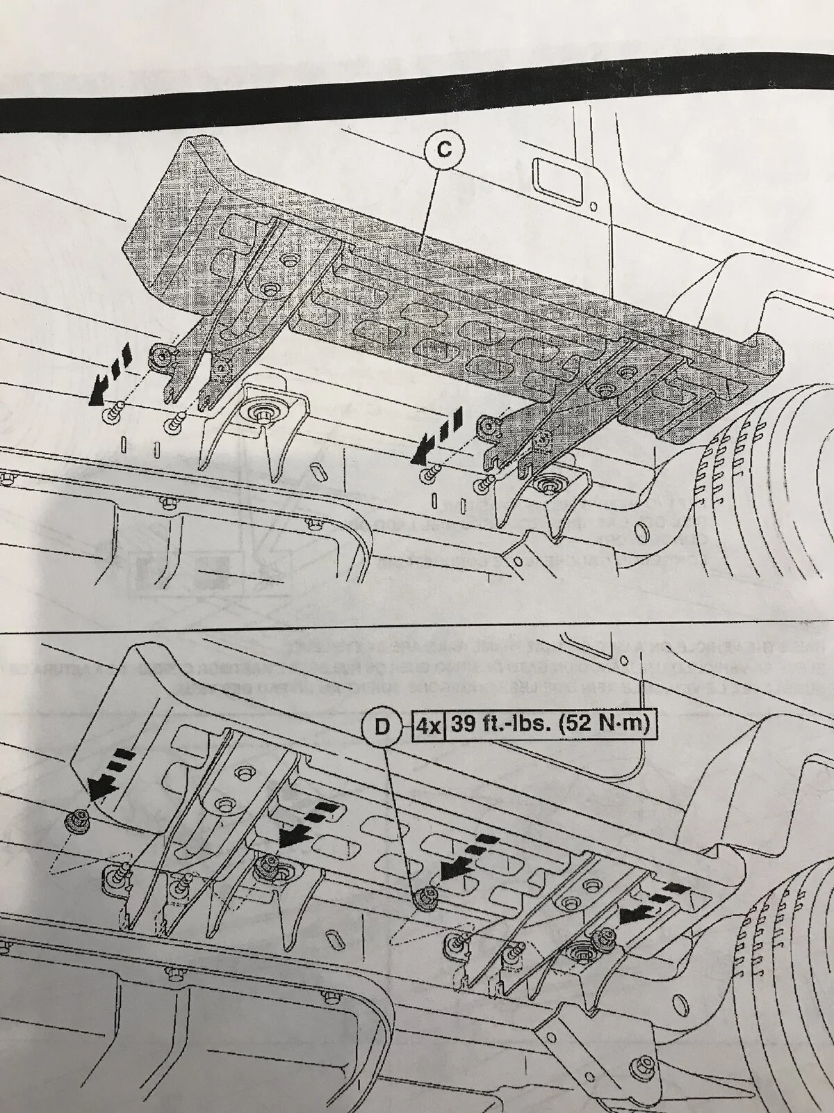

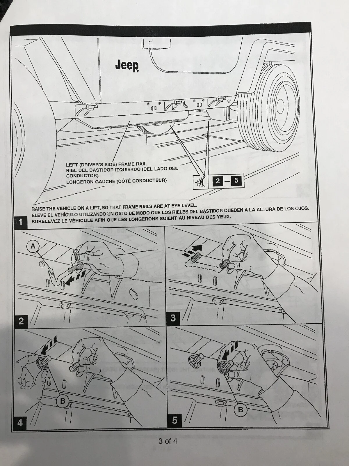

For what it's worth, these are the directions that came with the steps I bought new (very bad photo copies) for our 2004.
They used bent threaded rods (poor description) to go through the frame into the step brackets.
Nutserts seem to be a better alternative and Mr Blaine will get you the correct ones. Sorry no part numbers on the sheets.
Reactions: John Cooper
There are at least two versions, that one and then the earlier one that has just nutserts with bolts at 4 places per support. The OEM bolts are 8mm and they are the same hole size as the 5/16-18.
