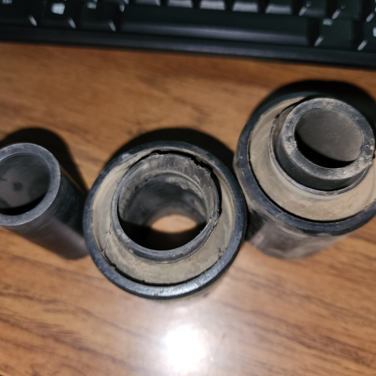

I used synergy ddb bushings religiously for 3 years. After 1 year, I was replacing bushings at an alarming rate and ceased using them completely 2 years later. After 2 more years I stopped having to warranty bushings. It wasn't just a few, I'd built hundreds of arms. I don't buy into the bad batch excuse. There have been plenty of ranch, Clayton and ready lift bushings that have been swapped out here as well, no just synergy.

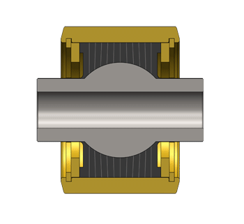

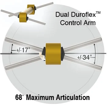

YIKES! No Bueno … perhaps I’ll end my quest. I had high hopes for these. I was even going to source a pair for the rear of my corvette (uses a trailing arm with 3 axes of movement) … I was convinced these were the future. But I guess the polyurethane material is just not suited to constant movement. Makes me appreciate Mother Nature and the rubber she provides like nectar to our hobby 😂.

To be clear, were these the original recipe or the “improved” units with the tension ring on the ends of the bushing?
Right! I lifted 2 Gladiators and thought these bushings were great. They’re just normal rubber bushings tho. I “thought” the polyurethane of the DDB bushing plus the free rotation of the sleeve would get us a bushing that will live forever, not degrade as it ages and offer bind free motion along all axes. NOPE! (Or so it seems)

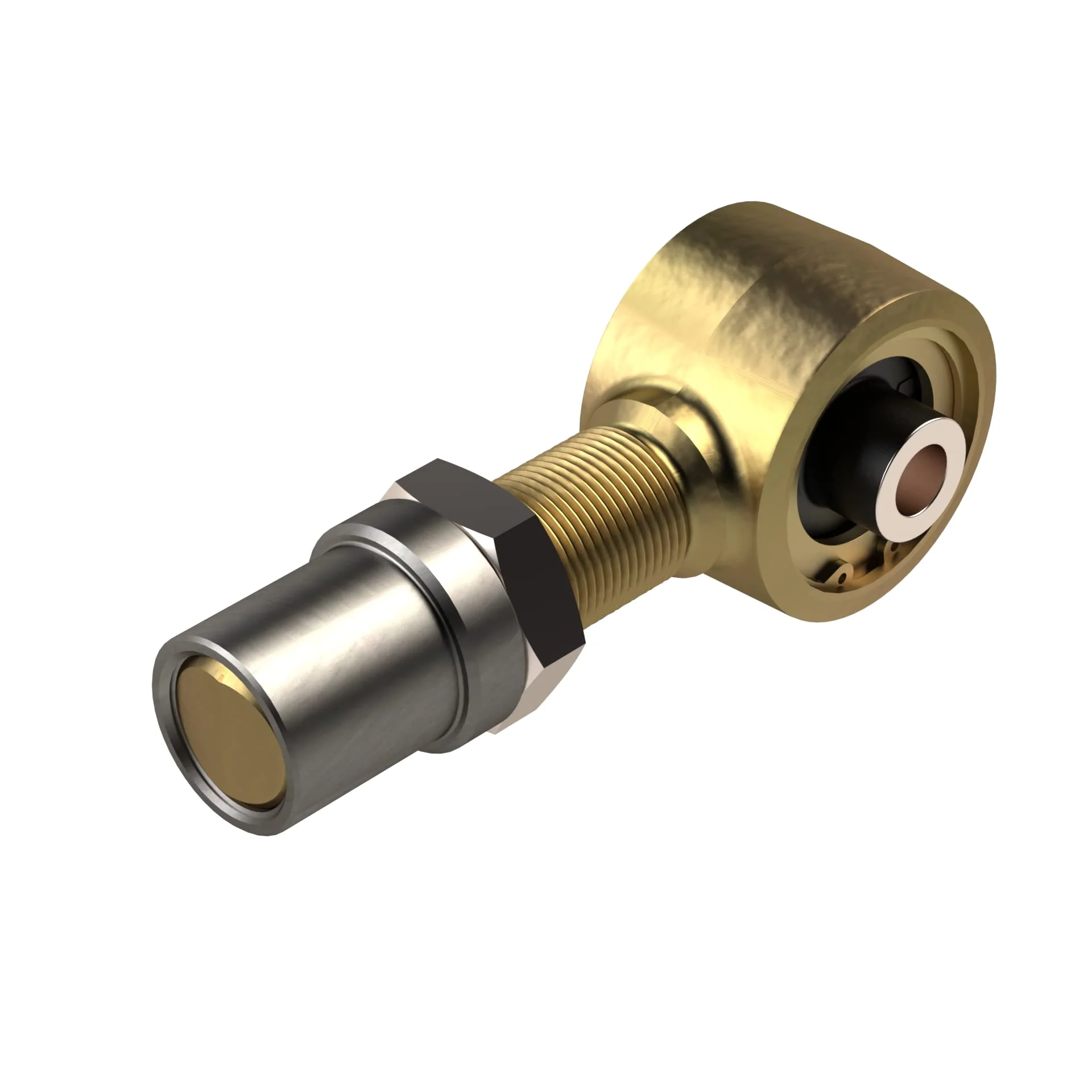

we can't even grease the mc joint with grease let alone use a grease gun. They have to be disassembled, cleaned and then spread the lip balm on them with your finger that they send you, which was about 4 times a year for me on one of my personal rigs running 12" travel shocks I had put them in. I became pretty disgruntled about that. every single rig that comes in my shop with mc joints makes noise from the control arm joints. 4hour plus labor for a service is pretty ridiculous when we can grease 16 currie control arm joints, tie rod, drag link and ball joints before the engine oil stops draining out.
You'll have to let me in on your secret with the Currie joints. None of mine take grease through the zerk; I have to pull them and press them out, clean them up, grease and reassemble so it's much more like the process you go through with MC.
