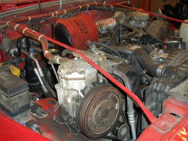

16-17 years ago before I knew any better I installed a K&N air filter (for a reason explained below) that a wheeling buddy noticed. He suggested I pull it off and wipe my finger around inside the air tube and inside of the throttle body. I was absolutely shocked/stunned how much gritty dirt there was inside that had gotten past the K&N.

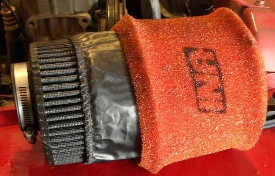

It freaked me out so bad that I installed not one but two pre-filters over the top of the K&N which mostly stopped the problem. I couldn't go back to the stock air filter and air intake box because I had installed a belt-driven York compressor that made it impossible to keep the factory air intake in place. This photo shows those two pre-filters pulled back, a K&N Outerwears and a foam Unifilter, so they can be seen. I first installed K&N's Outerwears but its fit was so sloppy that dusty air got around it. I added the Unifilter to hold the Outerwears against the K&N so the dusty air couldn't get around it.
This is why I couldn't go back to the factory air intake which I wished I could have...

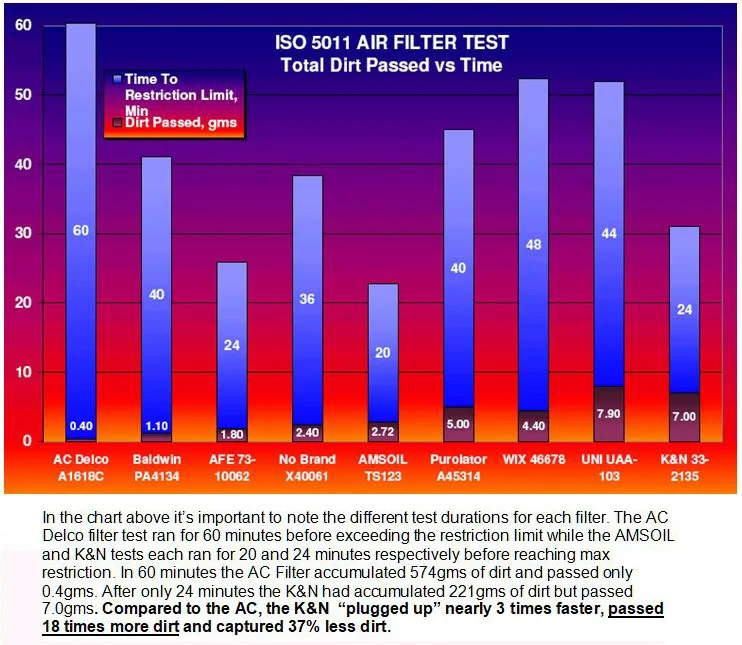

So far as the K&N air filters go, various lab-conducted filter tests show its abysmal ability to actually filter dirt & dust out of the air. This is just one of the charts in one ISO-5011 lab test that pretty well sums up just how shitty of an air filter the K&N is. Read at the very last sentence below, the one that is bolded and underlined. They are the lab's words, not mine. ISO stands for International Standards Organization which means the tests were conducted to precise lab standards.

Just goes to show how much BS there is out there to help sell a product. I bought into the K&N myth years ago without doing any research. Sure sounds good but when you look at the hard lab data as in the ISO comparisons, K&N does not measure up to the sales pitch.
