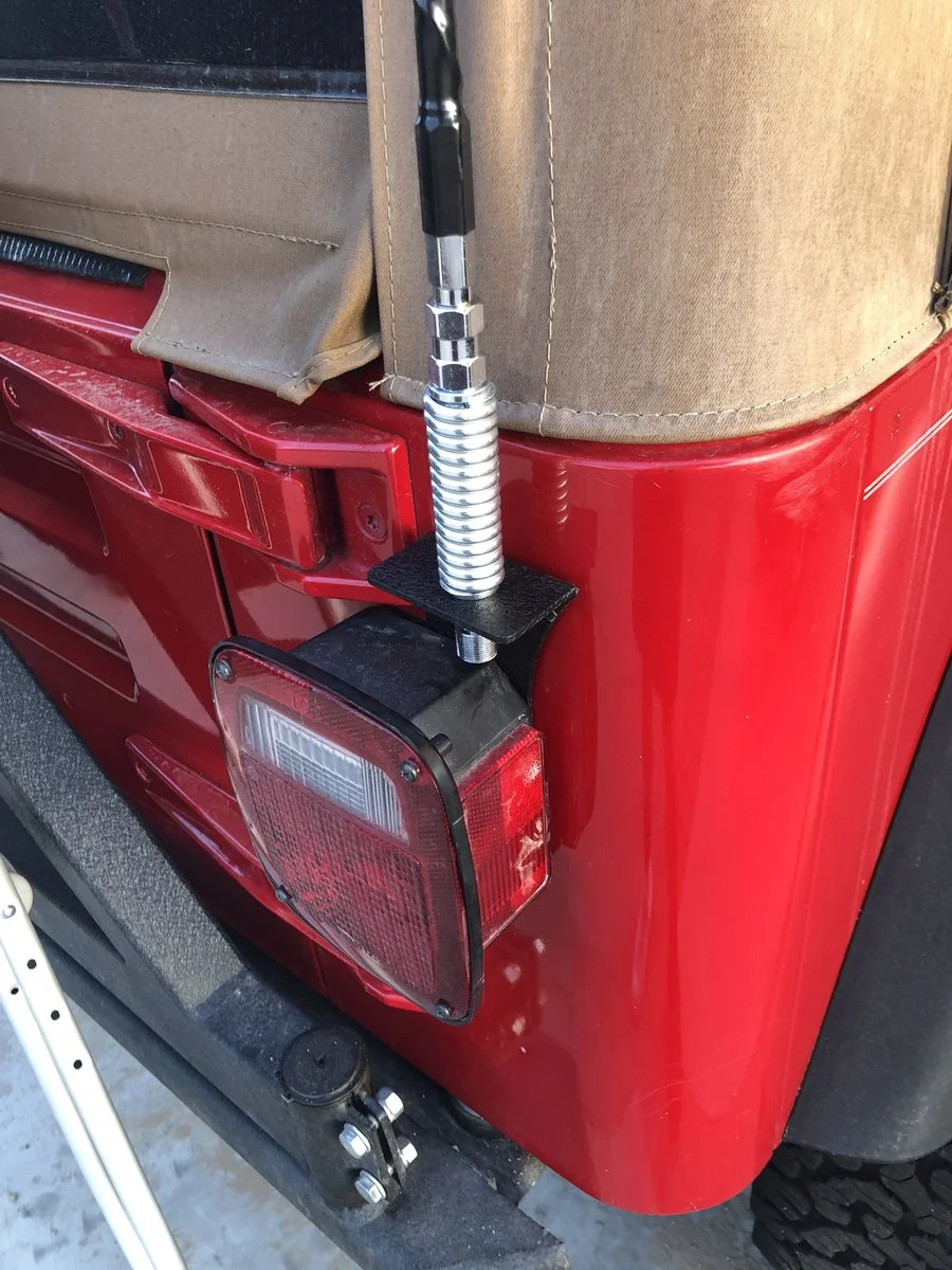

Just installed the antenna mount and ground the paint off the 3 mounting holes as well as underside where antenna mounts too . Lot of wiggling going on though doesn’t seem like the 3 bolts are strong enough to hold the antenna if it gets goin from hitting something or just rough terrain. I noticed a smaller hole above taillight and looks like it would work well as a stabilizing bolt hole . Is that it’s purpose ?

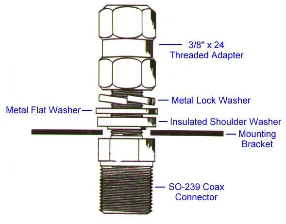

No, that mount is misassembled. The white nylon insulating shoulder washer goes on top of the bracket. Your spring and antenna are both shorted directly to ground with the nylon insulating shoulder washer improperly positioned under the bracket.
It should be assembled exactly as shown here...
Just installed the antenna mount . . . doesn’t seem like the 3 bolts are strong enough to hold the antenna. . . .
I noticed a smaller hole above taillight and looks like it would work well as a stabilizing bolt hole . Is that it’s purpose?
That is exactly its purpose.

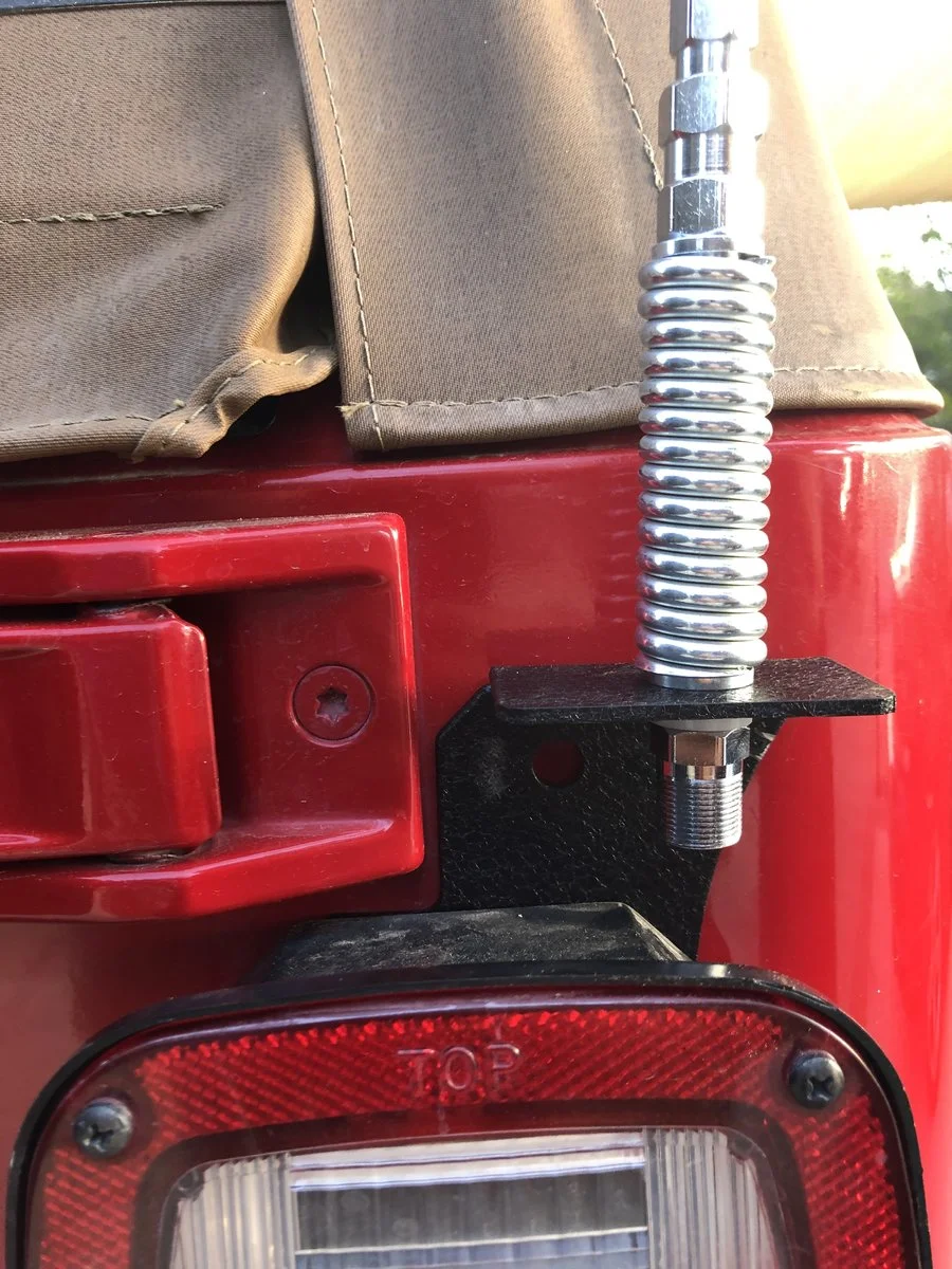

I drilled a hole in my jeep for my Teraflex tail light antenna mount - as seen in the following photo. The mount is now rock solid with the "optional" bolt. It is a better arrangement than using only the taillight screws.

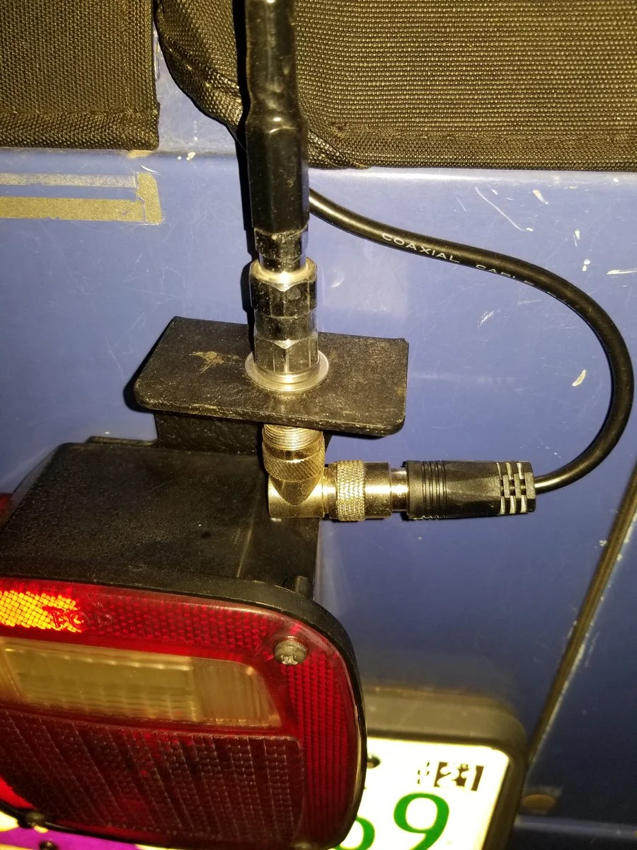

And X2 on the 90 degree coax coupler. I use one with a Teraflex tail light antenna bracket and NMO antenna mount for my ham radio. Now the coax easily clears the tail light and there is a straight path for the coax into the jeep.
90 degree couples work wonders. View attachment 142671
