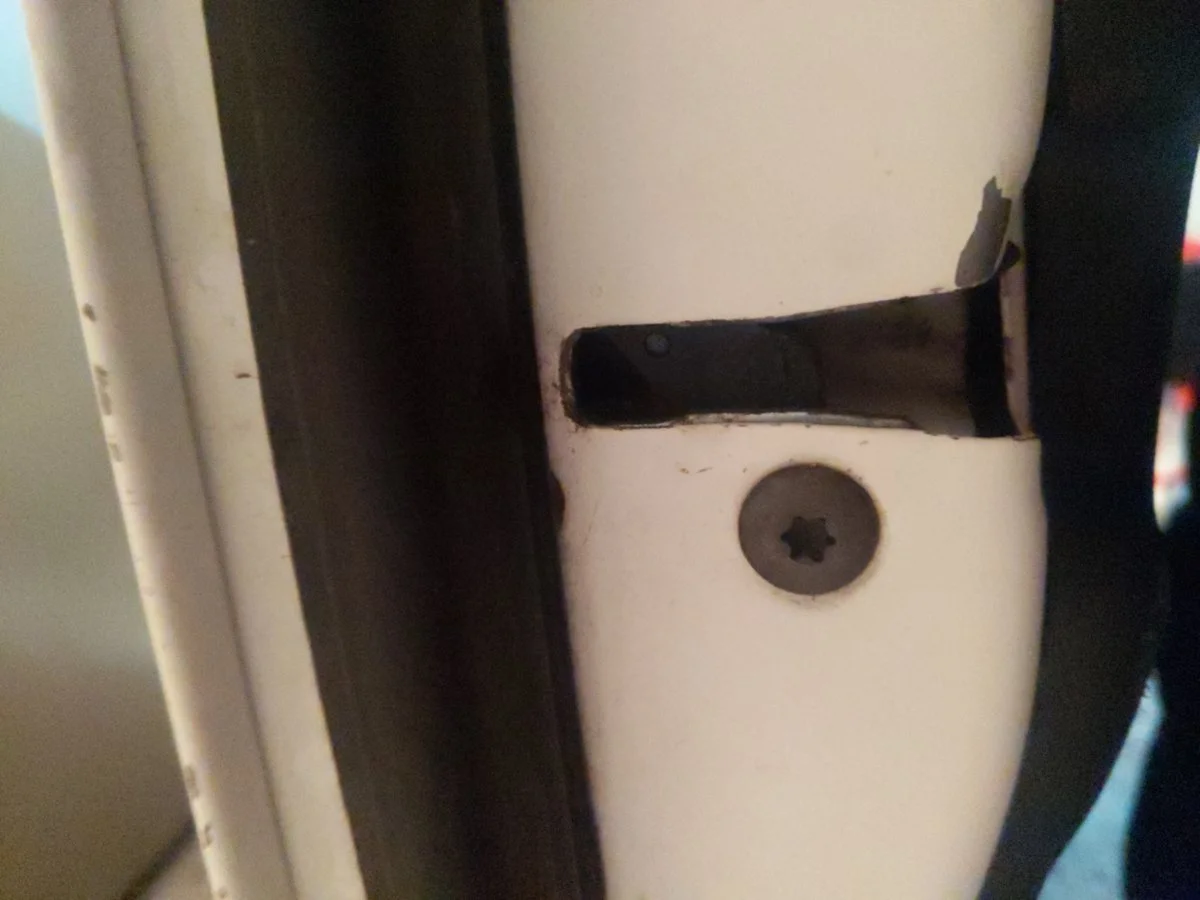

I'm gonna try to explain this as best I can. The latch mechanism on my left full door is currently freezing up, as best as I can tell that's what's happening.
It's happened a few times today where I'll go to close the door and the latch won't secure on the hook, it is properly aligned though. When I looked at it the latch is just free hanging, I'll use something to push against it and instead of locking in position it just swings back open. I'm currently tearing apart my door and getting ready to order all new hardware from RockAuto if needed, anyone have any ideas before I do?

@Chris, just got it torn down, you're talking about the plate in the mechanism and not the actual hoop correct?
I'm talking about the striker plate in the door jam on the tub. If you loosen the bolts, it can move in all directions to some degree.
