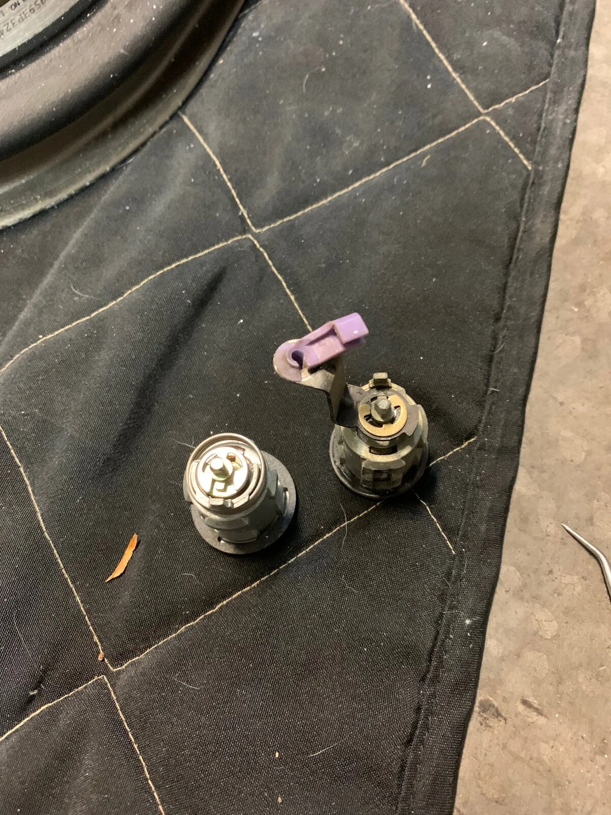

I recently added some full doors for my TJ, thank you @Chris . I read @MountaineerTom 's thread on rekeying locks, and I was planning on going this route until I found Wolf Security Hardware on ebay: https://www.ebay.com/usr/wolfsecurityhardware?&campid=5337789113 and their website: https://www.wolfsecurityhardware.com/

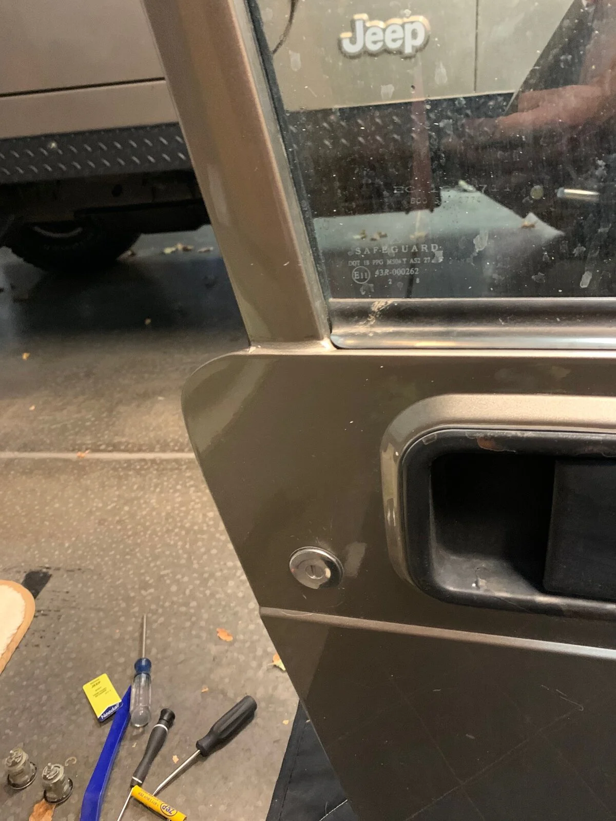

For about $65, I received two new door locks, two keys, and they were keyed to fit my TJ (you send a high resolution picture to Walt at Wolf and he matches the new lock to your exiting key). After I placed my order, Wolf shipped my new locks and keys in less than 2 hours. I installed the new locks today, and the locks and keys work perfectly. I'm impressed with the product, price, and service from Wolf.

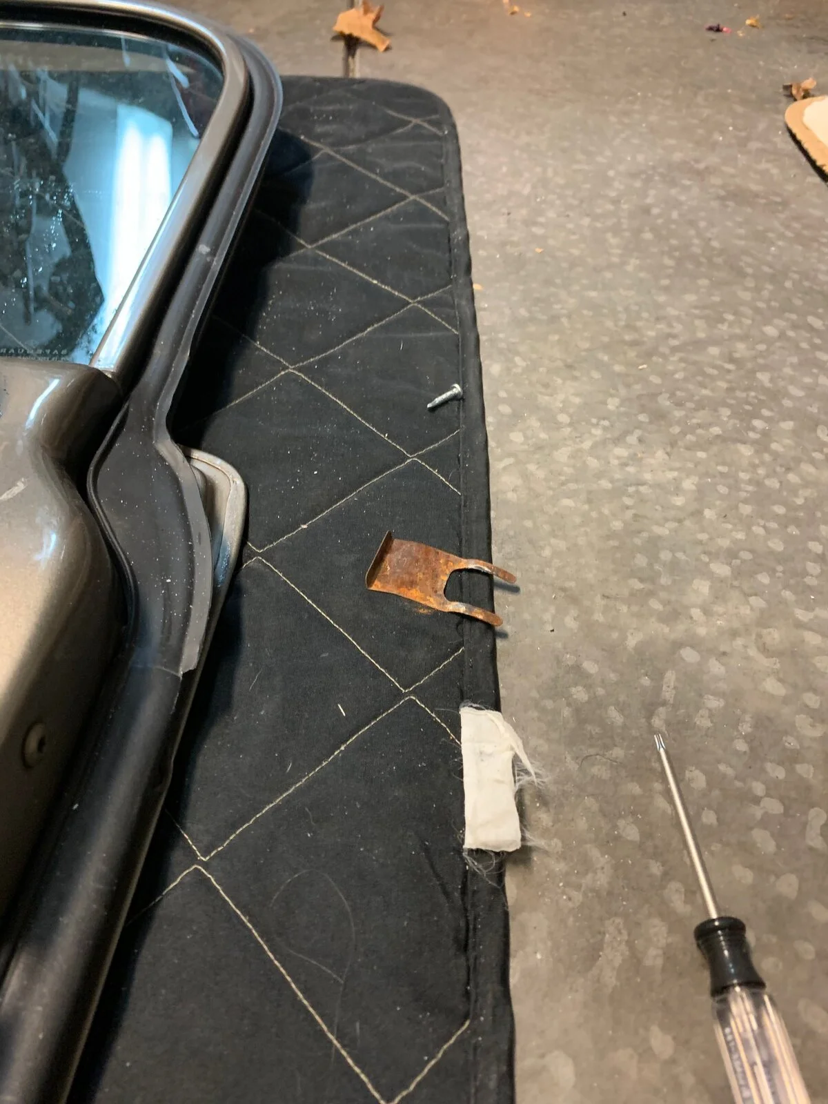

I assume you have to remove the door panels to get to the locks?

Yes, panels are removed. Then take a long flat head screwdriver to remove the inner metal clip (rusty piece beside door) and pop the purple piece off the rod. Then the locks slide right out. It is pretty easy.

I went to three or four stores looking for plastic door clips but could not find them. Paid a couple of buck for 30 of them on Amazon. They work but bend very easily.
