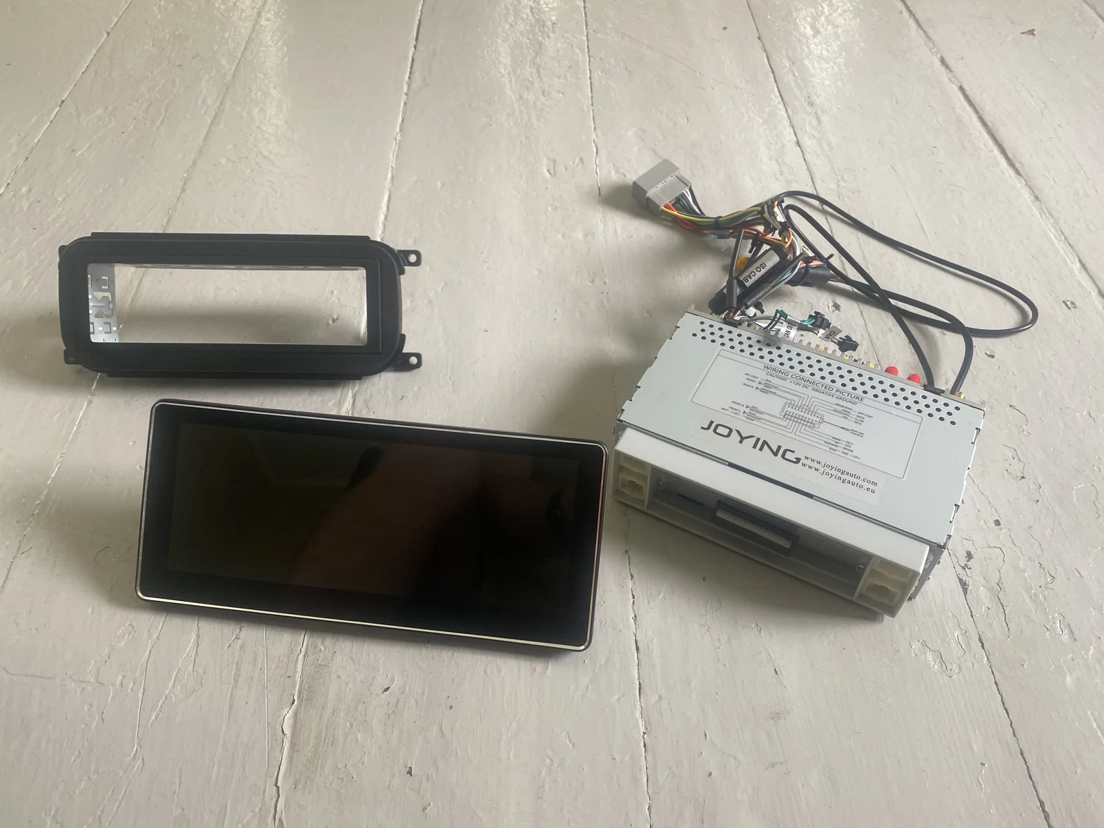

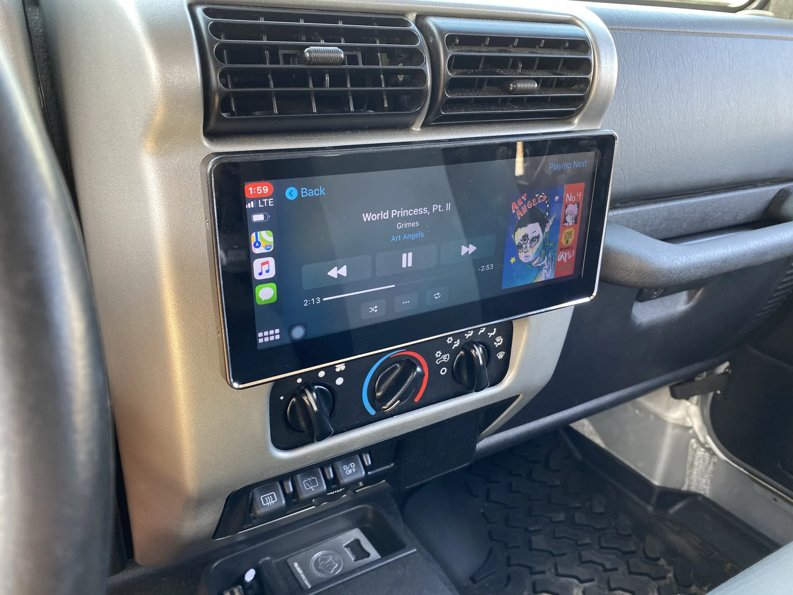

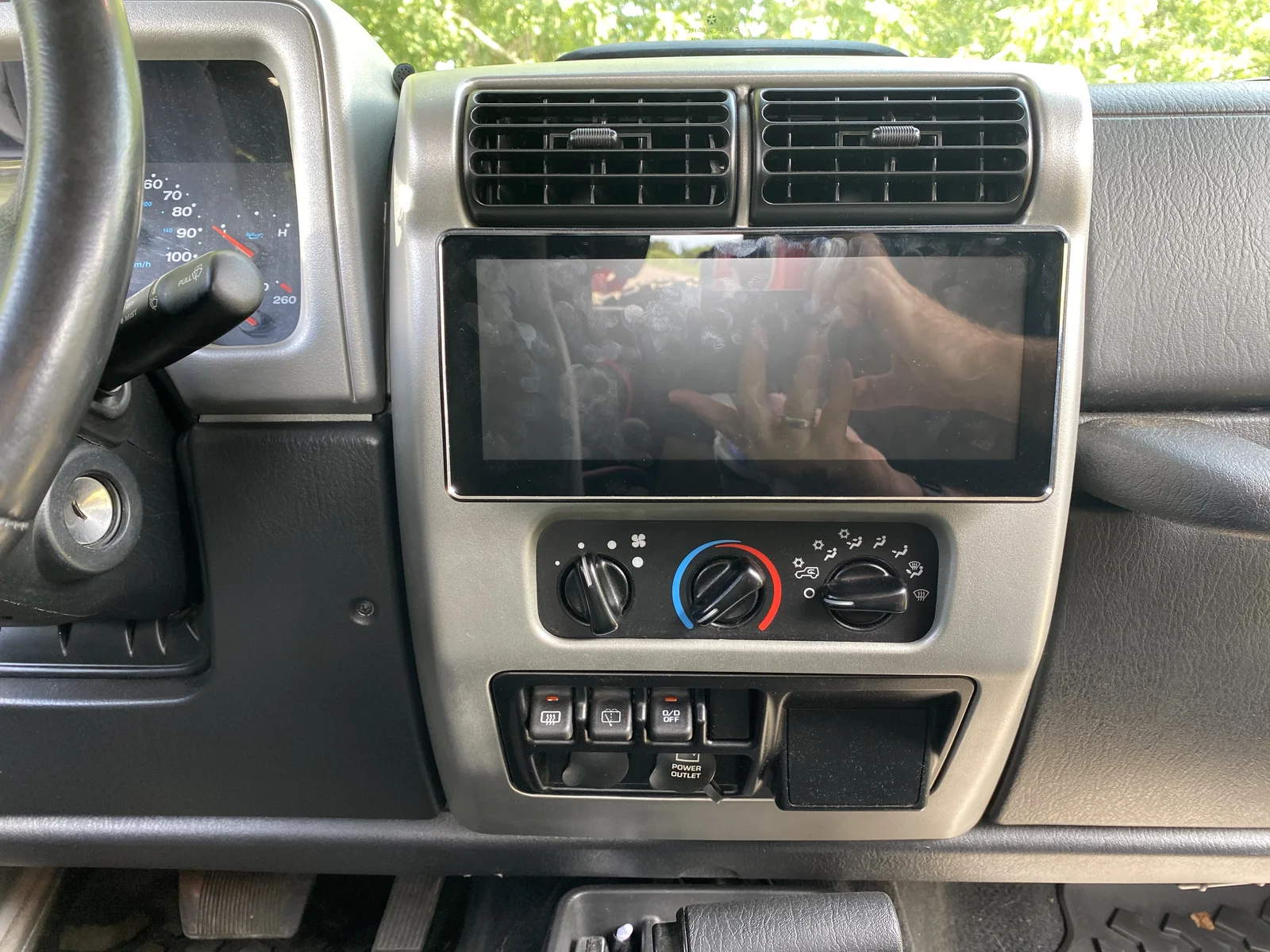

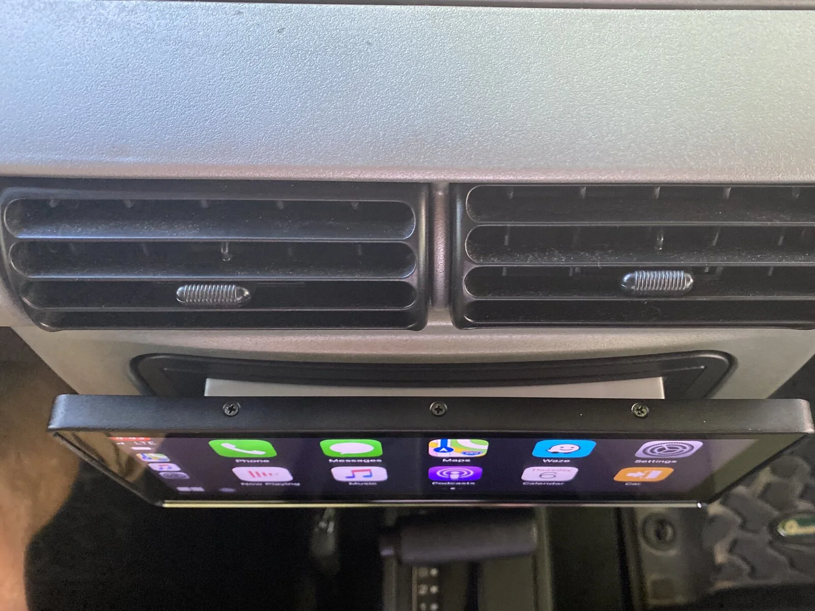

It's been updated since I bought mine this summer. Installed it looks like it was made for the TJ and definitely freshens up the technology and modernizes it nicely. It did require a few minor tweaks to fit perfectly, but they were very simple. The widescreen aspect ratio is better than double-DIN IMO... This is my third CarPlay unit and by far my favorite.
Single-DIN adapter and harnesses soldered/shrink wrapped and the unit ready to go in:
Final installed position:

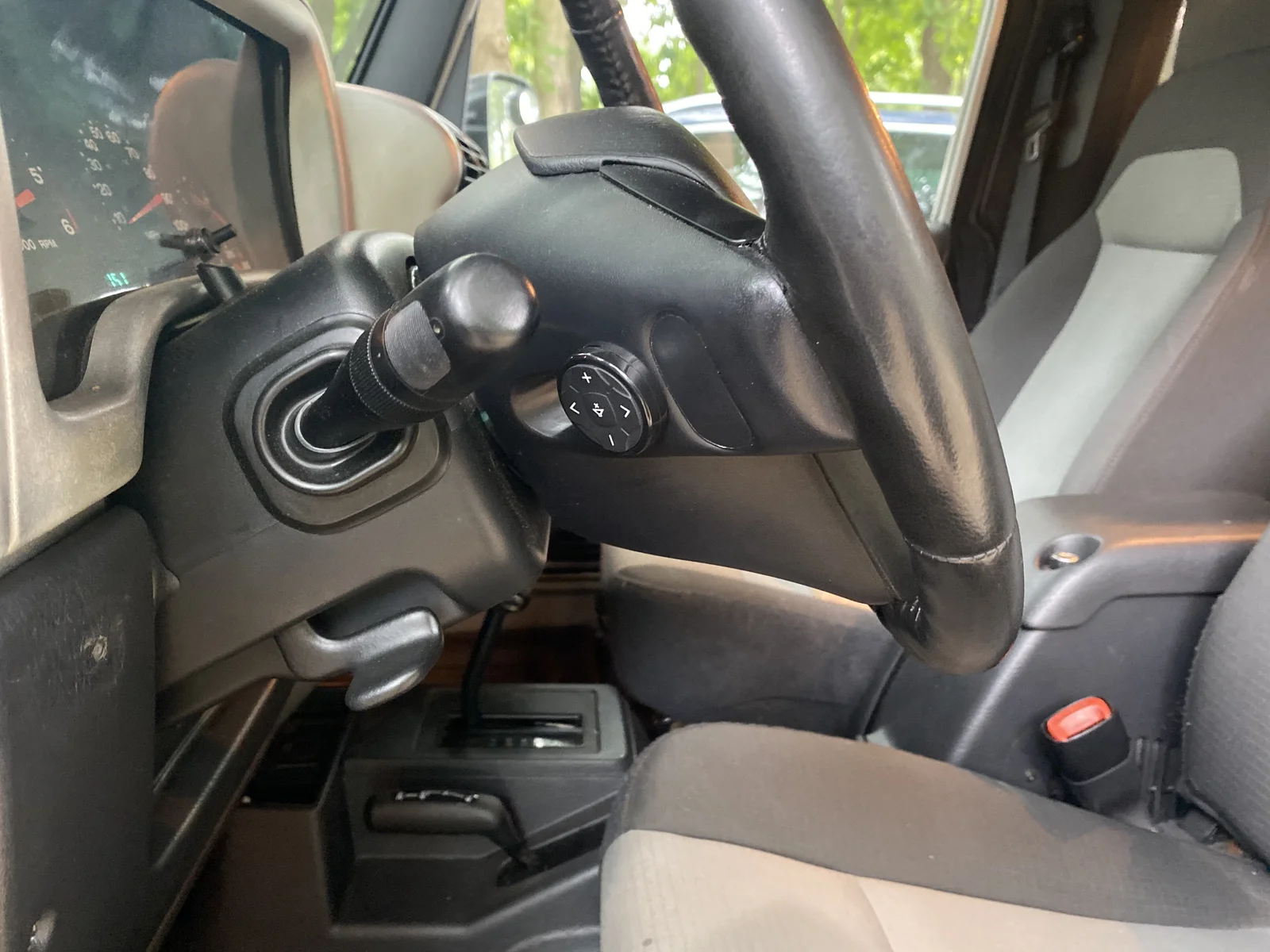

I also added wireless steering wheel controls since the lack of a physical volume button was a pain.

This is awesome. How do you get the connector for the factory plug?
I got the single-DIN adapter and harness adapter from Amazon. The Joying had an ISO harness plug, so I ordered this as well, but it didn't arrive in time so I just cut the ISO plug from the Joying harness and joined it with the adapter in the other link.
And the steering wheel controls were these.
