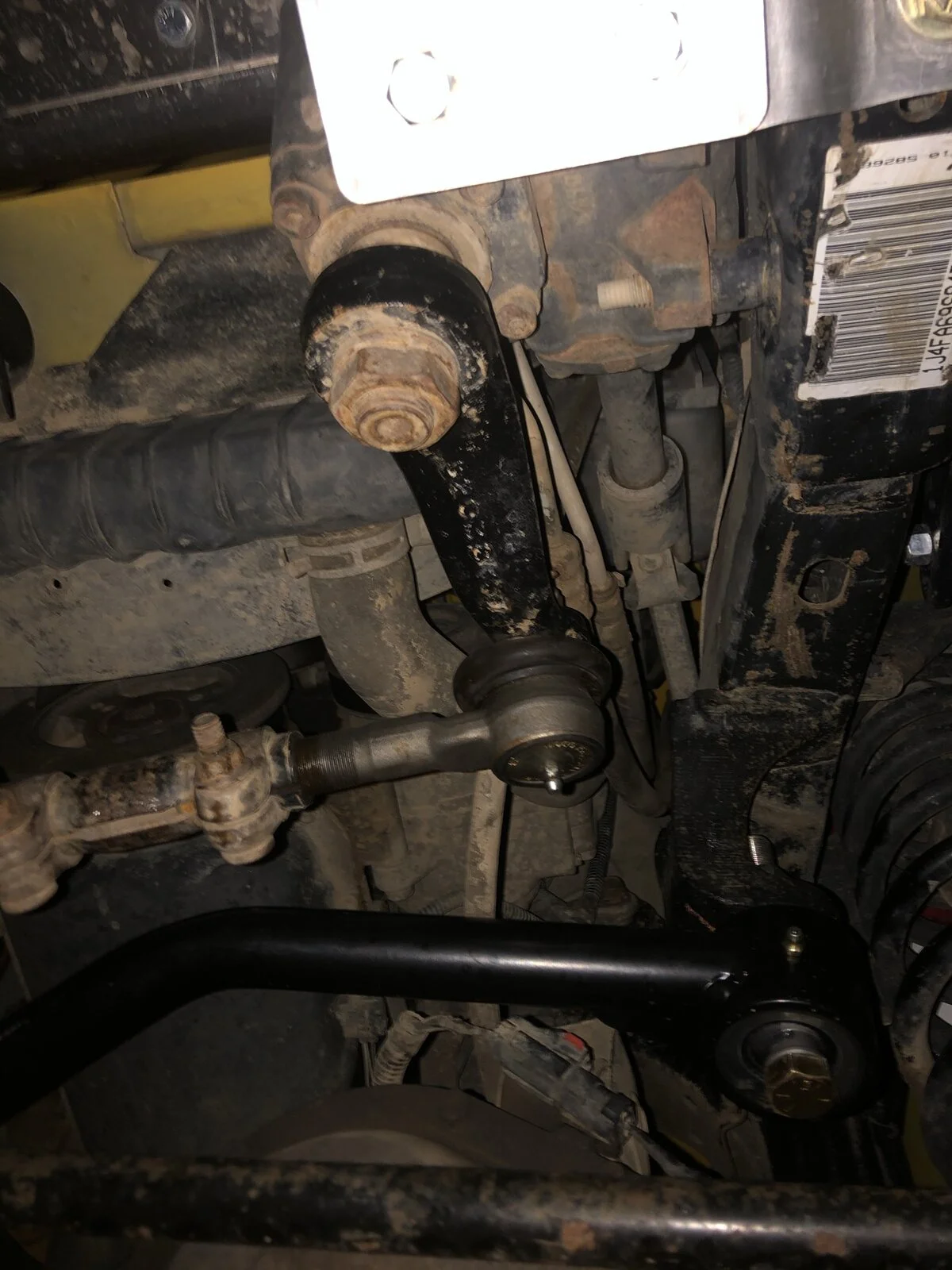

Okay I get what you're saying. I went out to test it out and take some pics since you made me curious. Here's how mine sits.
Tires straight, steering wheel centered:
It sits slightly cocked to the driver's side.

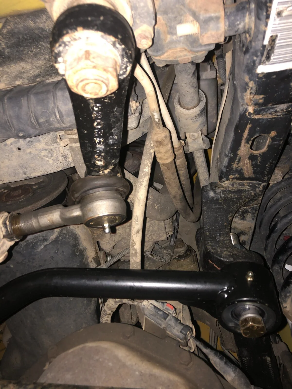

One steering wheel revolution to the right:
Now slightly cocked to passenger side.

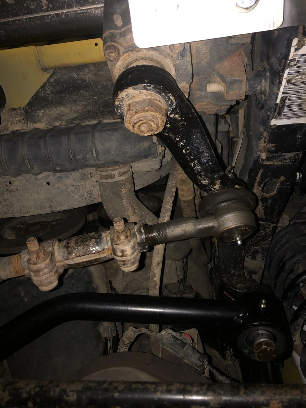

Recentered tires, then one revolution to the left:
Now, sorry, you weren't all the way overthinking it. I see what you're saying. Just use common sense when setting it up. Get the pitman arm as close to centered as allowable. I'd say the first two pictures are okay as an example of pitman arm position with straight wheels but not the last.
