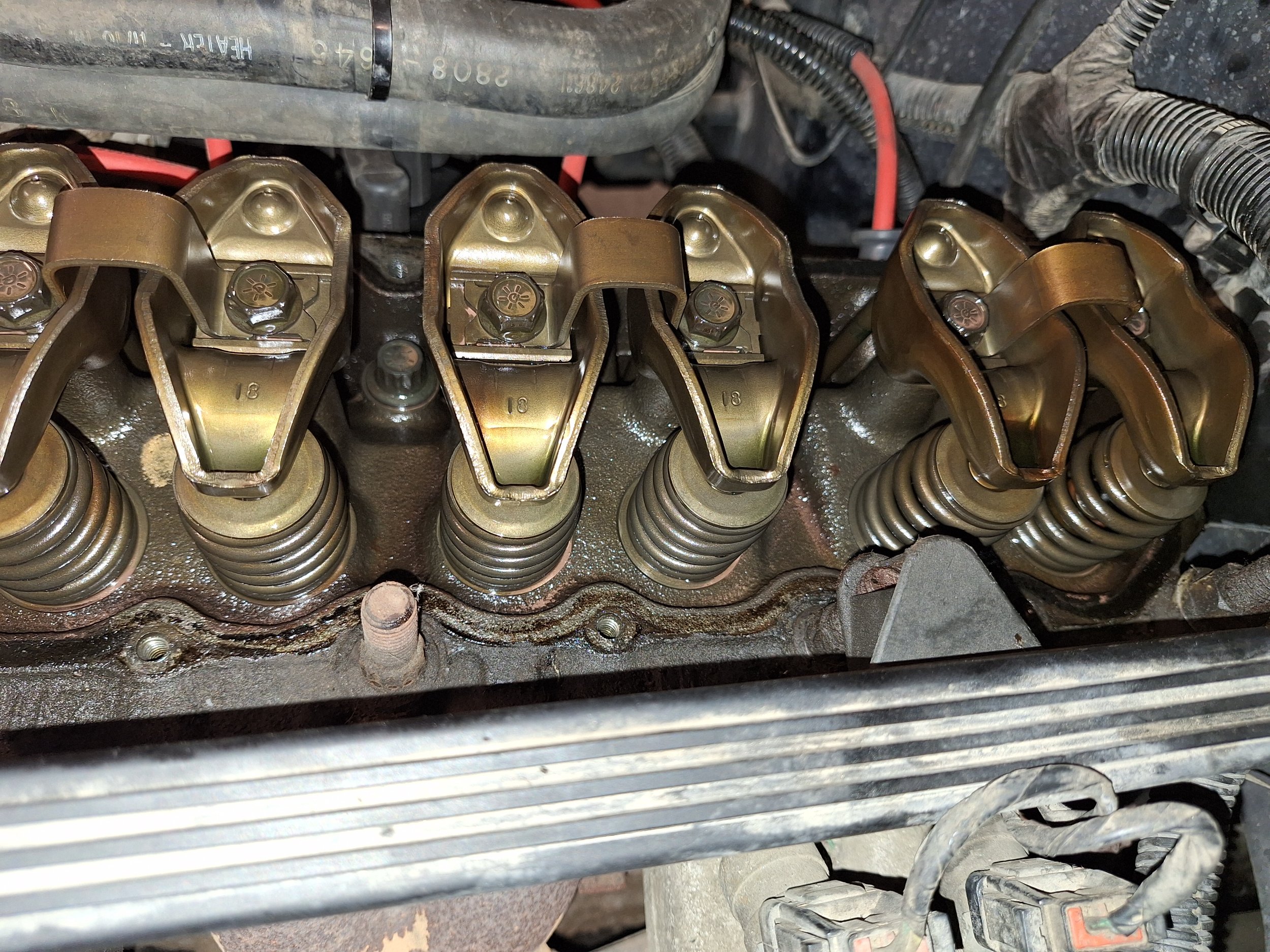

Moving on to the top end - Valve cover is off. Valve assemblies look very clean to me, especially for 240K miles. Maybe they were replaced at some point? Nothing catastrophic is evident, based on my limited knowledge of these engines. With the lifters on the cam base circle, I can rotate all of the pushrods. Nothing is loose when I wiggle the rockers. I guess as a last ditch effort I will replace the lifters, check to make sure the pushrods are straight, and check the rocker assemblies for obvious wear.

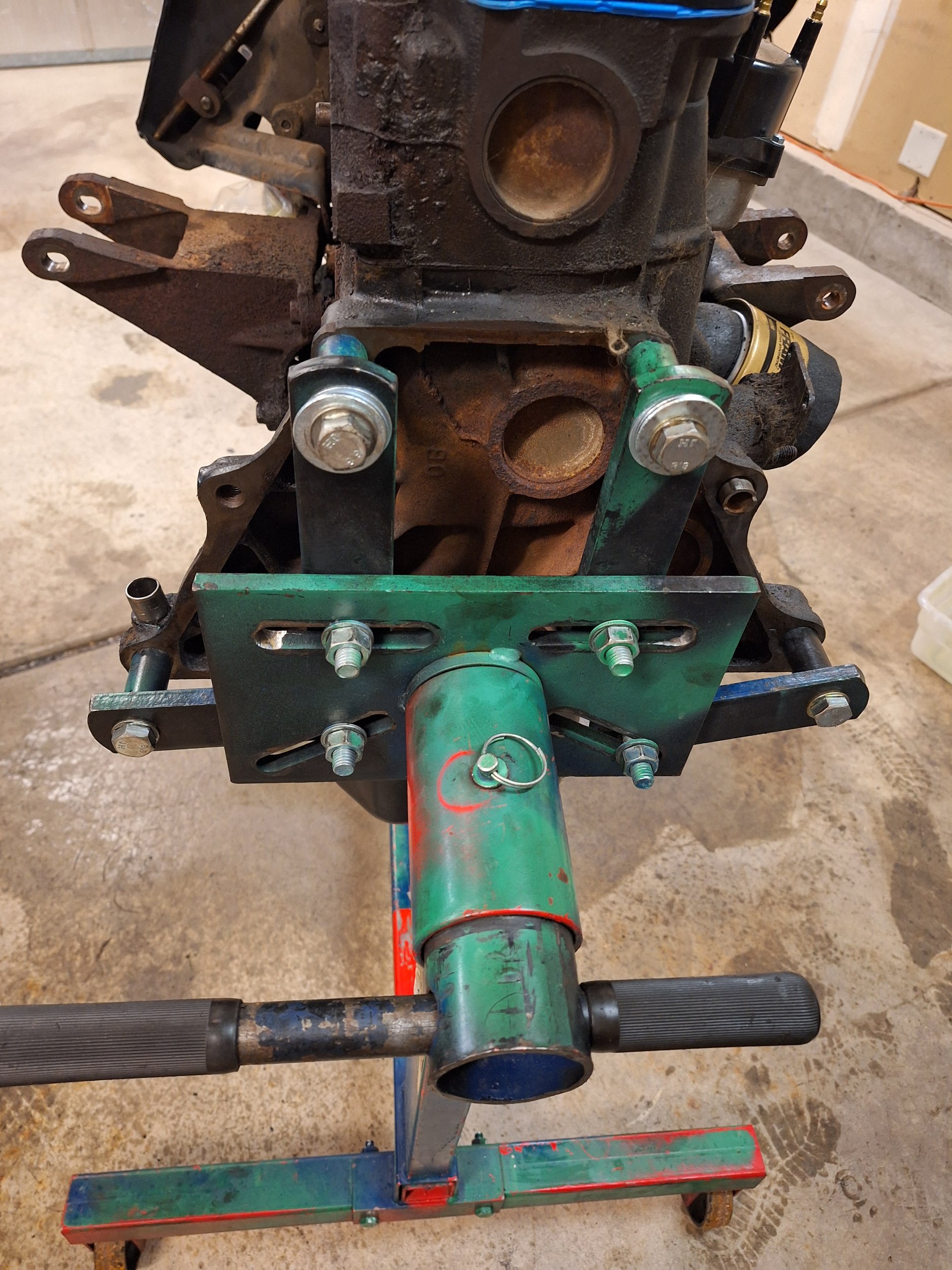

Got the engine out late last night; thankful for talented friends willing to help. I had M12x1.75 80mm bolts to mount the engine to the stand, which were a good length for the bottom two holes but needed some washers to fit the upper two. Also, the driver's side bottom bolt hole in the engine skirt had an alignment sleeve in it to align the engine and trans, and it took quite a bit of convincing to get it out (Liquid Wrench for the win, after heating with a torch).
