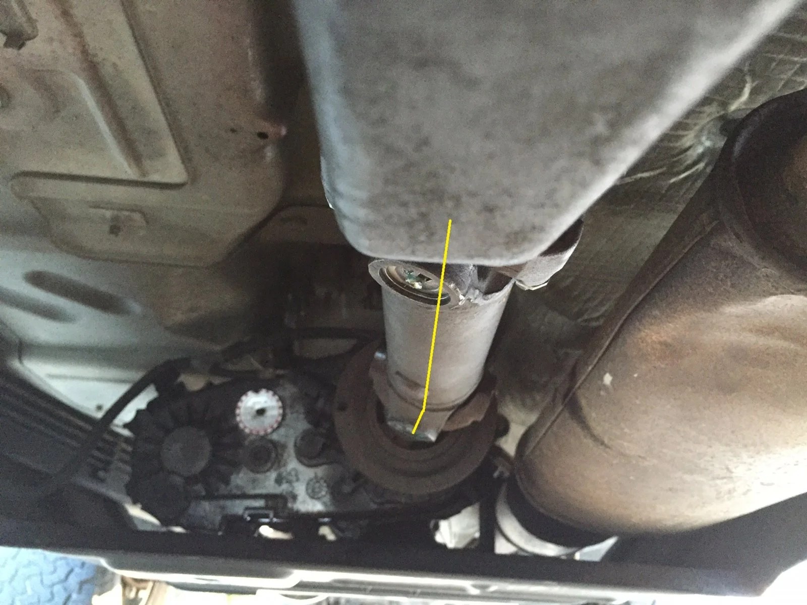

I don't have a suspension lift. Only a body lift. Here is a picture. It's difficult to see, but I tried to illustrate/exaggerate with the yellow line to show what I clearly see when I look from the rear axle to the TC output shaft.
When I put the yoke level I can also see more space on the right than on the left of the u-joint. The yoke is not exactly level, but the red arrow indicates where I can see more space than on the other side. I was hoping it was just an optical illusion.
