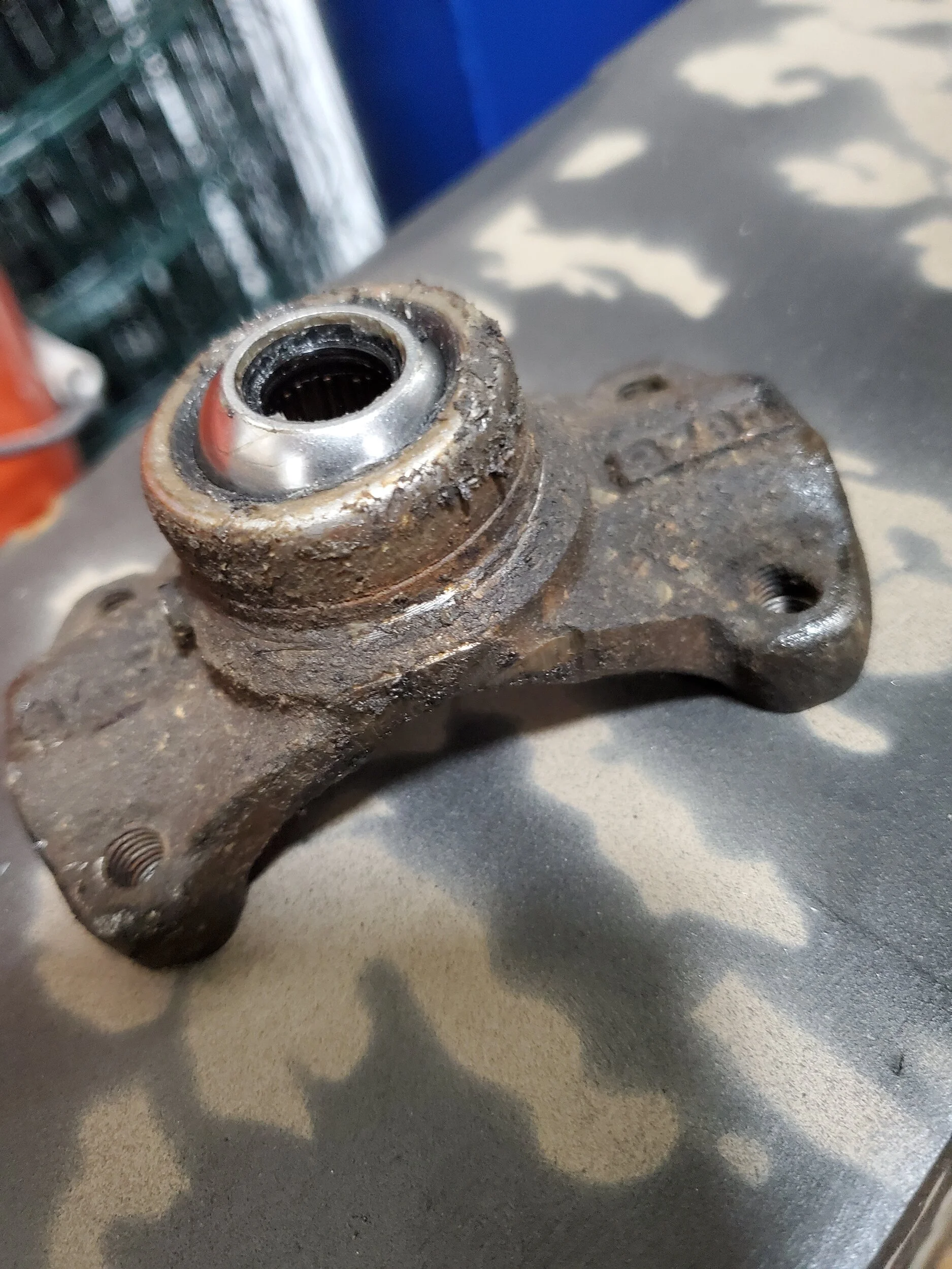

The Drive Shaft Dust Seal (p/n 2-86-418) does not fit. The seal is slightly undersized to go over the driveshaft. It fits the centering yoke just fine. I didn't want to press it on as it isn't doesn't appear to be close enough in size. I looked at the original, and there was no dust seal installed. Possibly someone before me had the same issue.
Has anyone encountered this before?
here's the original

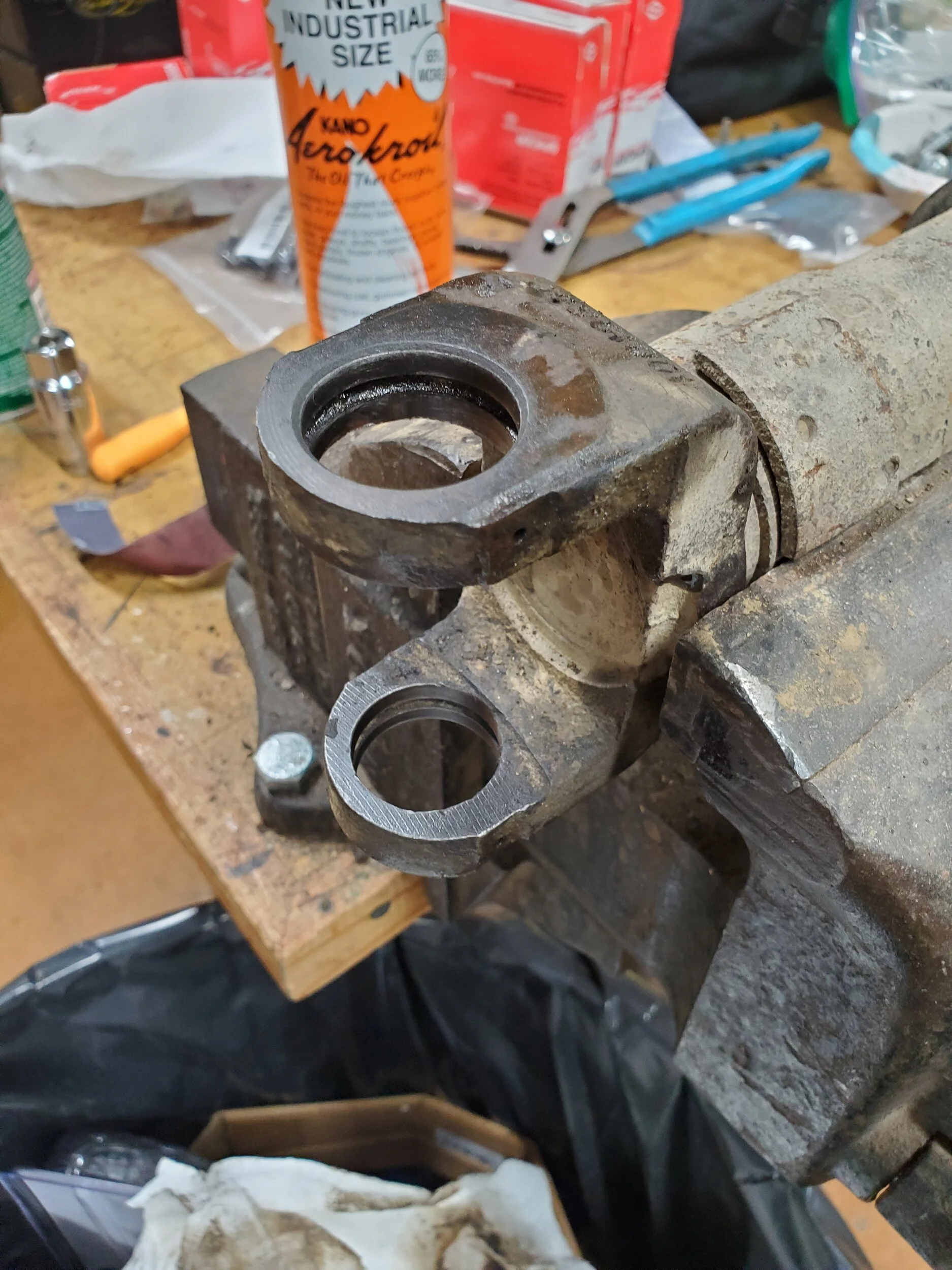

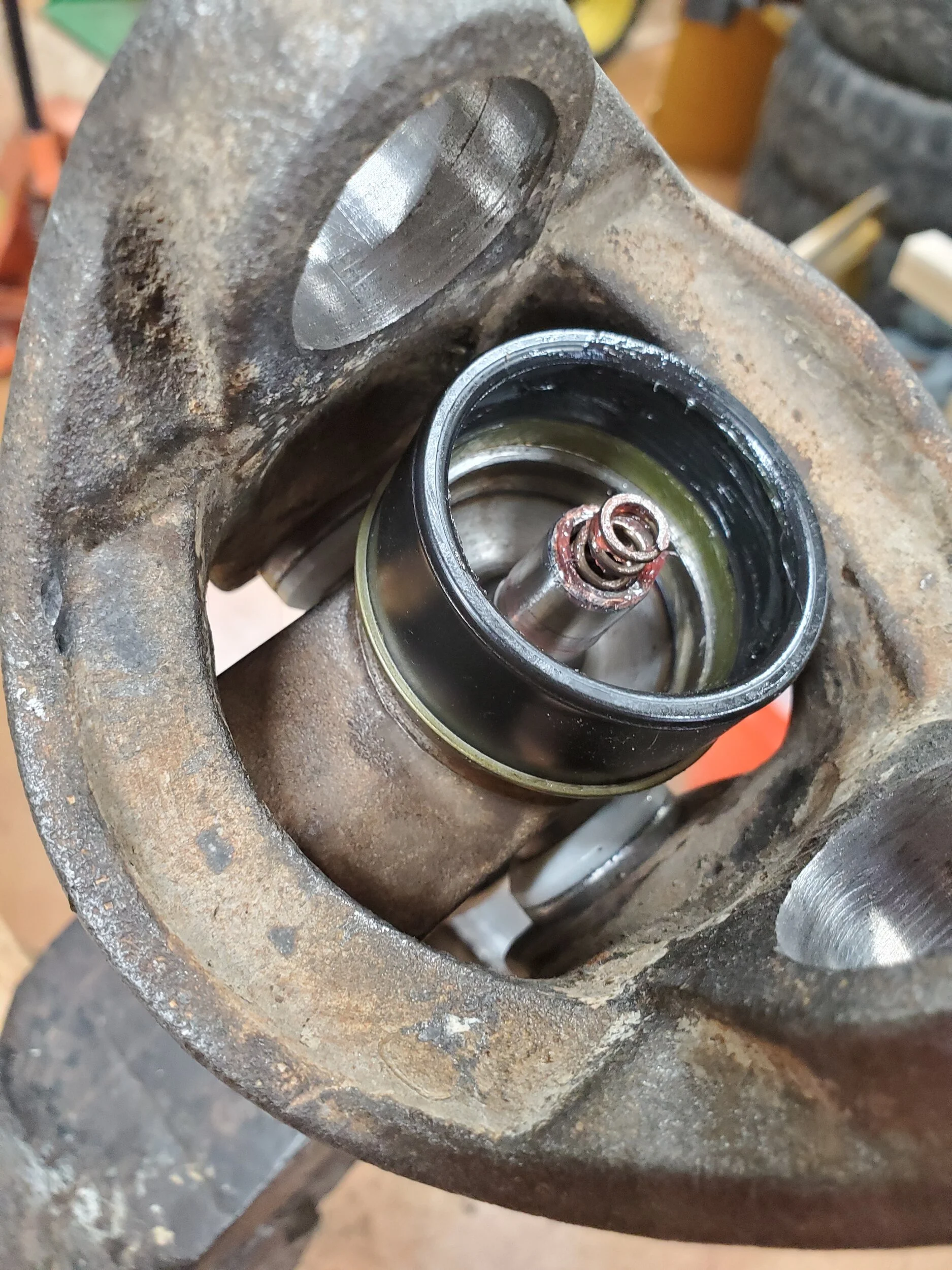

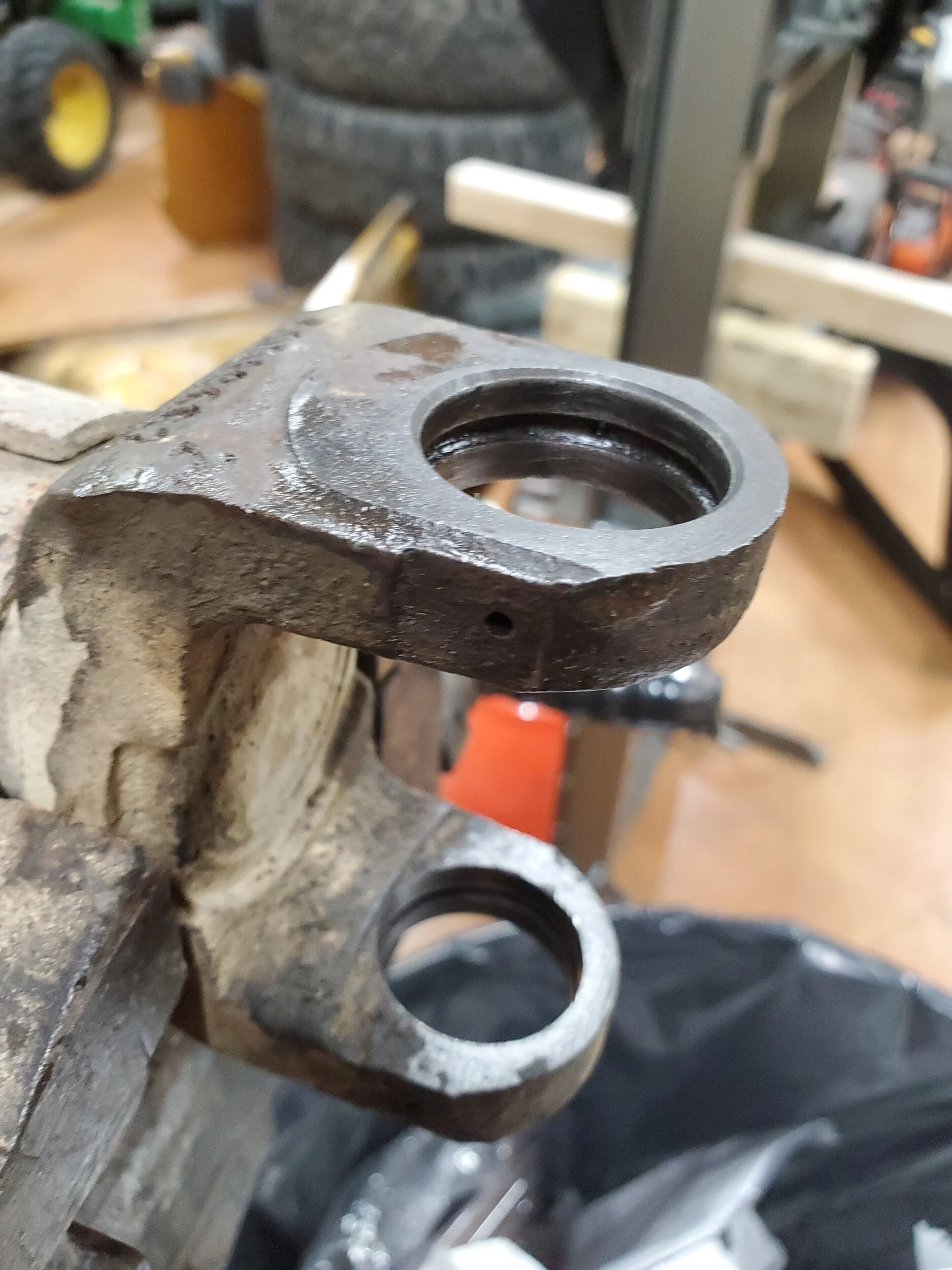

On the axle end of the driveshaft, the ears have a groove in the center with two holes that allow dirt and water in. It does not appear to have broken zirks in the holes. Why did they do this? Should I plug the holes with some RTV? I went ahead and installed the new u-joints.
A lot of the Rubicon shafts used the old style greaseable centering flange so the parts you purchased will not work. I recommend if the centering flange is needing repaired to replace it with Spicer 211179x.
As for the pinion joint that is a Saginaw style ujoint and caps were originally retained by a resin that was injected into that groove in the yokes. You do not need to worry about it just make sure the retaining rings are seated properly when you install the new ujoint.
