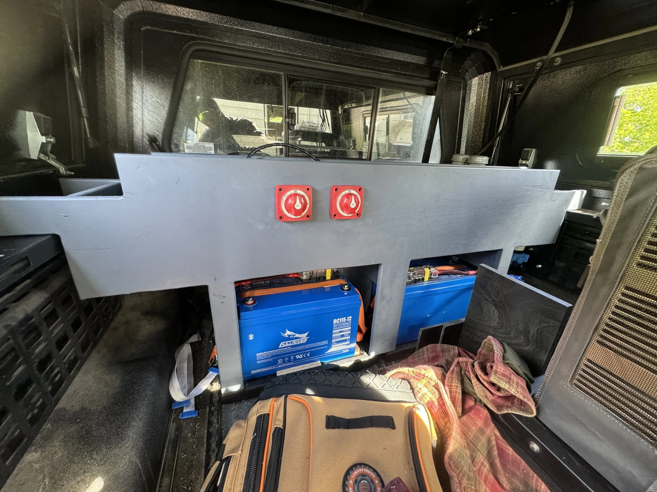

Here's a dual battery setup with 3 batteries total..
I think the question to answer for yourself is how serious you really want to get. Jackery/goalzero/others are a great portable option. If you want something permanent and onboard you'll want to first do an energy audit to see what you actually need, which will help determine the size needs of the bank. Then you also need to consider if you want lithium or AGM. There are pros and cons of each. An on board system is much more complex but is a 'no touch' system more or less, and if using AGM (which is what I have always done and will do to the TJ and LJ) you can self jumpstart if needed, if you wire it the right way.

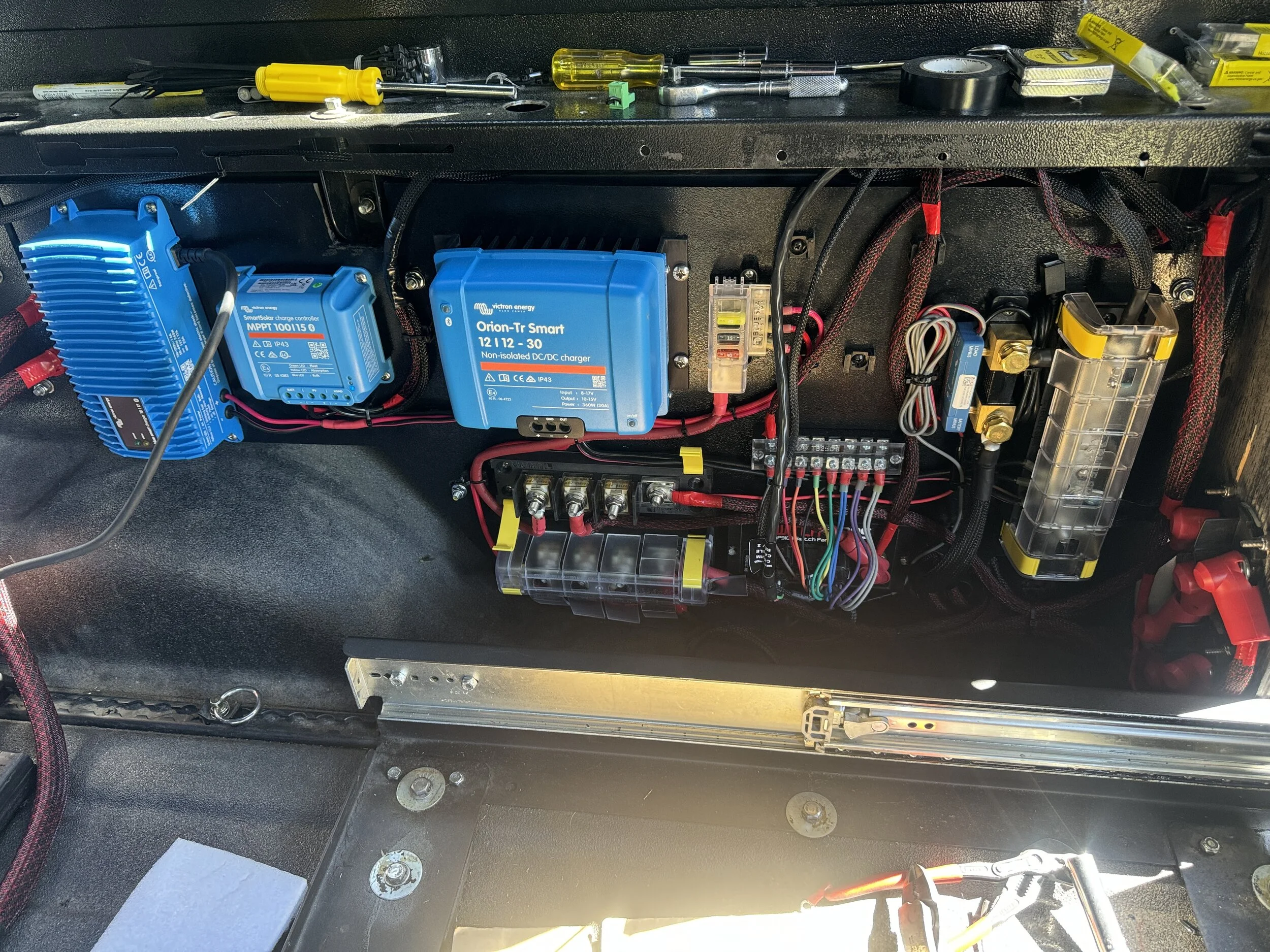

Here is a photo of the unfinished electronics portion I had on my JT, of course this doesnt include the items everything is wired to.
In this system each battery has its own shutoff. There is also a blue sea selector to allow the 'house' system to run on purely the in bed batteries, or the underwood battery - if say I was doing battery maintenance and had to run to the store for frozen goods. It also allows redundancy and the ability to hook all 3 batteries up together for a long hard winch pull or self start, etc....... Then under the hood was the Genesis controller which was an added step - but in short you would want an auto disconnect so that using your camping stuff like a fridge doesnt accidentally drain your main vehicle battery.
