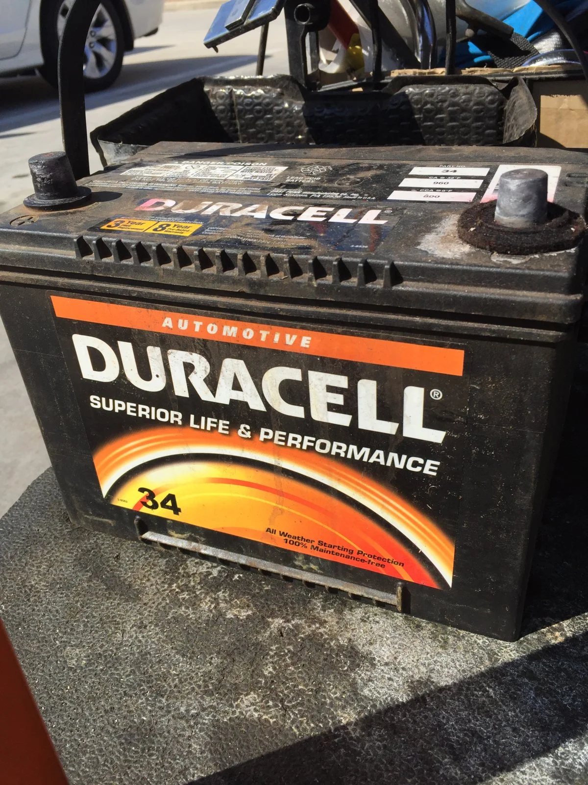

Last week the Jeep wouldn't start. No clicking, nothing. I tried again a few minutes later and it started right up. Weird, but okay.
My wife went to take out the Jeep last night and it wouldn't start. I tried again, nothing, and it wouldn't start this morning either. I hooked up some jumper cables and it started right up. I couldn't remember ever changing the battery since we bought it in July of 2012, and in Florida batteries don't last very long so it kind of made sense. I've also added a winch, so it was probably time for a new one anyway.
I can't tell you how many times I've been under the hood, and even changed the terminal connectors and all of the wires and never actually noticed the brand of the battery.
Who the hell knew that Duracell made auto batteries?? Certainly not me.
For those wondering, I replaced it with a Duralast Platinum which is an AGM battery.
