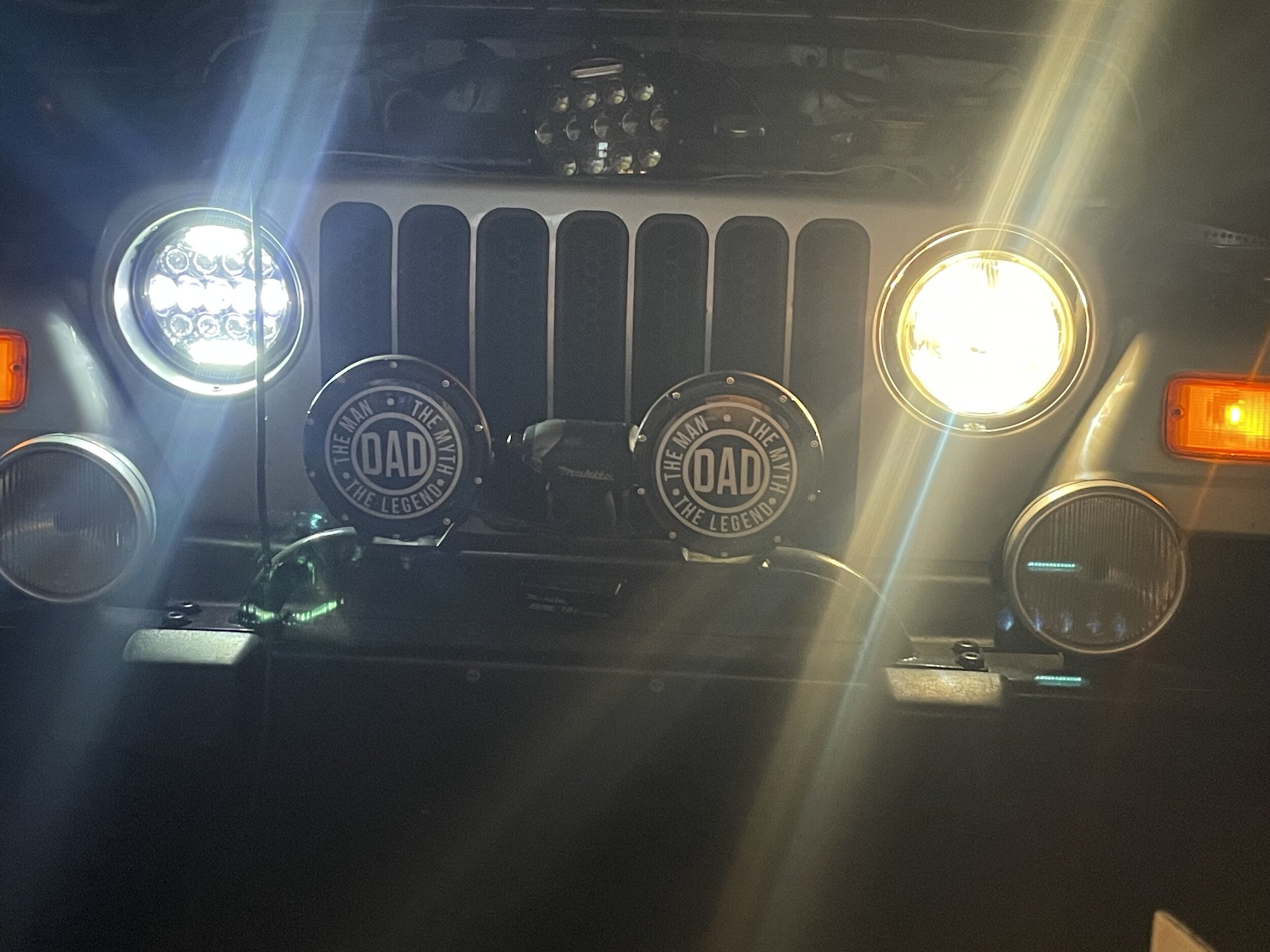

So this is what they look like with “city light” using a led as a DRL- below is old LED on the passenger new e-code on the driver.

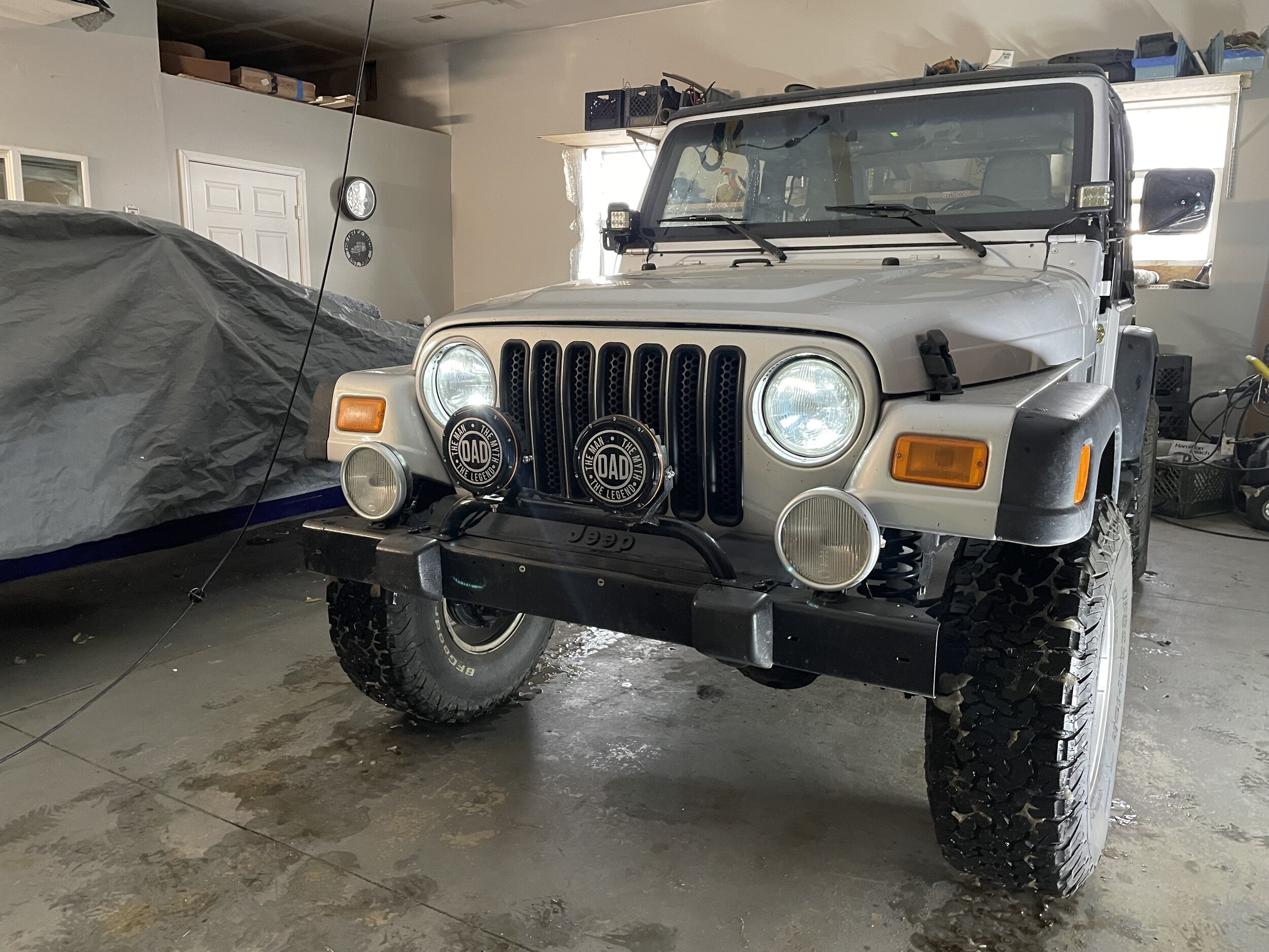

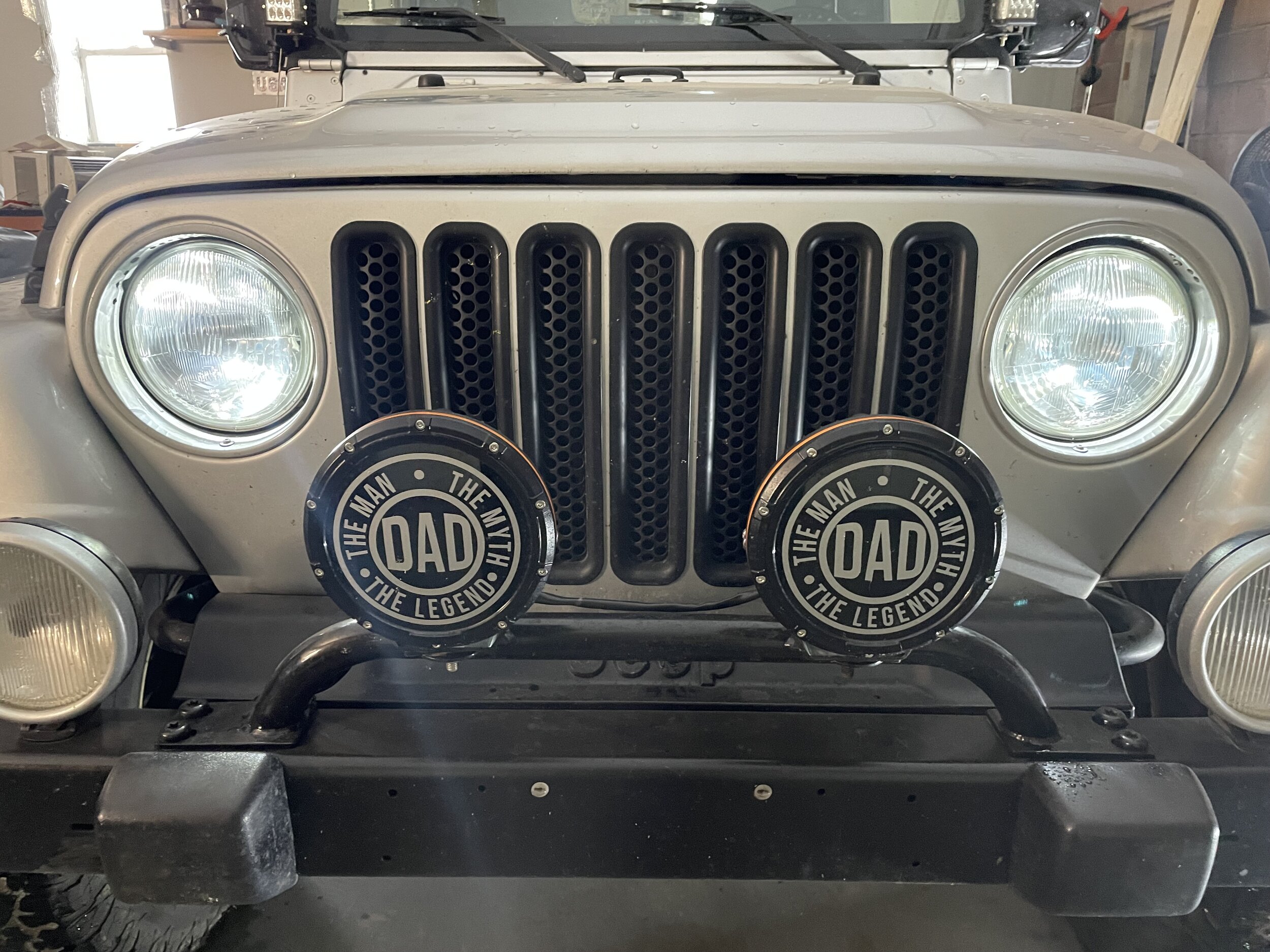

One thing about these e-codes is that the glass is curved vs flat if that aesthetic feature appeals to you And come fully loaded with the all the bulbs for $60/pair. Fair price in my book. I just swapped in the led which you can also get in other colors if that is your jam. I was tempted to try amber but I have seen green & red too…it’s basically a #53 bulb socket.
Typically you would have drilled a access hole for the city light but the TJ has the room already to clear it.

That looks nice. Though about getting them at one time.
Does the city light stay on when your headlights are on?
What did you wire the city light too?
Thanks! I pulled power from the under hood relay block. one of the unused socket supplied me a key on power source. So the city light remains on when headlights are on or off.
