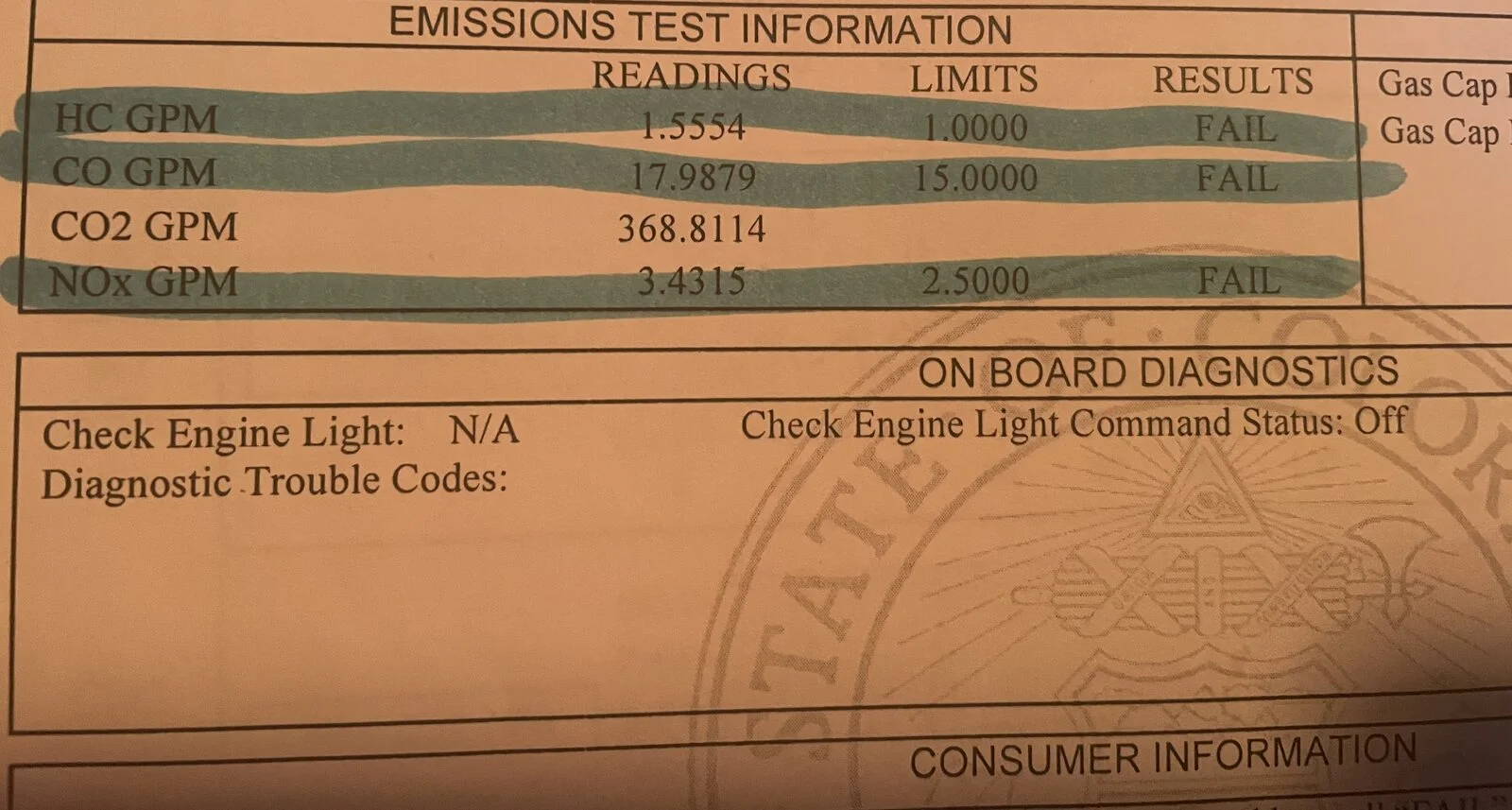

I'm hoping to get some ideas for what is wrong before I have to take my 97 2.5L in to a mechanic. Been trying to pass emissions since June. Here's what I've replaced: both 02 sensors, CCV valve, evap canister and evap purge solenoid. I put some of the gumout in and ran through a tank of gas, then changed the oil and filter. Checked the plugs, they looked fine - plugs, wires, distributor cap and rotor were all replaced 3 years (about 15k miles) ago.
Second test, after the EVAP fixes, my CO was well within levels. This morning, I'm back up to over. No idea what's been going on.

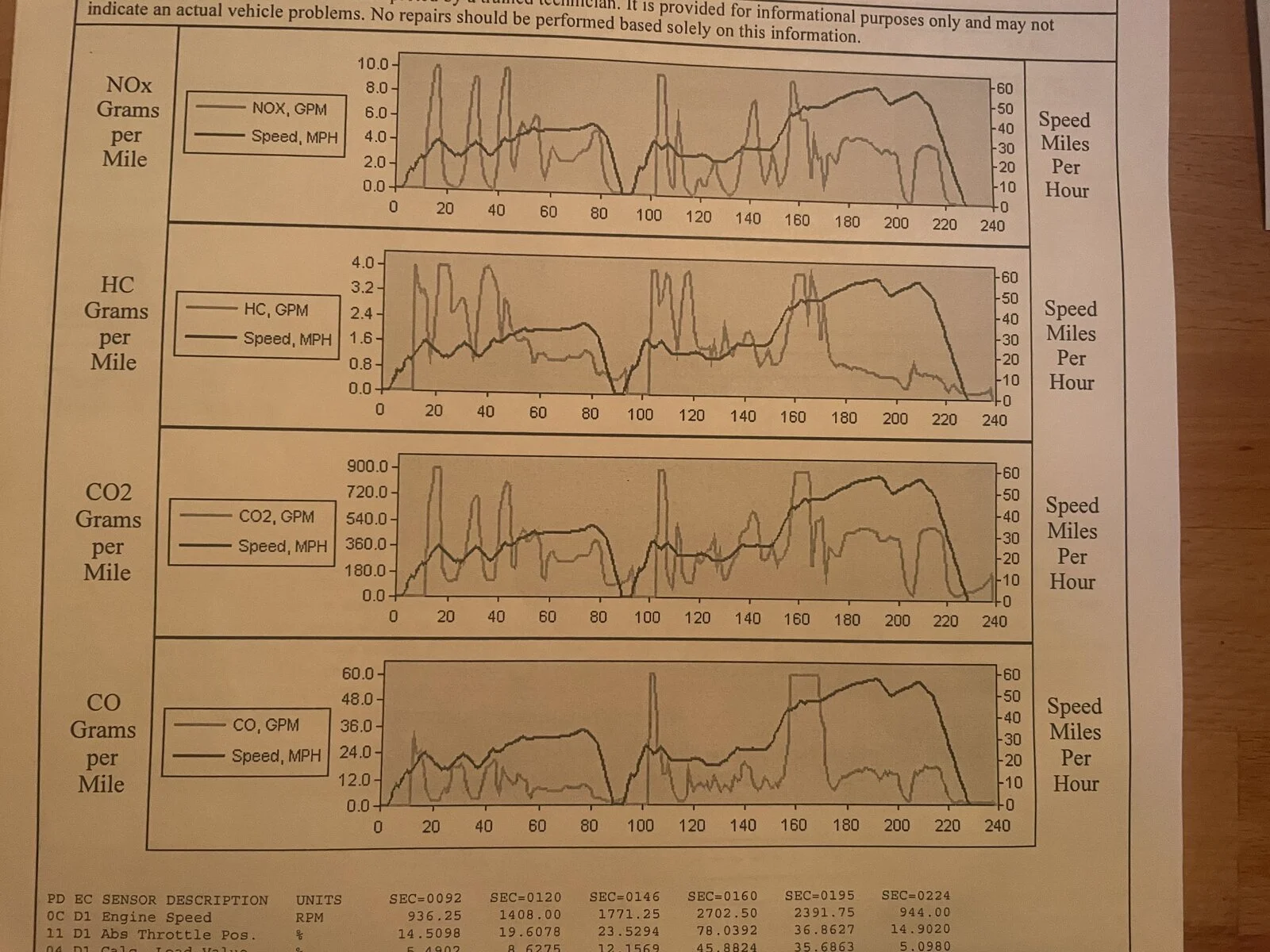

Just took my third test - before going in I drove on the highway for 40 minutes and had inflated my tires to 35 PSI. Still failing. I have the readouts - it looks like at times the emissions levels are fine, but then they spike a bunch. Could this be a bad MAP sensor? Maybe someone here can give me some ideas.
Here's the data:

The big red arrow pointing at the cat can't get much bigger. Modern 3-way cats control hydrocarbons (HC), Carbon Monoxide (CO), and nitrous oxide (NOx). If you're failing all 3, you can pretty damn well rest assured the problem is the cat.

In case this helps anyone else: it was the cat. Replaced the thermostat and failed, almost identical numbers. Took it in to a shop finally and the mechanic told me he thought it was most likely the cat. So, with that replaced, I went and passed emissions. So if you're in CO and failing on all three, it may be time for a new cat.
