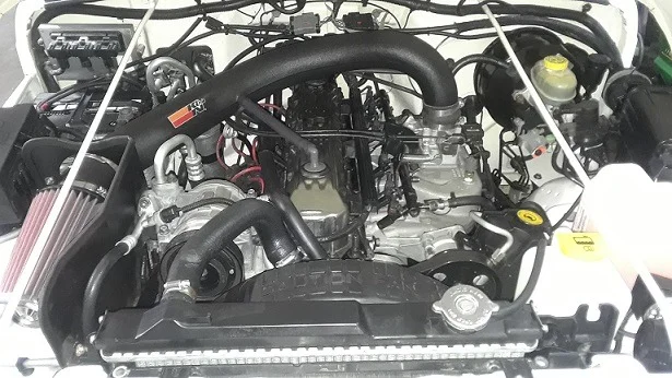

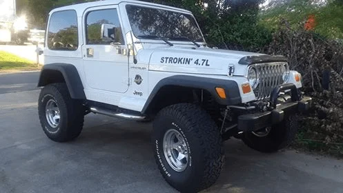

I'll have my brother take a picture of it pulling the front wheels. I figured with 4.88 gears I'd be stuck at no more than 70 MPH on the interstate. But 5th gear on the AX15 trans has so much overdrive 70 MPH is only 2700 RPM.
Wow, that's a clean engine compartment! Very nice. (y)
As a side note, I would consider going back to the factory air intake system. It has been shown (over and over) that the factory system, with a good quality filter, far surpases the air cleaning ability of the "cold air intake" systems with no degradation in power. The 4.0 just does not require it nor benefit from it.
I'm fairly certain that the RamAir system that the PO installed on my 2001 was the major cause of the engine's demise. You've, no doubt, invested a good amount in your stroker and I would hate to see it destroyed by grit for no gain.
I appreciate what you are saying and generally agree. However, the company that built the 4.7 long block with an aggressive camshaft, stronger crankshaft and larger Chevy valves with stronger springs recommended the cold air intake to compensate for those changes plus the header, 62 mm throttle body and 24 lb. Mustang fuel injectors. The engine is approaching 300 hp and requires the extra air.
I do keep the filter clean and oiled as is required and this TJ will never see off roading again or even rain for that matter unless it is a total surprise. I am thoroughly preparing it for car shows and I am currently working very hard with a chisel, sander and other tools as I remove undercoating and add Hot Rod black semi-gloss paint to the frame, axle housing, etc. to make my 20 yr old Jeep look new in all areas.
Up until a year ago we would be on the same page. Thanks for the compliment. I could not find a polished stainless steel valve cover or even an aluminum one without the 4.0 on it. I stripped and sanded all of the black paint off, polished the hell out of it and added a couple of clear coats to protect it. I'm pretty obsessive and possibly a little anal retentive.

Wow, a show Jeep. How cool! I'd say that's a rare thing in the TJ world.
Reactions: HarleyMick
You know, after 20 years I think my Jeep deserves a thorough spruce up and by their criteria is exposed to a crowd not normally associated with Jeeps of any kind. I hope to win a trophy or two showing people a glimpse of what our world is all about by making it look like it's virtually brand new. They will also see the full functionality of the 6 inch lift, heavy suspension, 35" X 12" tires and of course the power of a vehicle designed to be fun on and off the road.
