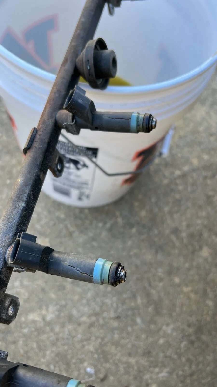

These are what my fuel injectors look like... I know I know... They are probably toast. lol.

First, they're probably still fine and good to go. But if you decide to replace them I'd stay Mopar if you can find them, but at least avoid believing the claims of things like "better atomization" made by those pushing aftermarket 4-hole injectors. I'd go Mopar or Bosch for fuel injectors, avoid store brands.

100% - I was thinking of buying these from Precision Fuel Injectors - they look to be rebuilt OEM. A set of 6 goes for $129.99
