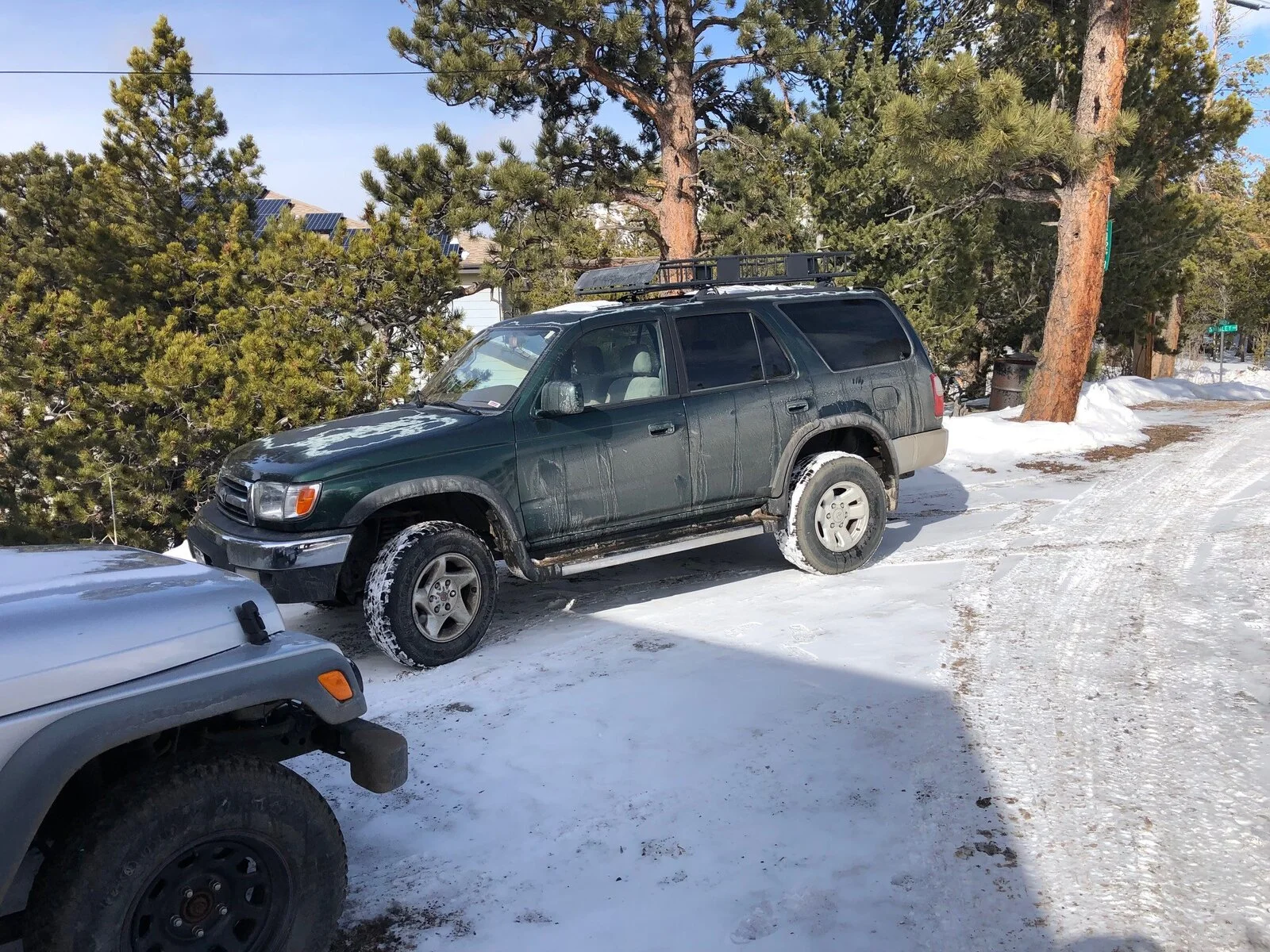

So my grown daughter bought a 99 4Runner , we gave the once over and I found the rear drive shaft was wasted , ( centering ball was toast and the DC joint had a 1/4" run out.
Bought a new shaft and installed it for her , No issues drove great. However on snow packed roads in 4wd the front end would pull one way then the other under power.
In 2wd it drives great no pulling or steering issues at all. Doing a dry steering test the only movement is the steering rack bushings let the rack move 3/16" side to side.
If that is the issue would that only effect the steering in 4wd? I haven't seen anything like this it is extremely darty in 4wd and perfect in 2wd. Thoughts ????

Pull the front diff cover. Is it possible the "open diff" is binding intermittently when in 4WD.
I suppose that's a possibility , but Toyota's don't use a D-30 straight axle. Your not dropping a cover your pulling the whole axle assy. out then splitting the case. Spinning the front driveshaft doesn't feel weird and and both front wheels are powered. Thanks !
Solved ! I decided to go ahead a lay in the snow when it's 15F. to Figure this out.
What I discovered is the front axle is a 4.1 ratio ( what the 4Runner was built with ) , But someone installed a 4.3 ratio rear end.
After running the numbers about a million times , I found I could stagger the tire sizes enough that it drives fine in 4wd.
Running a LT225/75R - 16 on the front and a 265/70R - 16 on the rear gives me enough stagger to equalize the ratios !
Doing the math it is within 6 rpm at 60 mph.
This is good news for by broke daughter and son in law. It drives perfect in 4wd now.
