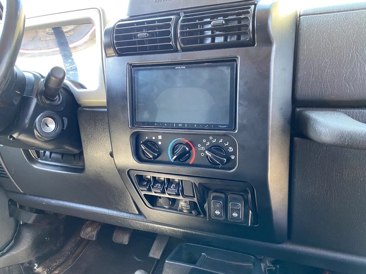

Looking for switches that resemble the factory ones so i can keep the dash as close to factory as i can. Has anyone used and had luck with the ones in the link? Adding some KC lights and want to make use of the blank spots under the AC controls. I have an auto so i already have an OD switch. But three blanks. The switches would operate the relay hopefully.

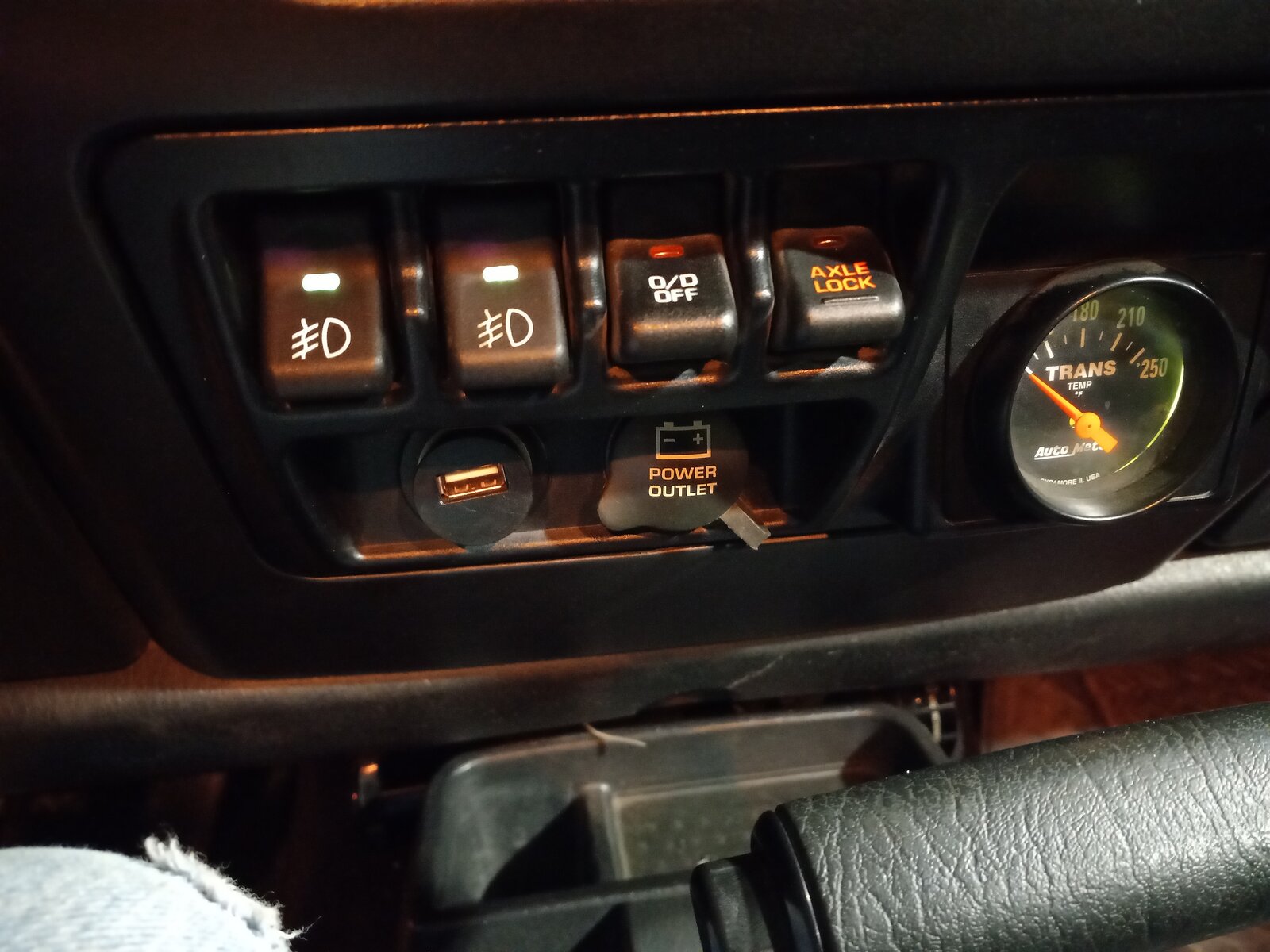

I used those switches, mainly just the switch cover, in conjunction with a couple OEM switches (after slight modification) so the logos would light up.

I have those switches, they work great and power the relays fine. The light comes on when switched on. I added a small bulb inside and soldered onto the board so they illuminate with the interior lights at night. Explained in the thread below:

I had read the prior thread, I figured they could light up but if they didn't it wasn't a deal breaker. I have three of them; Rock, Zombie, and Spotters and they all light up now. Probably didn't take more than an hour to modify them, hard part was getting all the little parts.
