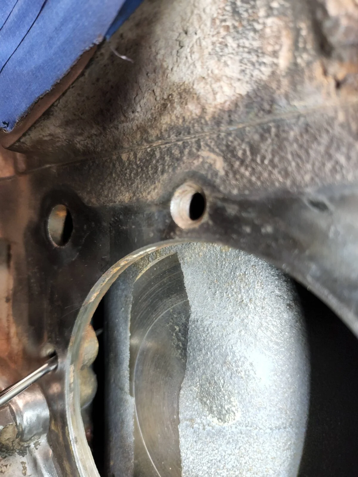

I currently have my water pump off the engine. It's an '05 LJR with the original 4.0 and looks like the original water pump. One of the water pump bolt holes goes all the way through into the water jacket. It's the one on the passenger side. All the other bolts seem to go into blind holes but not that one. So, shouldn't that bolt have some type of sealant on it? Will I not have at least some seepage there without some sealant on that bolt? @mrblaine, what say you?
The FSM is silent on the question. One YT video shows a guy globbing massive amounts of teflon sealer goop on all the bolts. It looked like there was some sort of sealer on the factory bolts, some yellowish residue.
Plumbing type sealants and teflon tape are really intended for tapered pipe threads which a bolt is not. How about blue Loctite( since I have some)? Would it seal and hold with the heat and pressure?
I'm guessing there is a product designed specifically for this but I don't know what that is. If that bolt can magically prevent leakage without any thread sealant, please tell me how that works.
I know this is an old thread but I'm having trouble finding accurate info on whether or not the water pump bolts need sealant or not. And what type of sealant is best if it is needed. @Jerry Bransford answer above seemed the most definitive but I have have some reasonable doubt for a really solid reason.
We never put any sealant on that bolt but if I was worried about it, coating the threads with some good RTV wouldn't be the end of the world.
