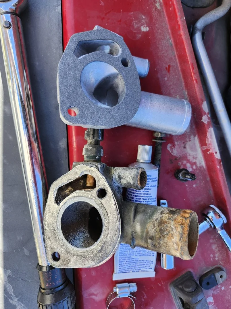

ok, heres is where I am. I went and got the correct Thermostat, and I decided on a new housing, AND two gaskets AND Permatex gasket maker gooey stuff.
I pulled the old housing and the wrong stat, it was a 180° stat.

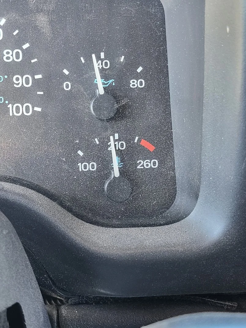

Drilled a ⅛" hole in the flange of the new 195° stat and installed it, and the new housing. The only thing I should have done is replaced the sensor. I used the old one.😭 It still works, so no biggy. I torqued the blots down to 18 Ft-Lbs, I figure two gaskets would require and extra little tweak of the wrench, Ran the engine for 15 minutes or so, and the temp gauge is just below the 210 mark, exactly where it should be. No runs, no drips, no errors ~~~ so far.

The Wobbly Jalopy is back on the trail and as good as ever.
