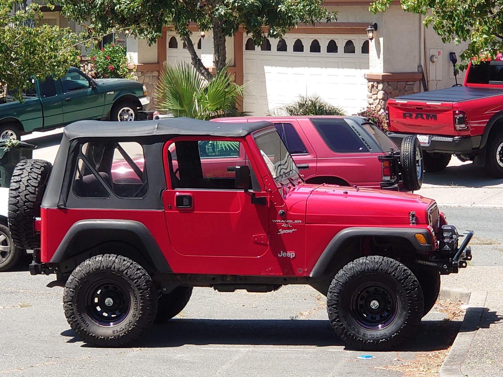

I just bought my dad's 2001 TJ Sport. He moved to a retirement community up in Medford, OR and decided his 84 year old legs were tired of climbing in and out of the TJ.
He and I used it to explore all of the trails around Yreka, CA, Mt. Shasta, etc, where he lived for 30 years. He kept it clean, maintained and garaged since he bought it new. It has 48K miles on the clock and no rust at all.
Of course, I can't help myself and took the stock TJ 4.0 w/ 3sp auto and 3.07s and added a Currie 4" lift with DA upper arms, F / R Currie track bars, Front Antirock, SYE, Tom Woods CV shaft, 33x12.5x15 Patagonia M/T-02s on 15x8 steel wheels , Dirtworx rear carrier, Rockhard OR front bumper, Badlands Apex winch (was running out of money at this point), and a decent stereo....
Next up is a regear to 4.11s and some armor. I am trying to decide is I should go find an old Dana 44 to build, use a Super 35 kit or just buy some built axle. Seems like by the time you build an old axle, a couple grand more will get you a brand new built unit from Currie, ECGS, or other. Don't know which way to go and will never run more than a 35" tire. Since I don't have lockers, I'm likely going to just wheel it as is for a bit. When I do go lockers, I was thinking Eaton E-locker in back and maybe just a Detroit in front. Not sure the best way to go.
