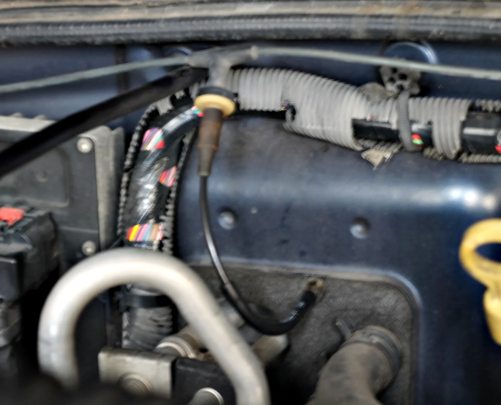

OP Adam, I have the exact same short stub as your pic. Did you ever complete a satisfactory repair, and if so could you show a pic?
Help is appreciated.

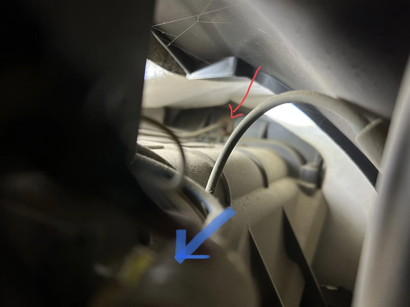

I looked at my Jeep today and removed the glove box you can see where the line comes through. If you push the grommet through carefully you can make a repair inside the vehicle then use a stiff wire or welding rod to pull it back through the firewall then carefully reseat the grommet. If you run a new nylon line you may be able to plug it into the vacuum harness connector located by the fuse panel. If you splice to the existing nylon line with 3/32 vacuum hose I usually spray the end line with a small bit of brake or carp cleaner right before I push the rubber hose on. This will melt the line a bit and glue it to the rubber hose so it won’t come off.
In the picture the red arrow is where the vacuum hose comes through and the blue is where the vacuum harness connector is.
Thank you, excellent advise and instruction. I got off easy this time. Took one more shot at pulling the small hard line out enough to make a hose splice, the broken end line popped out of the firewall hose/grommet. It was stabbed in to about ¾" (I had thought it was a solid line). Made a splice with hose and restabbed, vents working.

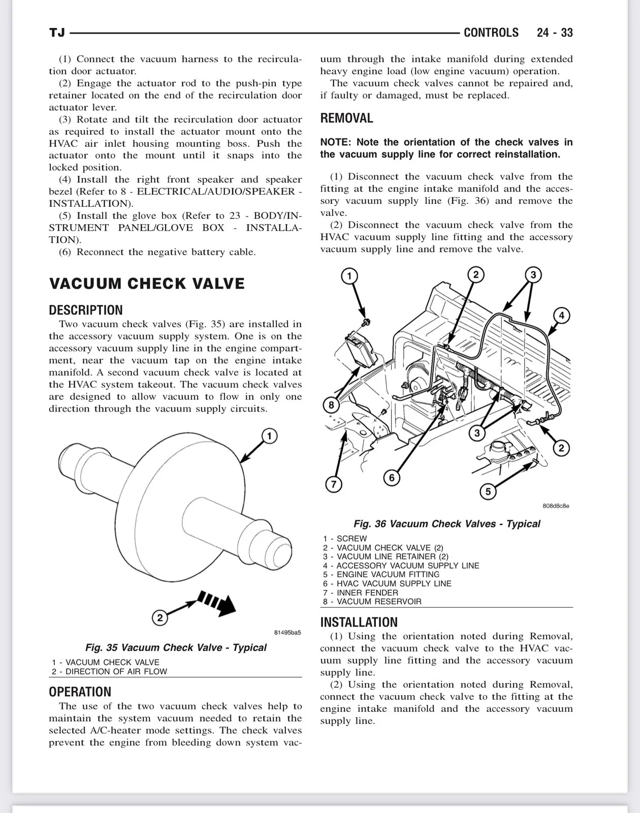

Glad you got it repaired, I was going to say the check valve is in the wrong location but I checked the service manual and it seems Jeep used two check valves in the system. Here is the page.
