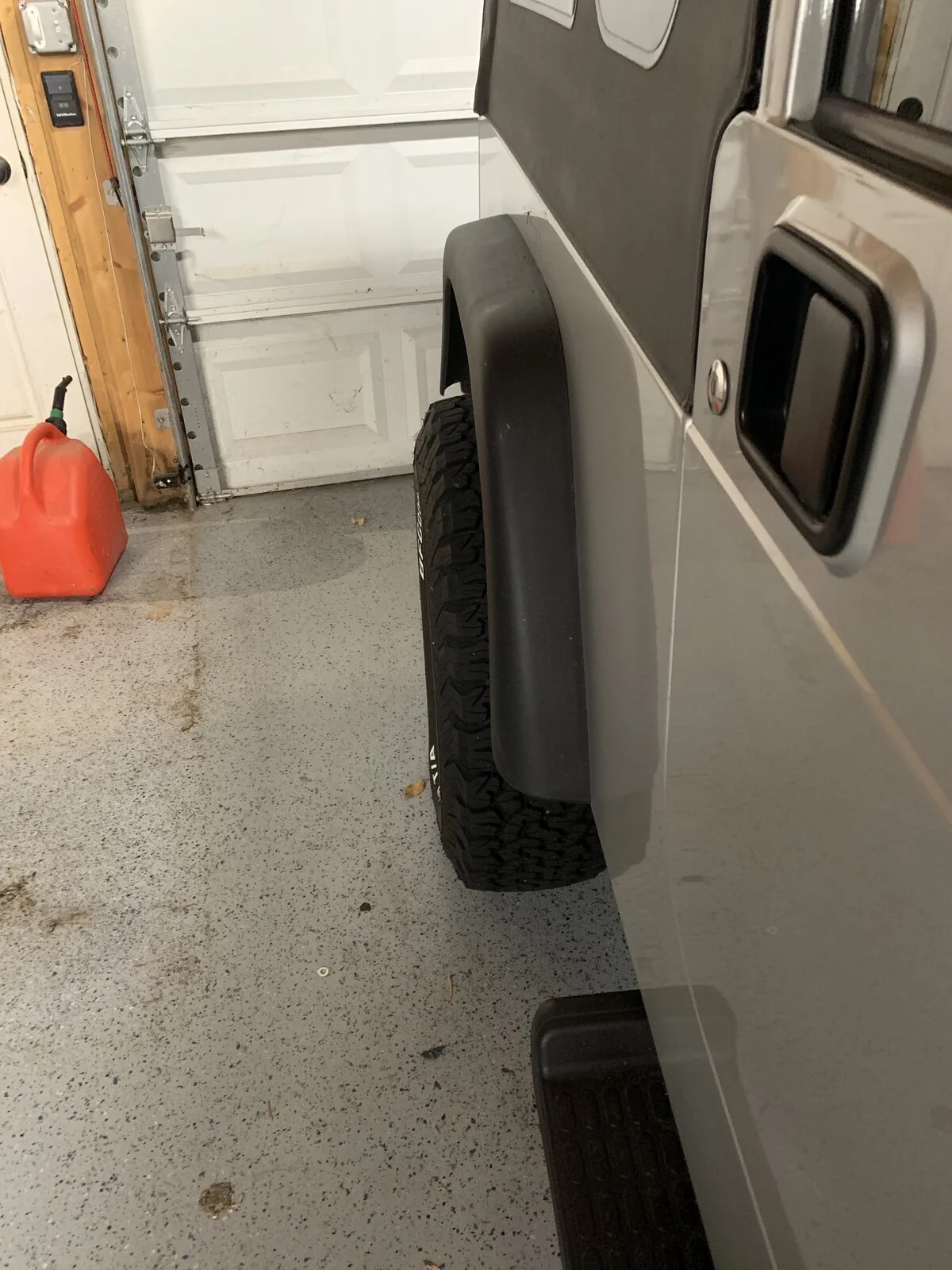

Post some pictures of your current setup

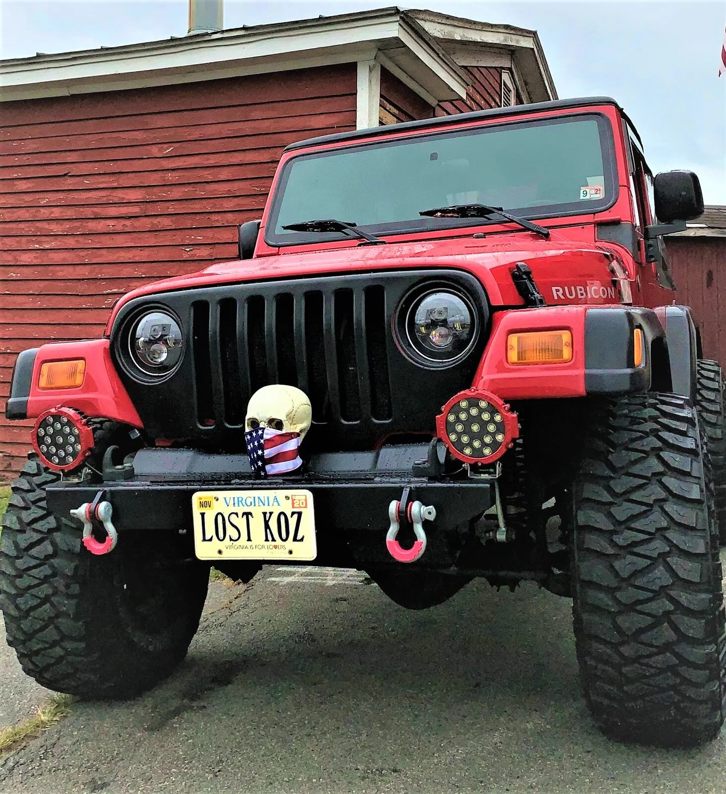

I’m kinda glad my tires stick out a little bit. I don’t have a Rubicon, but these are Rubicon flares. I don’t know how much yours are sticking out though.

Pics?
Moreover...
Rubicon/Sahara/RM flares are 4"
Non Rubicon are 3"
That said...
Did you get 10" wide wheels with 3.75-4.0 BS?
15x8 with 3.75 BS is out past the flare about an inch or so. Not ignorantly so but they are beyond the flare.
15x10 with nearly the same BS would definitely look obnoxiously past the flare
