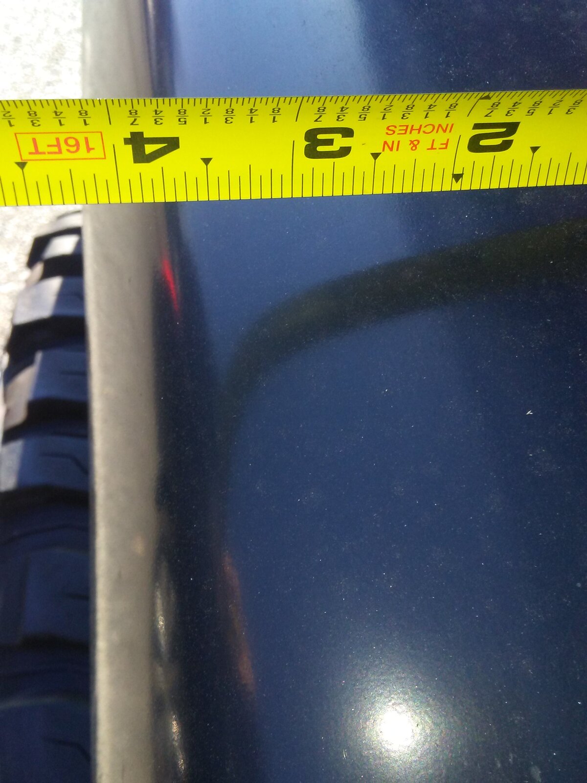

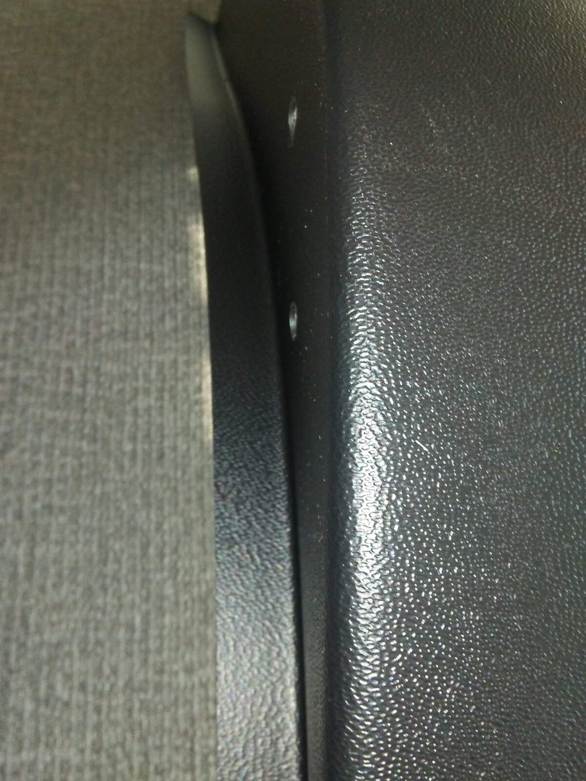

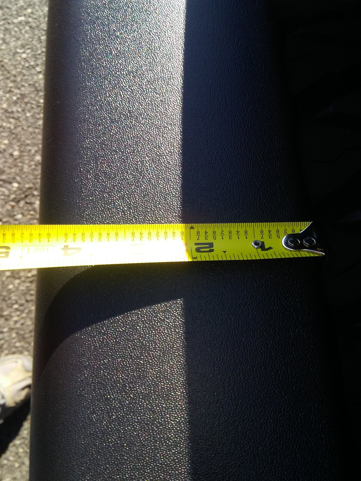

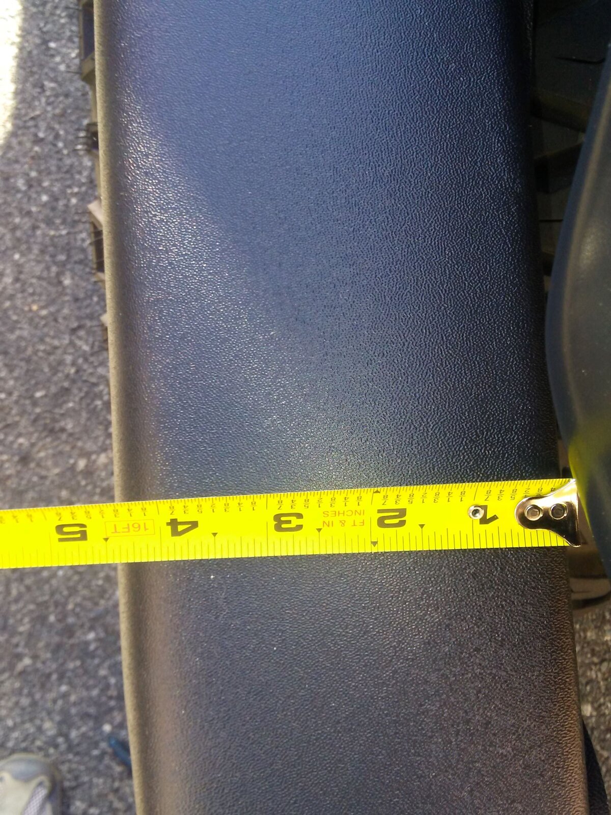

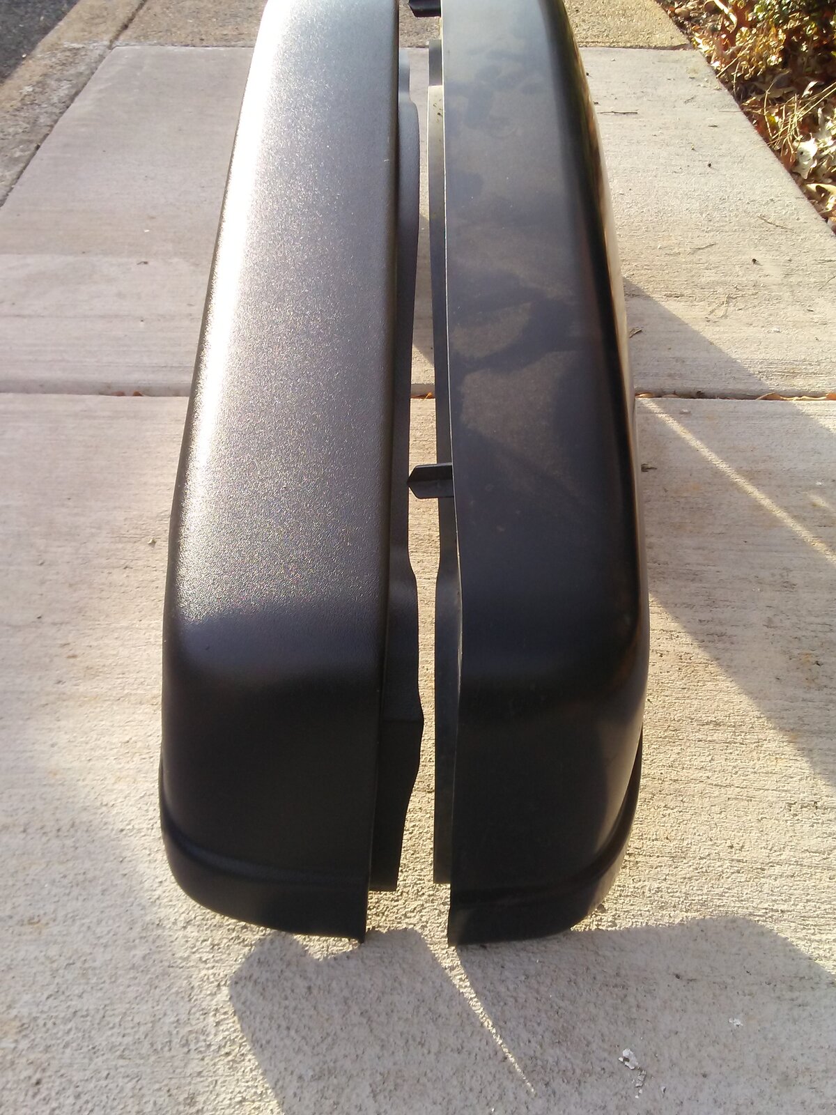

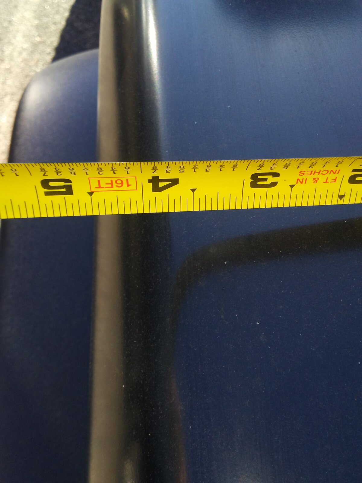

If anyone is looking for Rubicon width replacement flares and can tolerate the RC logo, get their 5.5" flares. I ordered a set to get the extra 1.25" width. They are the exact width (not installed). The Rubicon flares measure 4.25" at the top but flare out at the bottom. The RC flares do not measure 5.5" wide, unless you count the lip that goes underneath. They also do not flare out at the bottom. Just my 2 cents.

awesome! thanks for posting! I suspected this or something similar (that the 5.5 vs 4.25 isn't apples to apples) may be the case, as I indicated in the other thread where this was discussed.
Now I just gotta decide whether I want the textured finish or if I want to hold off for painted OEMs.

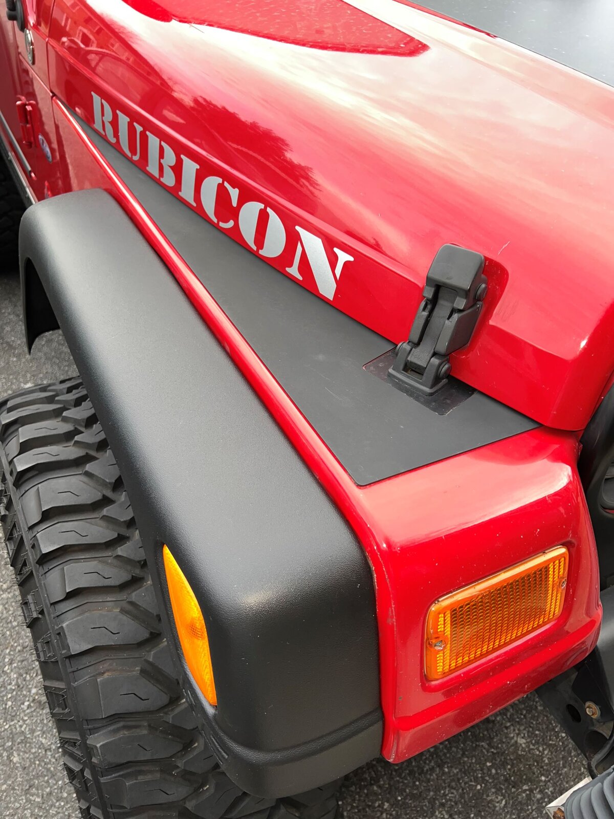

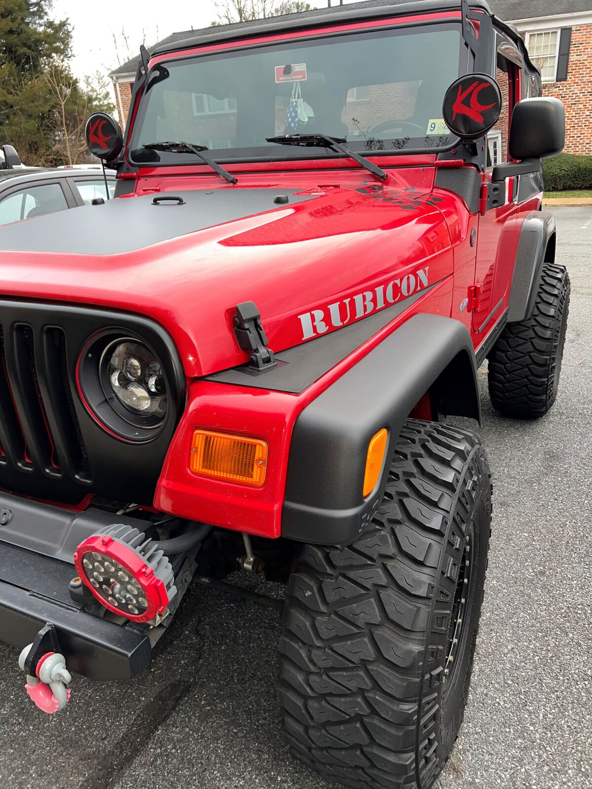

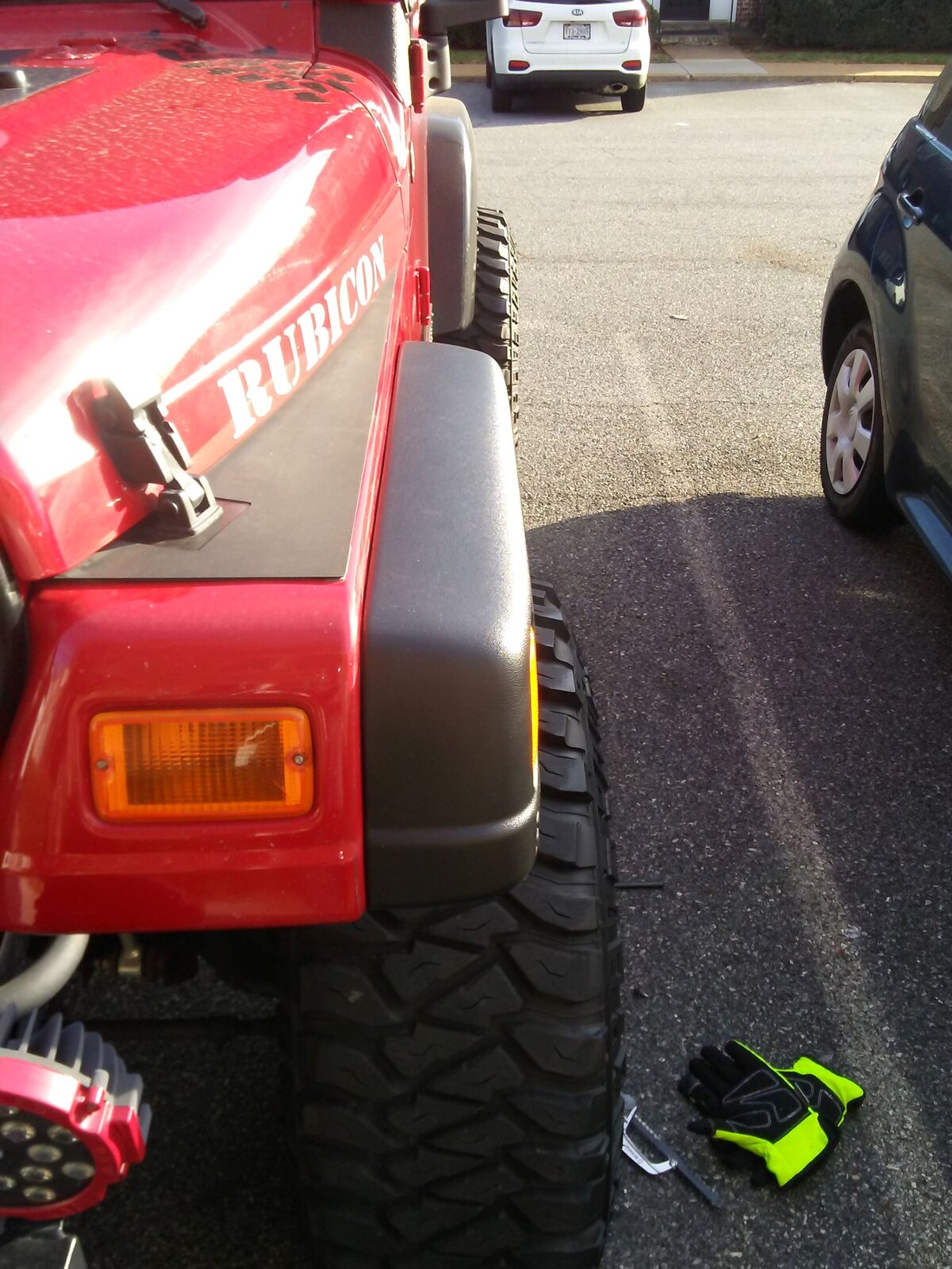

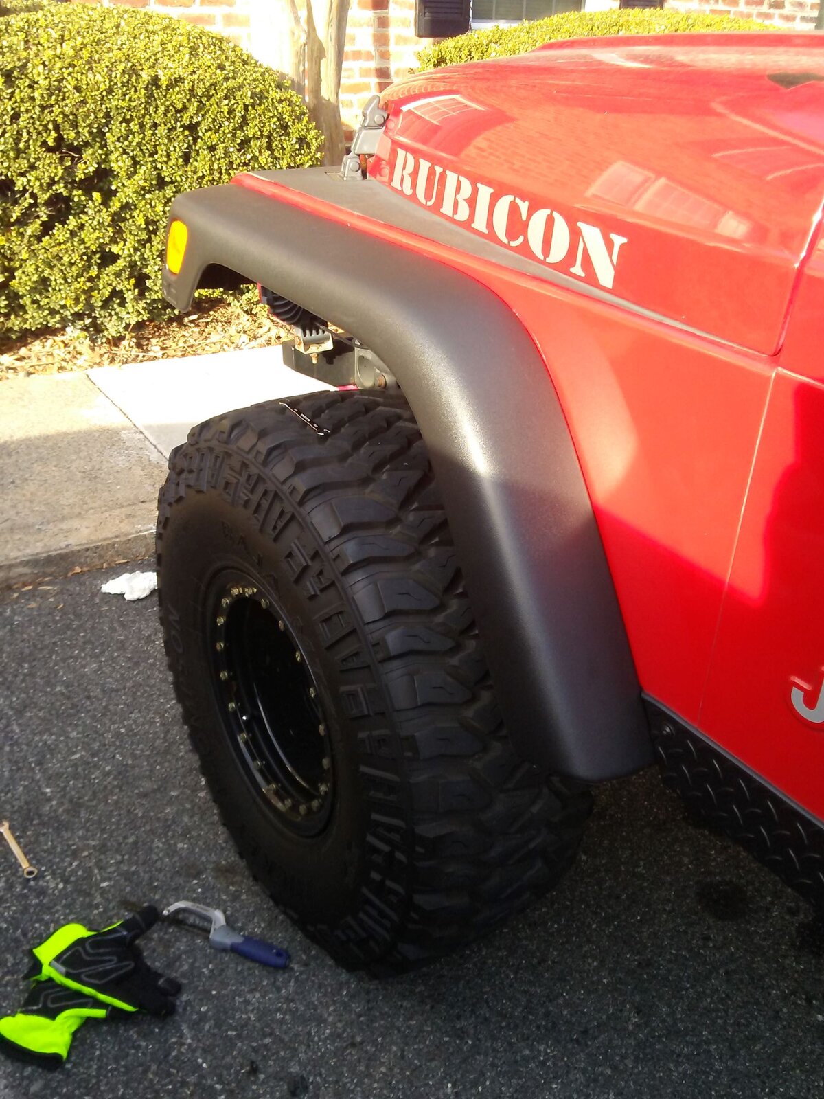

Finished the front flares with my screwed up rotator cuff shoulder injury. Might take a week to be pain free to do the rears. Spinning nutserts caused an issue with taking longer than they should have. Comparison pics to Rubicon flares for anyone interested.
I had read your first post to imply you only wanted the extra width and wasn't going to install them since they aren't any wider. Change your mind?
