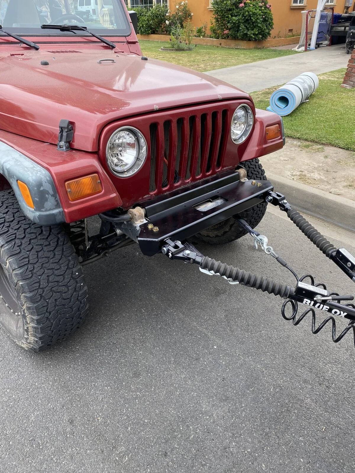

This is what I did,I use a roadmaster all terain w/blue ox ends

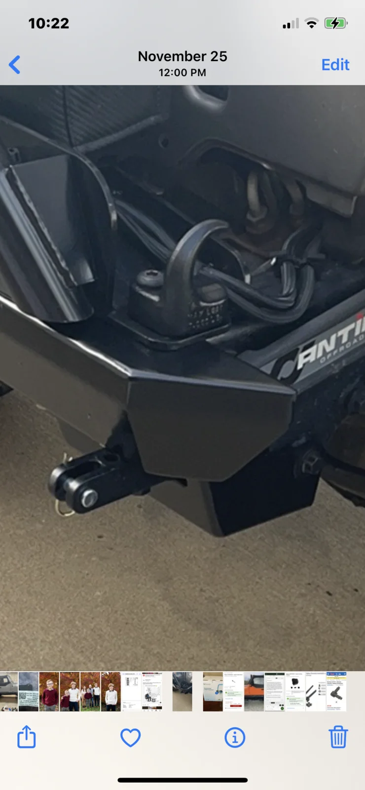

This bumper came on my jeep when I bought it, I should have said.
In that case I inspect the welds closely and go with what you are comfortable with. Inspect it frequently when traveling for good measure. If you plan on doing a lot of towing I'd invest in a better system.
We don't go much further that a couple hours away usually. Might use it once a month. I'll check the welds out.

After reading the reviews of people that have actually used that Hooke Road bumper for winch and recovery, I wouldn’t trust it for flat towing. Just my $0.02
