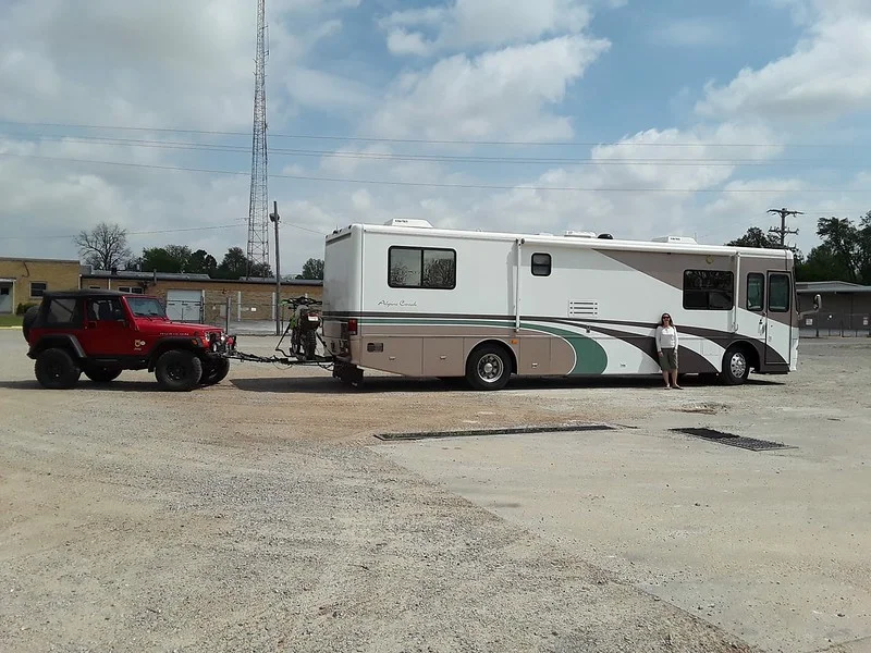

I use a Ready Brute Elite tow bar. It has surge brakes. The brakes on the jeep are activated by cable. The install was simple enough that I felt comfortable doing it at home. I also have a break away cable (costs extra) that would stop the jeep if my tow vehicle and my towed vehicle became separated. I would not consider towing a jeep without both braking systems. You can get the Ready Brute with ends that fit the Blue Ox tow bar. I had a local welder make the brackets that I bolted onto the front of my Jeep (Warn bumper with a winch). My lights are wireless magnetic mount lights. I much prefer this to modifying my Jeep's wiring harness.

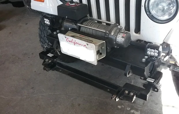

I installed the tail light harness you linked. Has worked just fine for me. I mounted a 4 pole round trailer plug in the front of the grill. I run the Falcon 2 tow bar, but recently bought the brackets to hook directly to my aftermarket bumper d-rings. I have the Roadmaster cross bar that bolts to the frame for sale if you decide to go that direction.
