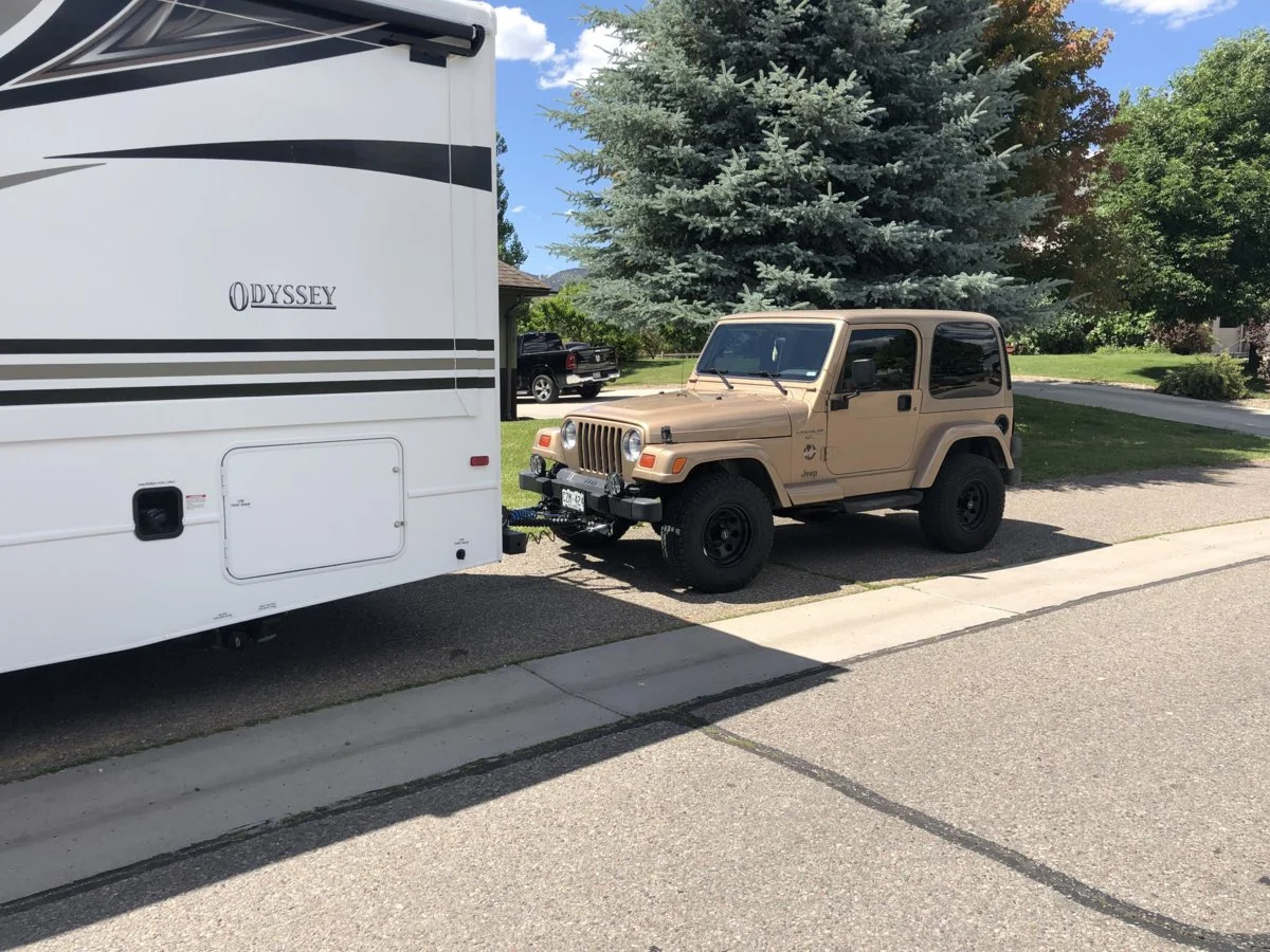

I flat tow my 99 TJ behind my RV.
I ordered a Blue Ox Patriot 3 braking system. I need 12V power to run it.
