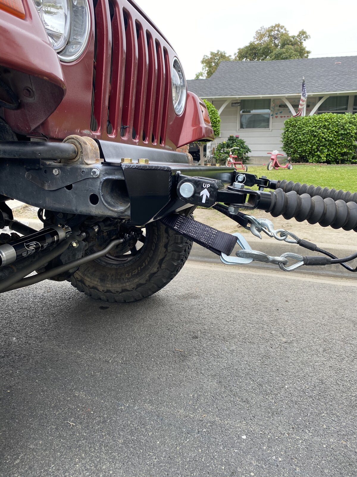

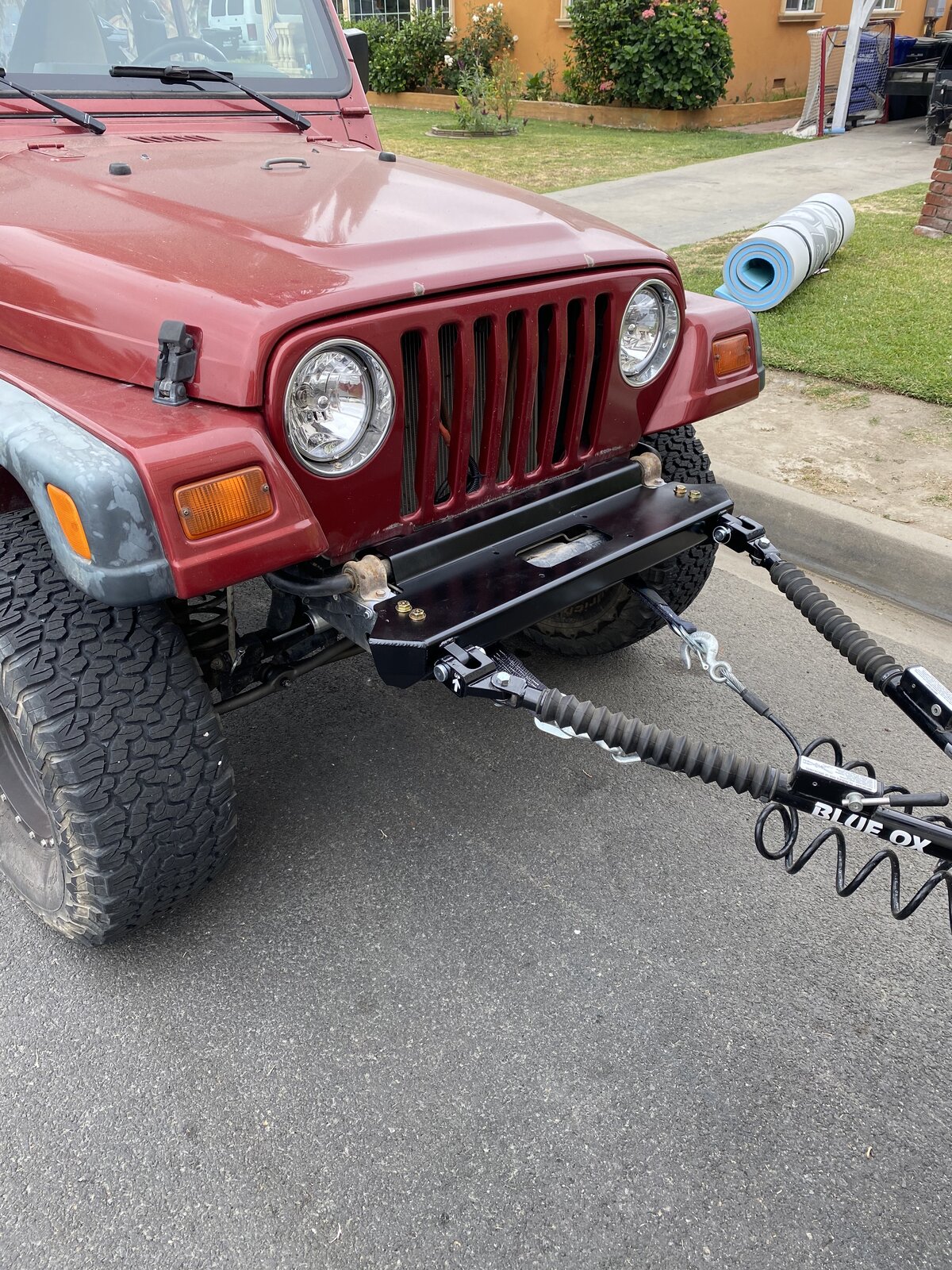

We flat tow our TJ behind out motorhome for trips to river and also off-roading trips. I wanted to get rid of the crappy welded on mounts and install a new Genright Steel Stubby bumper. I did a lot of research for flat towing / bumpers just wanted to give an options for those in my boat.
I know that the Genright bumper is not rated to flat tow from the tow mounts, but I will be constantly checking mounts and bumper for issues. Just finished a 400 mile round trip from Downey, CA to Pirates Cove resort with no issues.
Here is the set up I used.
- Blue Ox tow bar
- Blue Ox tow bar off-road bumper mounts
- Genright Steel Stubby Bumper
- Axle Straps wrapped around front cross member (under brake lines)
- Harborfreight magnetic tow lights.
Here is the previous bumper and weld on mounts.

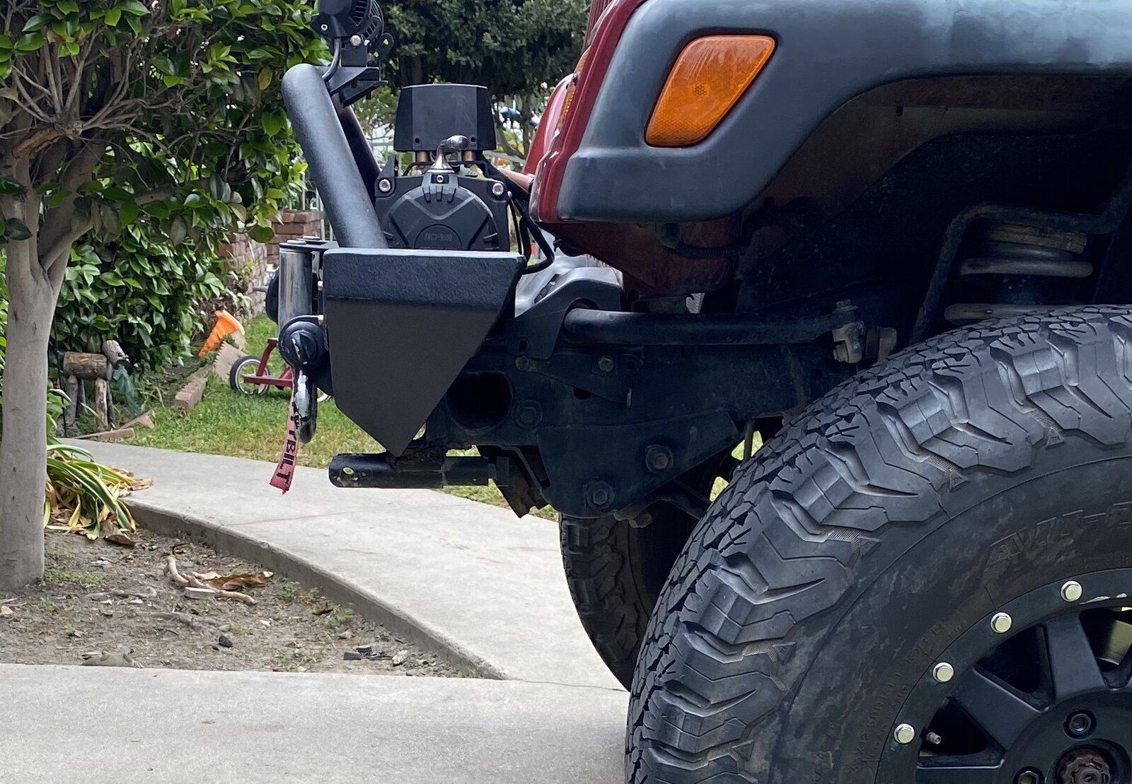

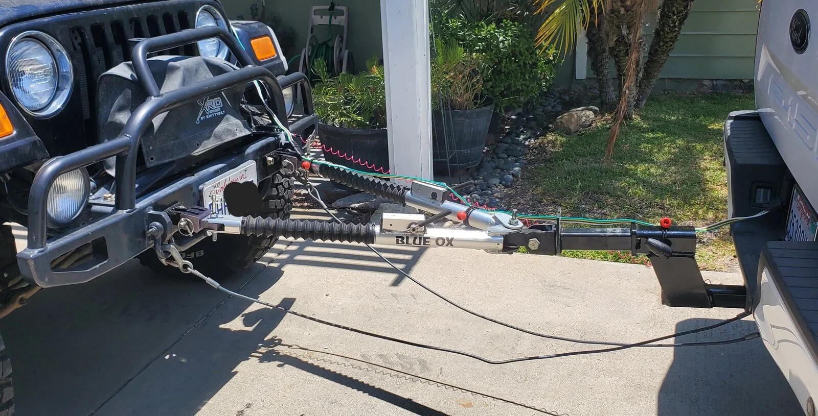

I know this thread is a bit old, but have you towed more with this genright stubby bumper? I have been wanting to get it for my jeep. I am currently using a body armor bumper that I added the blue ox bolt-on tow brackets to. It worked great but the bumper is bulky and I wanted to clean up the front of the jeep.
