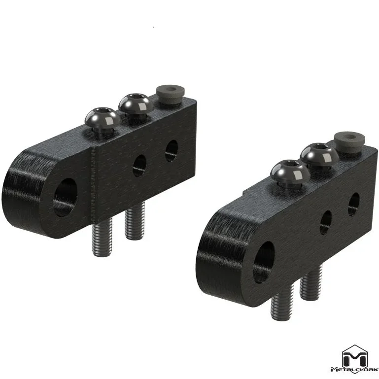

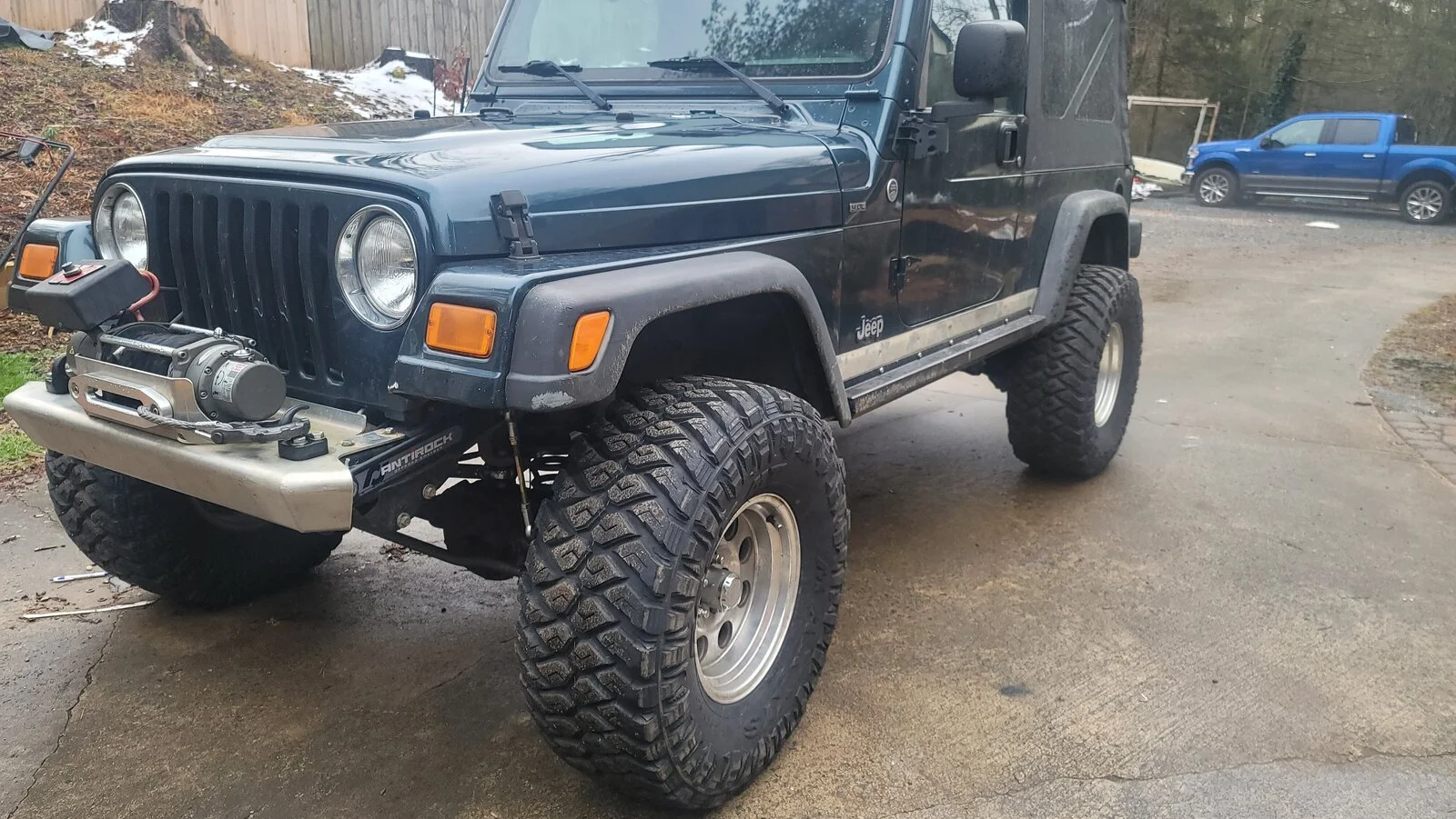

Just picked up a new to me RV and planning on towing my LJ. Problem being the Savvy Bumper doesn't have D ring mounts to hook up to and I really don't want all that crap under the bumper or have to switch away from it. Only thing I've found that would mount on top of the bumper is made from aluminum by Metalcloak and they state not for flat towing. Nothing made from steel and I haven't been able to find anything made from steel available.
Anyone have any thoughts? Know where I can get any of these that I could hook my flat tow to?

Yep, aware of this one but looking to mount on top of bumper and not on bottom to reduce the chance of damaging the tow equipment.

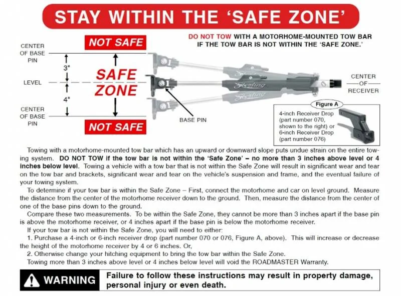

Ok, but unless your RV tow hitch is 3 feet off the ground, you want your tow bar as flat as possible. That's why most kits are designed to mount below the bumper.

Looks like this is the only option for a top mount. Was hoping someone's Google foo was better than mine and had an easy premade one ready to go, but might be stuck with custom mount or going on the bottom with Rock Jock part.
