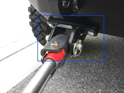

I want a bumper that I can flat tow with and Rock Hard offers bolt-on tow bar brackets for a variety of bars (see photo below). In looking at other threads, I understand that many are towing off the D-rings on a variety of other bumpers, but the manufacturers typically will not indicate they are OK for towing like Rock Hard does. (Not that it matters.)

I think the D-rings are double welded and should be good to go, but I will probably order the add-on Rock Hard tow bar brackets that bolt-on. It looks like they mount low on the bumper so that should make leveling easier.

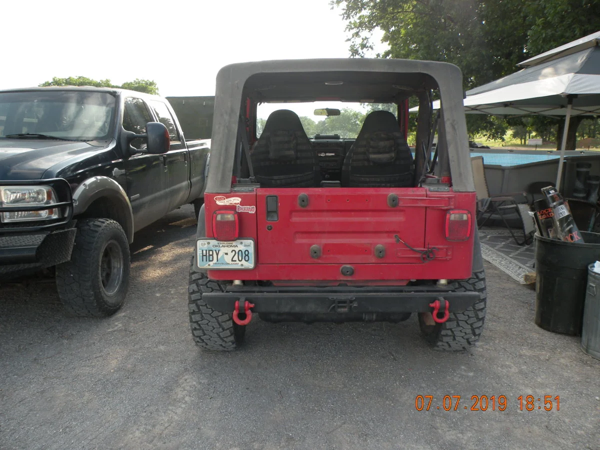

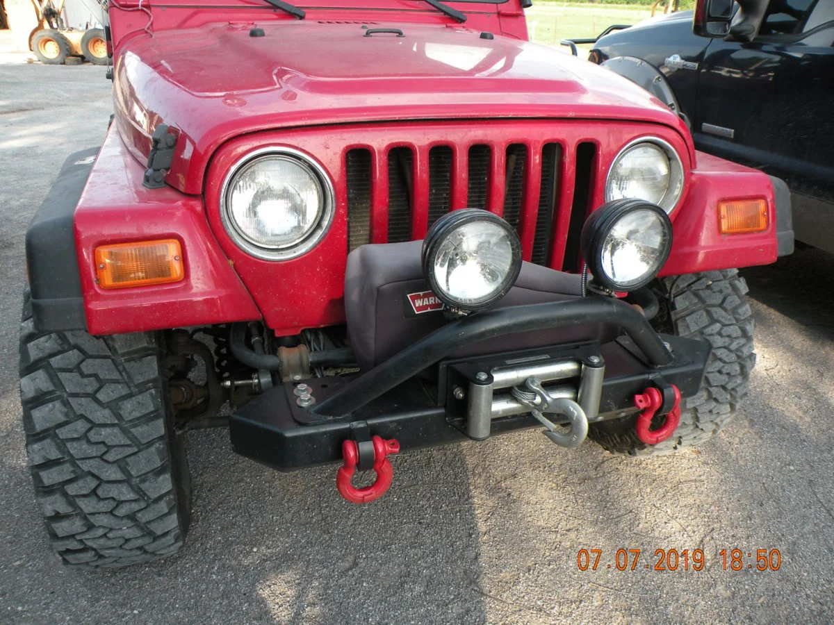

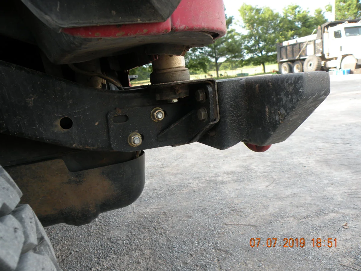

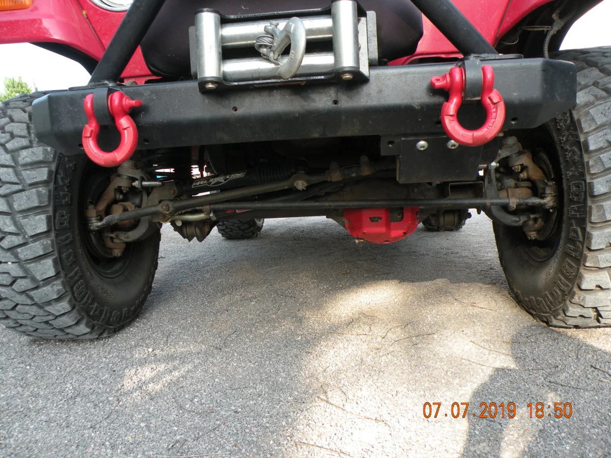

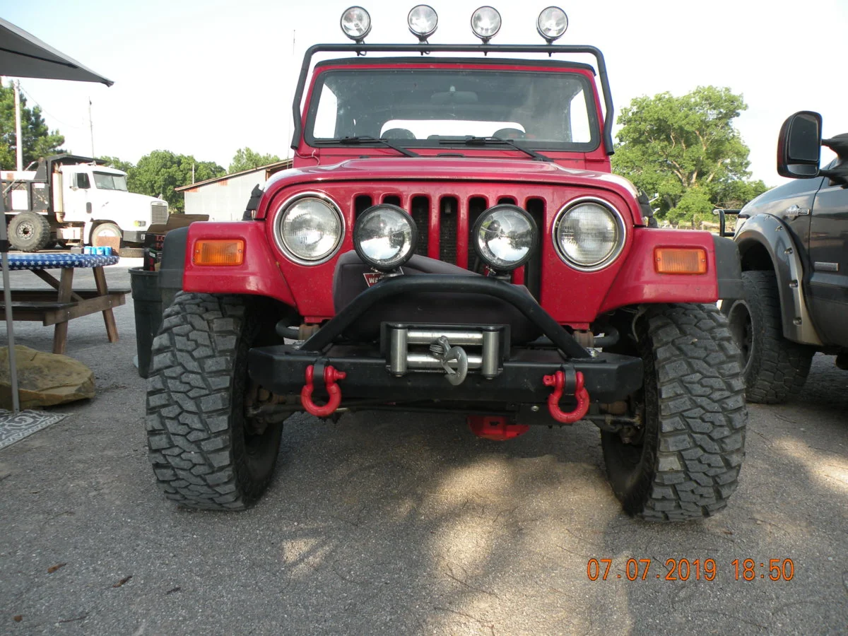

Rockhard is in Nebraska, nice people just call them. I bought mine from CSE in New York on eBay. I do have the short hoop for 2 KC and the power steering box guard. Let me go take some pictures.

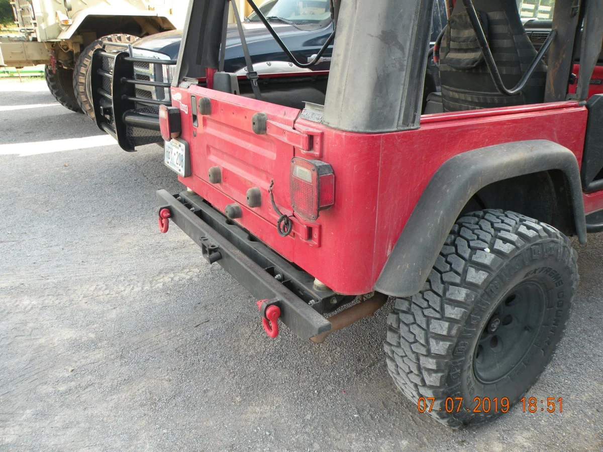

Rockhard will sell directly to you. I have their rear bumper as well, with frame tie ins. The rear has twice as many bolts holding it on as stock, plus the frame tie brackets. It's heavy, and has extra bolt hole positions for covering up a 1" BL, which I haven't done yet.
