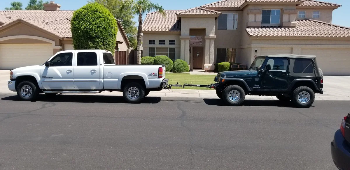

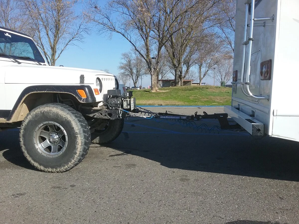

This is a Smittybilt XRC bumper with a Roadmaster towbar. The bumper eyelets are double welded, front and back.

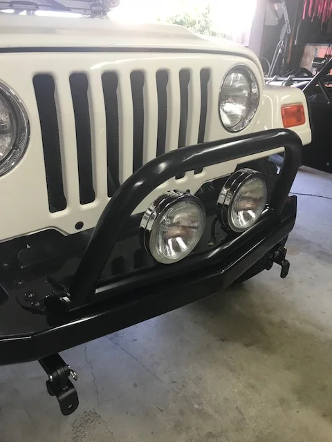

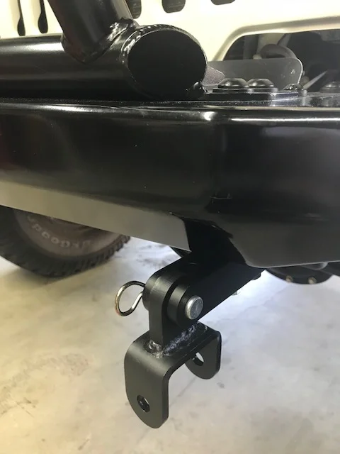

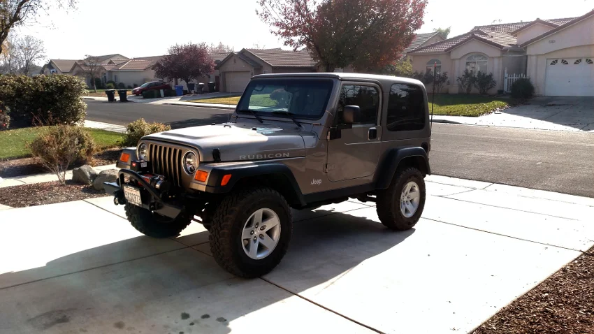

I had a local shop fabricate attachment points for my factory bumper that bolt thru the bumper and frame. I also wanted to avoid losing clearance and keep the jeep light via retaining the factory bumper.
My tow bar is a blue ox. Not sure which model, but the shop made the tow points based on the tow bar.

I like this idea! And clean d-max

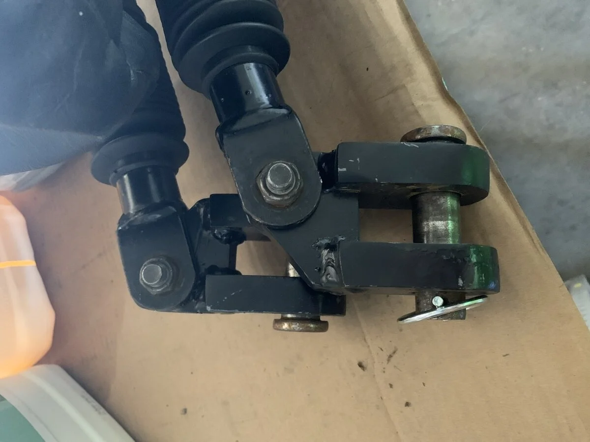

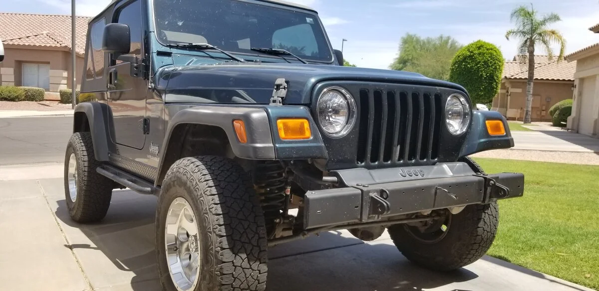

Following up. Blue Ox makes a “slip over” clevis style attachment point and the adapter brackets to fit their tow bar. To buy these would have been close to $800.
My friend has a large CNC plasma and we had him cut out the 3/4” material. We bent 5/16 X 4” material to slip over the stock bumper (like guns and religion, I bitterly cling to my stock front bumper😂)
I now have solid recovery points for a clevis also.

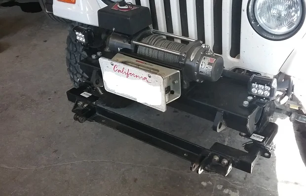

I do toastmaster latest version brackets without the crossbar with Arb front bumper
I just have to take the two knuckles out and I’m done
The Currie brackets will work with a stock bumper.
I like this option for my OEM bumper, but where do you hook the safety chains with this setup?
Edit: Nevermind, I see it now - they're attached to the Currie tow bar in this setup. I've been looking at the other style of tow bars where the safety chains aren't connected to the bars, but go from the tow vehicle to the Jeep.
