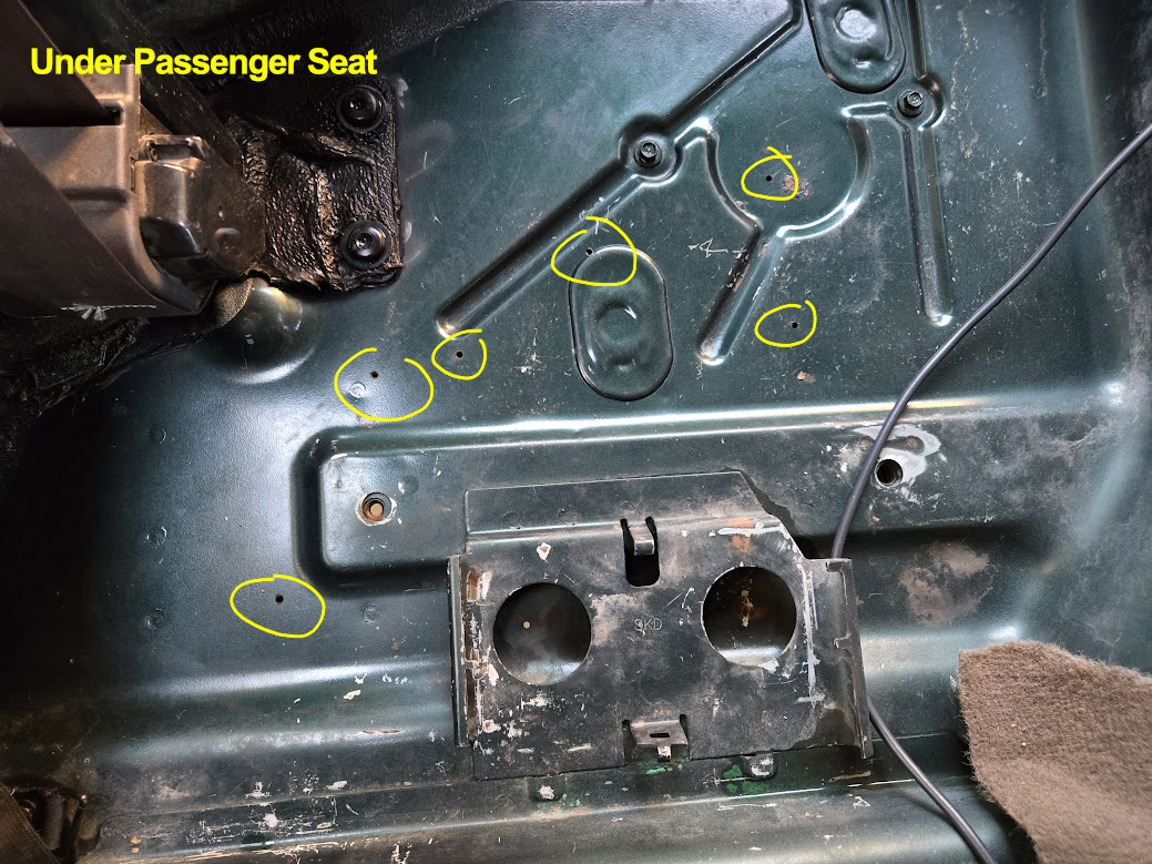

Here is an example. I'm thinking these holes might have been drilled as drain holes while the tub was sitting outside so it didn't fill up with rain water.
Those are not factory holes. They should have just pulled the metal plugs to let water out while sitting outside. You could've then replaced with rubber plugs.
Ok thanks, i'm not even sure if they are drain holes now as they are pretty small. In either case i'll weld them closed and paint over the whole thing to clean it up. Do you know why there is a difference in drain holes between my old tub and this one? My old tub was a Sahara and this replacement was off a sport model. Not sure if that makes a difference?
