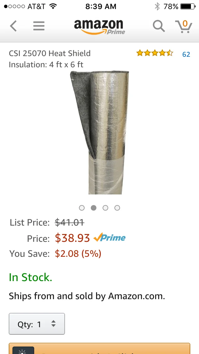

I was up early this morning so I figured that I would start this project. This is the product that I ordered.

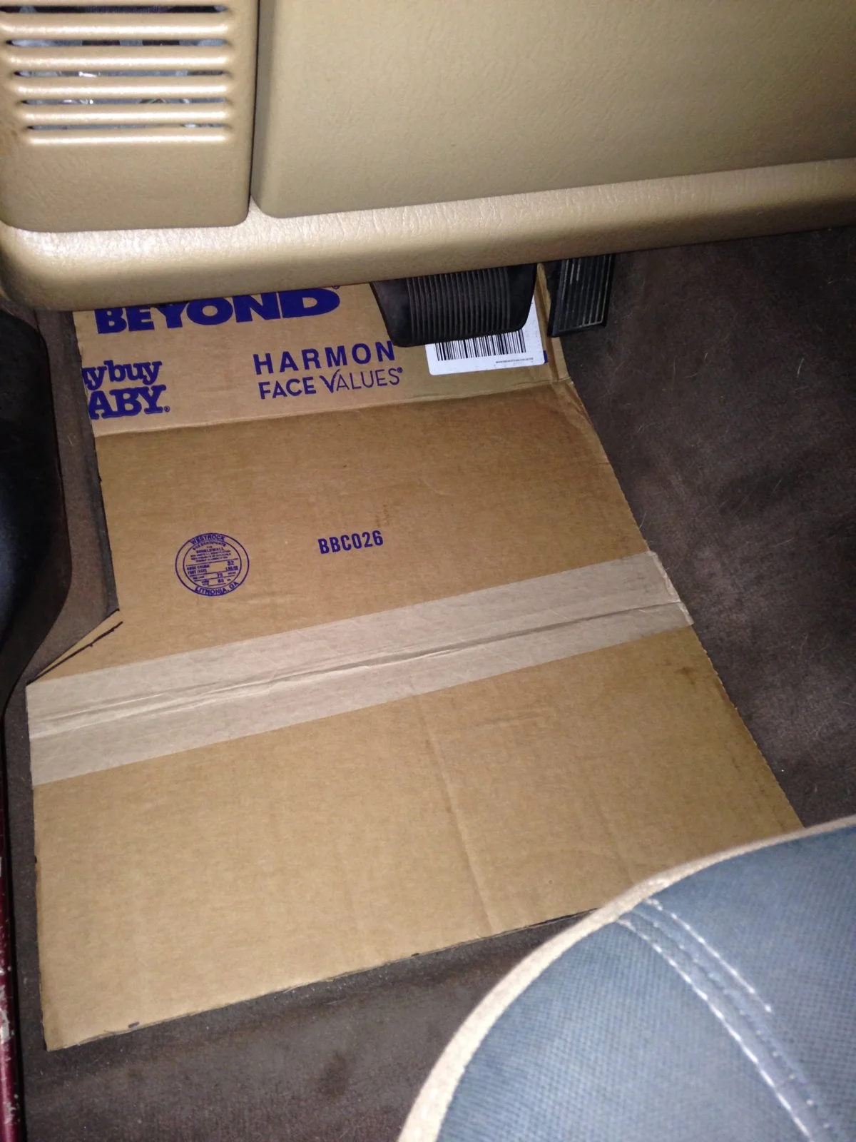

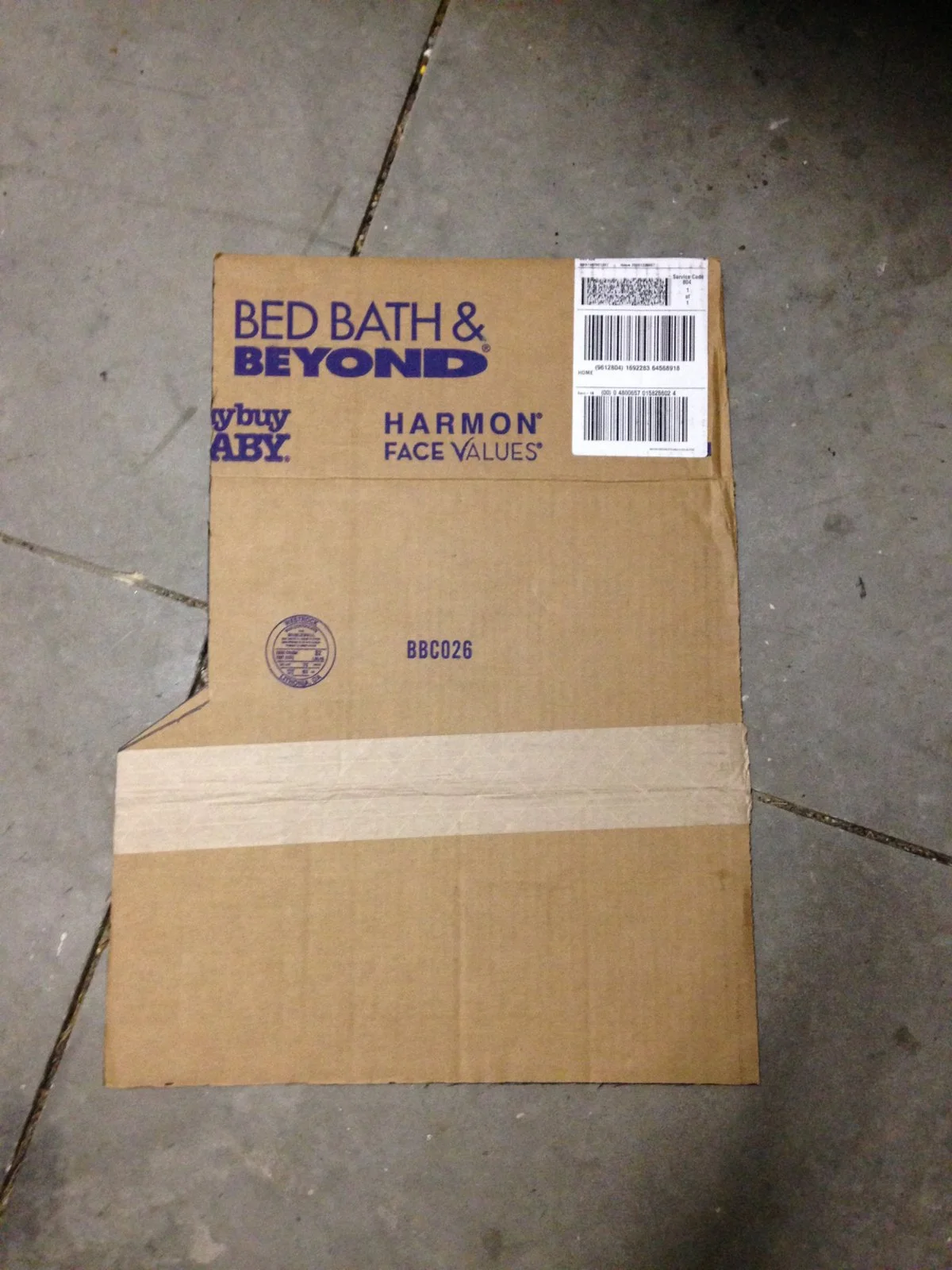

I made a template for the drivers side floor:
It fit pretty well the first time.
Now I just need to cut the material to match. I'll pull the carpet and secure it down, then just put the carpet back.
