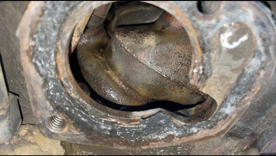

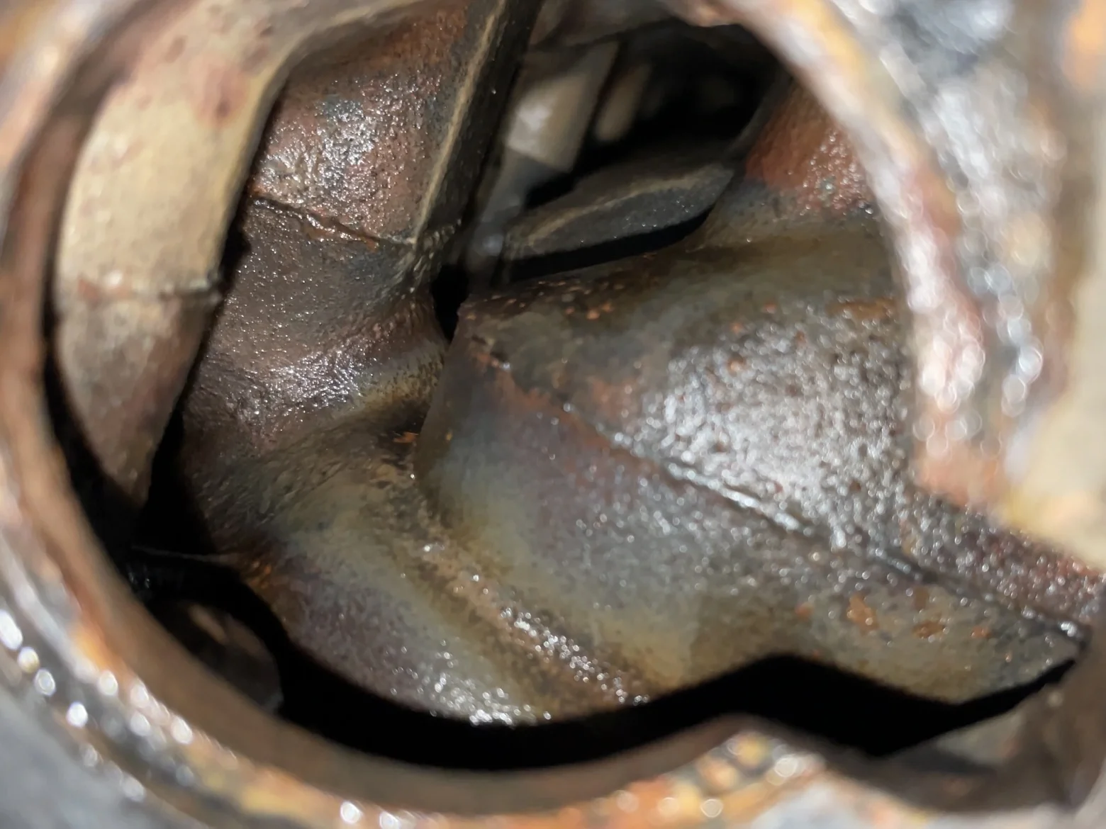

Been slowly working on getting my cooling system flushed out for the past week. Drained the BlueDevil cleaner I had in there for the past 3 days (was only able to get about 1½ hrs of run-time with it). Pulled the tstat today to have a look at the block and it’s certainly not as clean as I was hoping.
Does it look bad enough that it warrants a Thermocure flush or would another round of regular cleaner with proper drive time do the trick?

I don't recommend the Prestone stuff. I recommend that you use a drive around flush like the Prestone and check it after that to see if it is clean.

So in your experience would you expect that I’ll need a Thermocure flush or would you guess that a proper drive around flush will do it?
If you’d expect I’ll need Thermocure I’ll probably order some right aways.

I only know how to find out. Do the drive around flush and see what it does.

Ran the Prestone cleaner from Sat-Mon, got some decent drive-time in and unfortunately doesn’t look really any better so I am gonna need a Thermocure flush.
As I mentioned previously freeze-up is coming sooner than I can get Thermocure as I have to order from Summit. So looks like I’m gonna have to just do a good rinse, dump coolant in and wait till spring to continue.
Come that time I’m thinking I’d be fine just to filter the coolant through a coffee filter when I drain it and then re-use it after I’m done with the Thermocure, ya?
