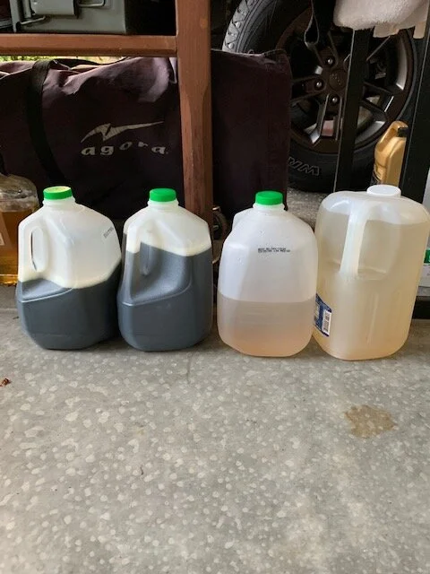

Water will NOT get the years of crap out of your cooling system when flushing it.
Thermocure works.
Jugs on the right were after a Prestone flush, and the jugs on the left were after a Themocure flush. I did the Prestone flush first, then Thermocure.

Thermocure works.
I have always used the Prestone flush, and the results look like the jugs on the right.
Tell me more about this Thermocure. I have never heard of it before. What does it do that the Prestone doesn't?
Why is the liquid inside the jugs on the left from the Thermocure so DARK?
Thermocure is explained well on the Evapo-rust website and there are some good youtube videos on it too.
