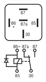

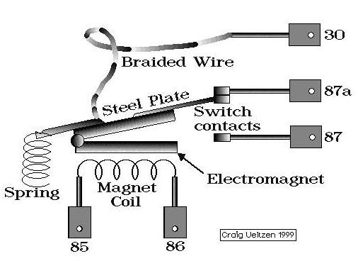

Essentially it's correct with a bad narrative. Reversing the wiring won't cause that problem but moving one of the contact wires below the relay socket to the other contact side of the relay will cause that.
If one of the wires was moved from the N/O (normally open) connection to the N/C connection (normally closed) that would cause the fog light to be on until the fog lights were turned on by their switch which would shut them off.
This is essentially what the fog light relay looks like inside...

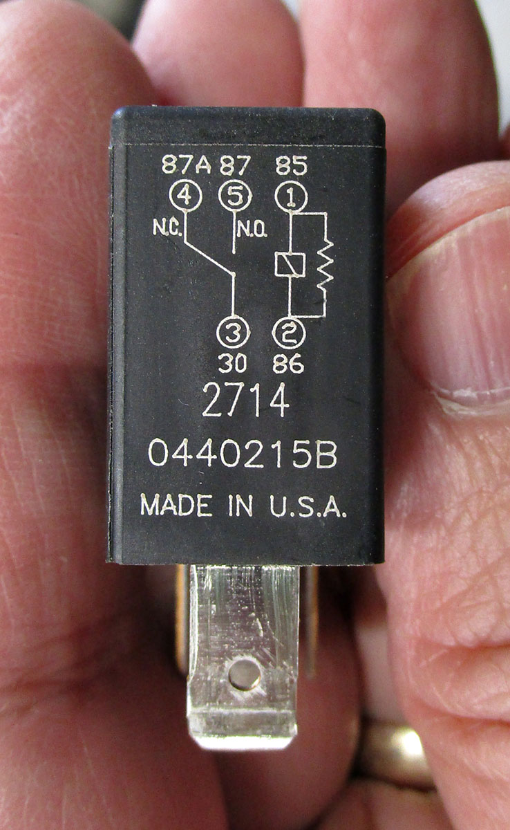

@Chris will ChatGPT look at a person's profile to determine year, tranny, etc?
@LJDC are you using the original relays? I've seen a few with different pinouts, which could switch the NO and NC contacts, as @Jerry Bransford showed.
If it fits the socket inside the PDC it has a standard Bosch pin layout so that wouldn't happen by installing a different relay.

This is the Bosch pin layout and how it looks from underneath...

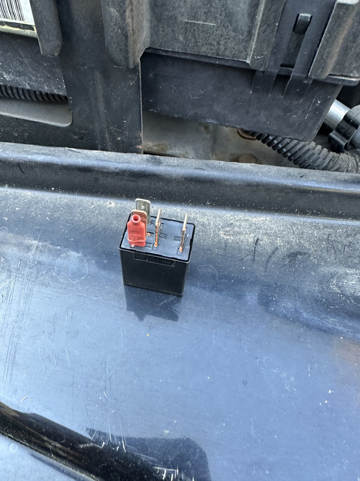

Hmmm…. that’s not what my relay looks like. Not that it matters, but the pins are numbered 1-5. I can’t take another photo right this second, but here it is when I was messing with the pins—the red shrink tubing is no longer there, and that’s not the receptacle that I can’t see:
