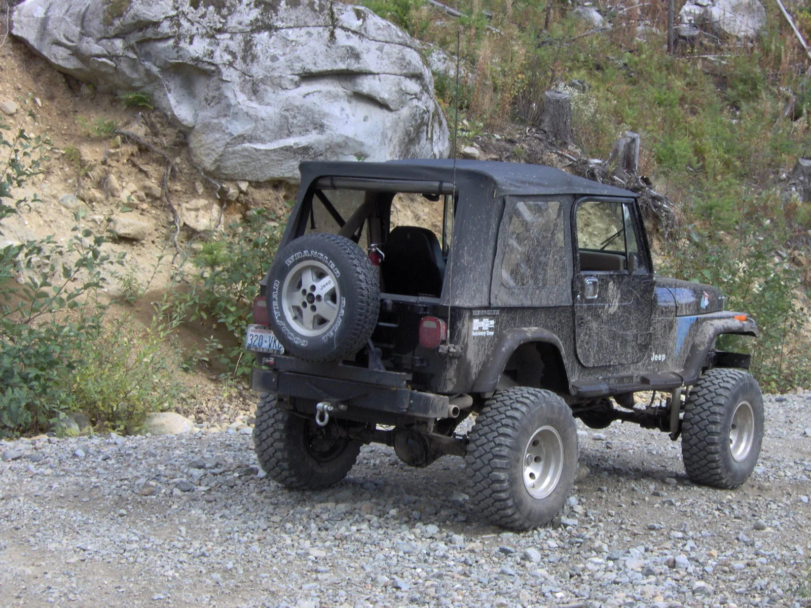

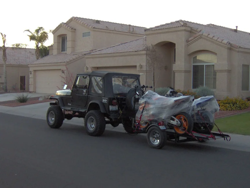

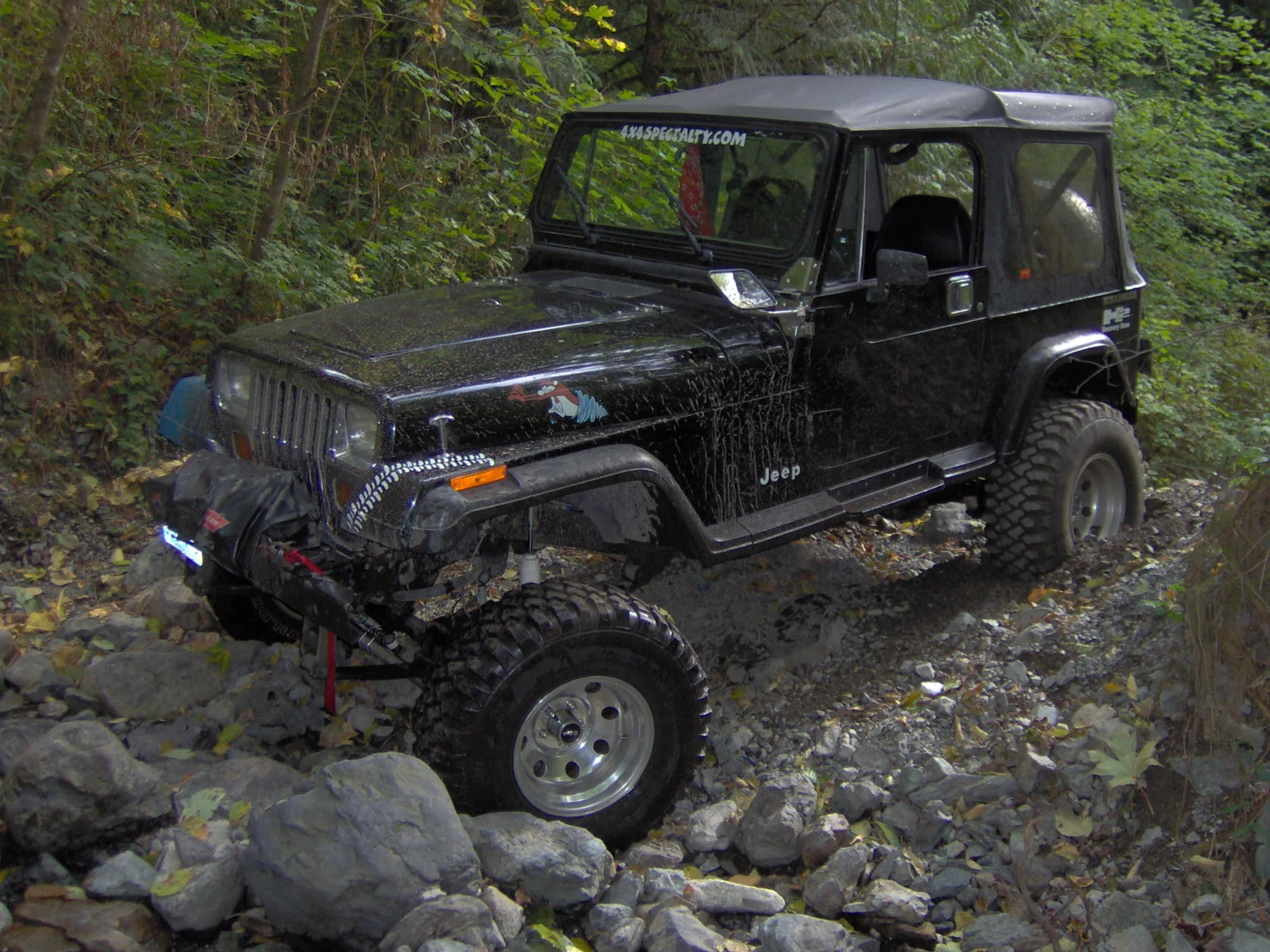

Here is a couple of pictures of mine with the 8.8:
77765
77766
77767
